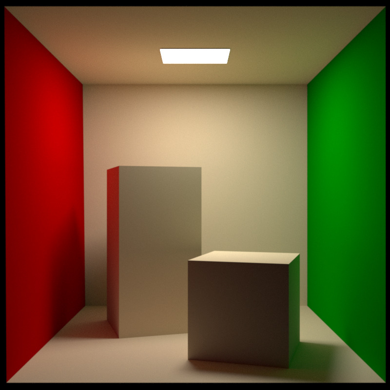

This is the PNG (gamma 2.2):

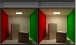

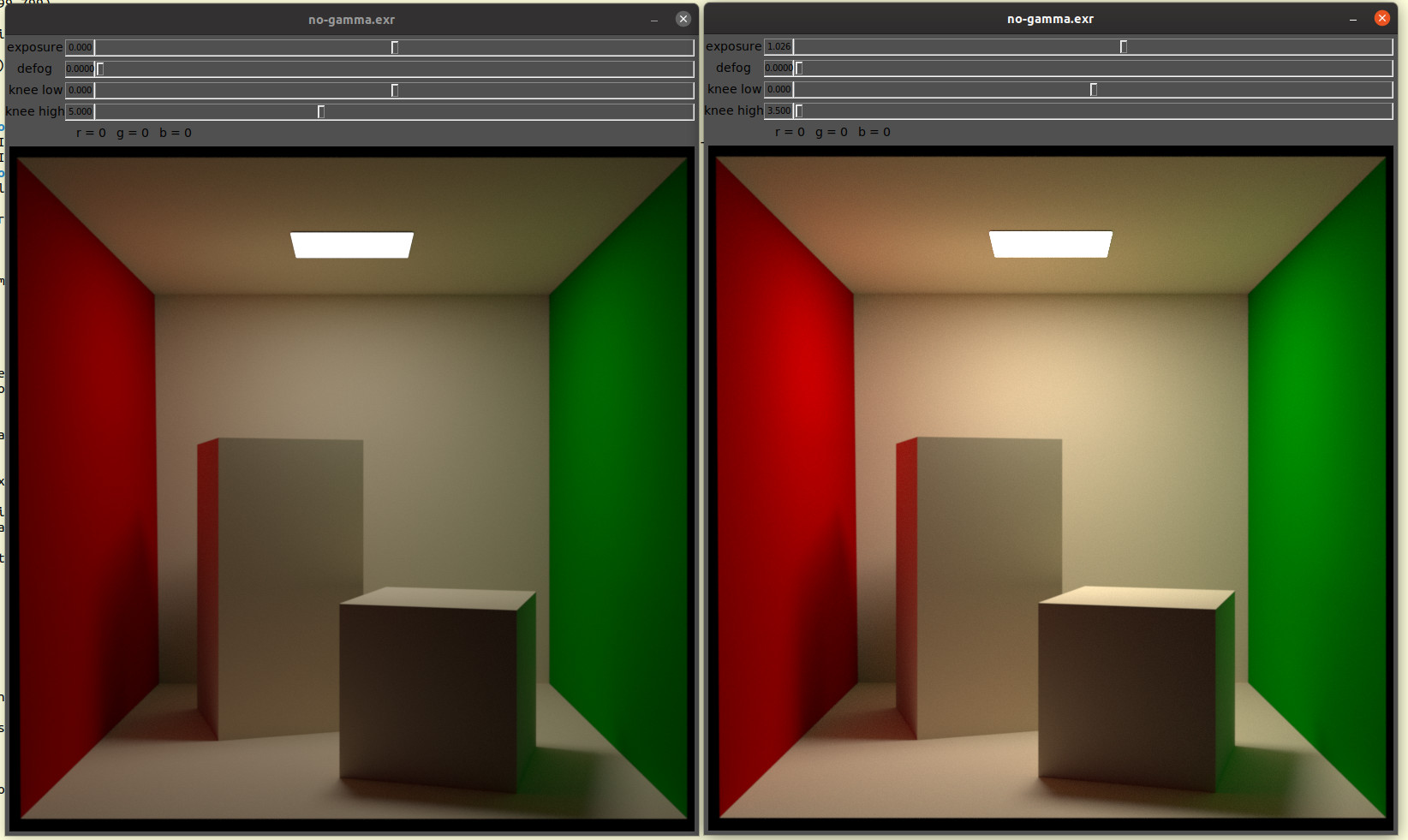

This is the same .exr (gamma 1.0) file loaded with exrdisplay (the ILM's tool to display EXR files, ILM originally created the file format) and different parameters:
For the second exrdisplay (the one looking like the PNG) I used the "-1" option:

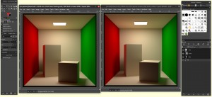

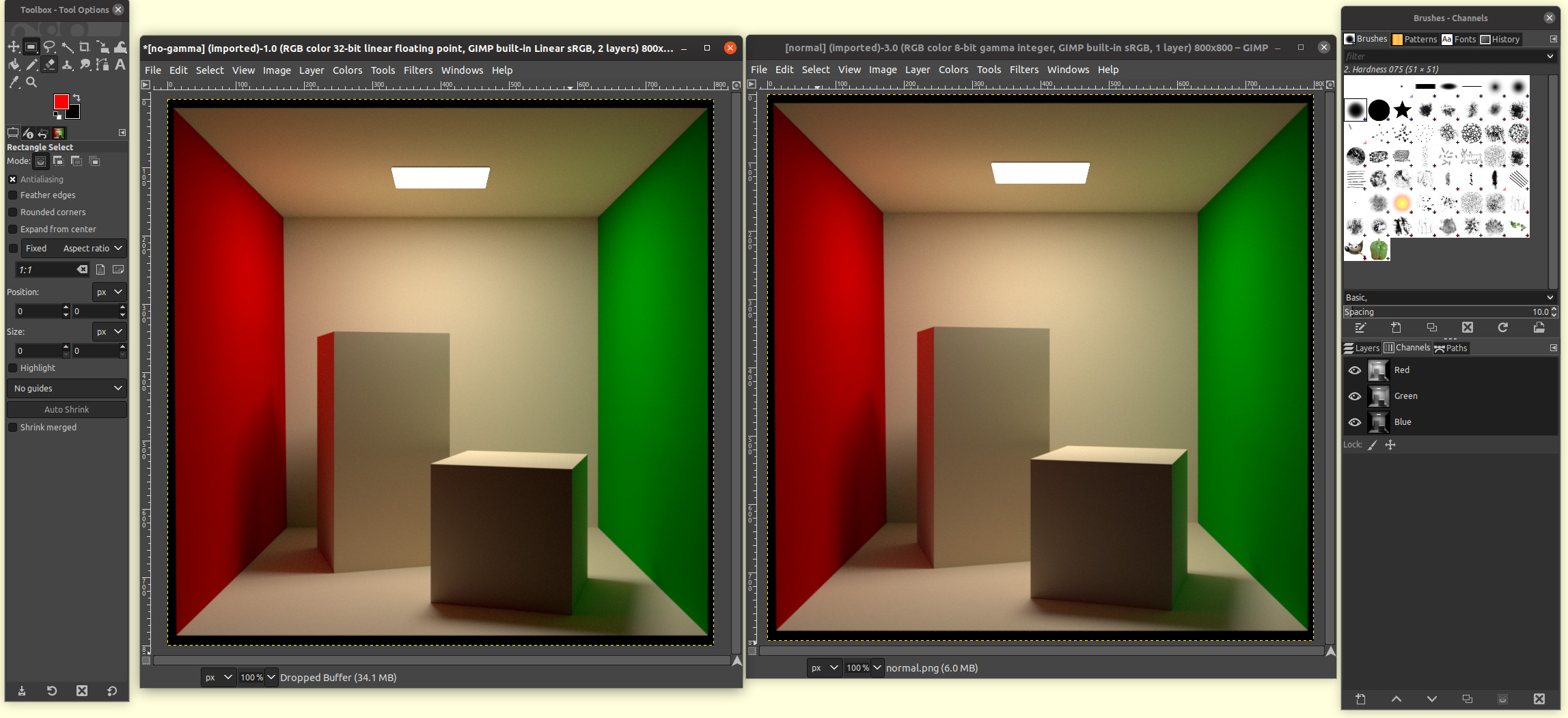

This is the PNG and the EXR, side by side in GIMP v2.10.20:
Your GIMP is old or has not the default settings or something else.

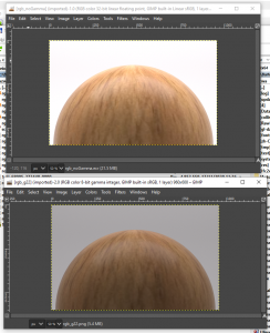

3. In my opinion png with gamma 2.2 (file rbg_g22.png) should be identical to exr with gamma 1.0 (file: rgb_noGamma.exr) but hey are not:

I used the "-1" exrdisplay option:
-1        sets exposure and knee sliders so that pixel
          value 0.0 becomes black, and 1.0 becomes white

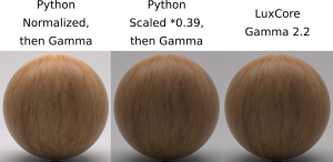

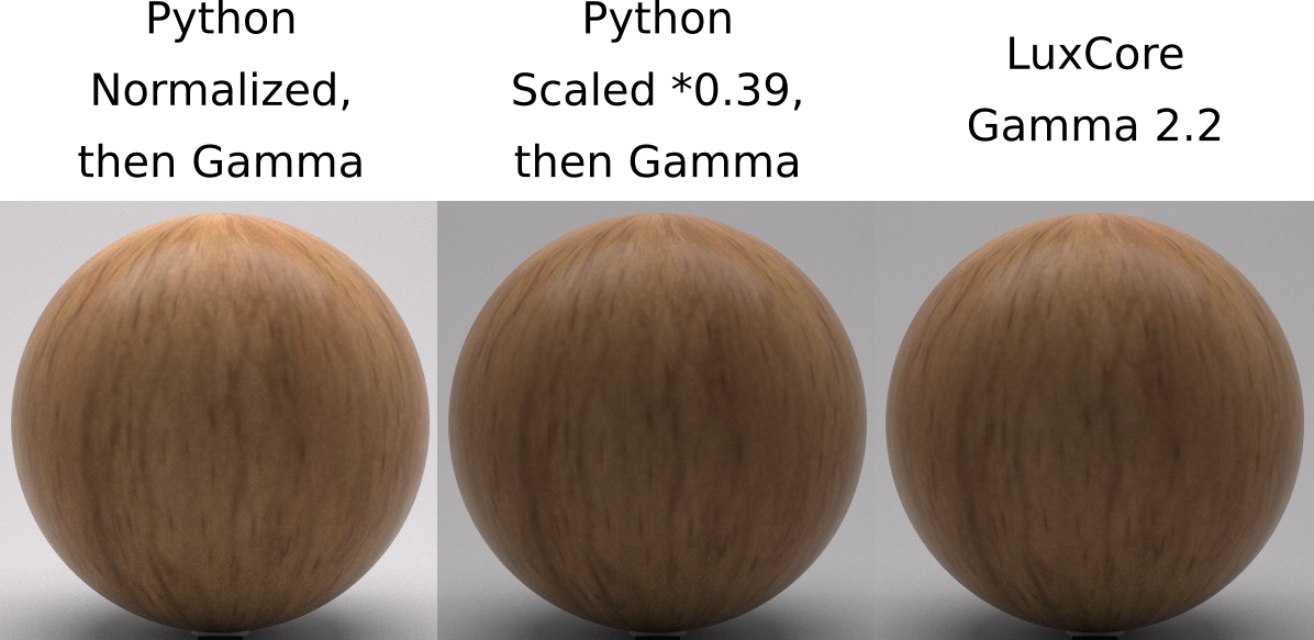

To demonstrate the impact, I used the "rgb_noGamma.exr" from your scene and processed it in python in two ways to compare with the LuxCore:
First, I normalized the EXR, then applied gamma. Second, I scaled the image by a factor 0.39 as explained above, then applied gamma.
here is the result compared to the direct output from LuxCore:
P.S.: If you're wondering why I use python, that's because I'm used to it and I have good control over the math happening there.
EDIT: This also means I was wrong in my earlier post that LuxCore operates on the normalized image. I assumed that from a quick anaylsis of the first images you posted...
