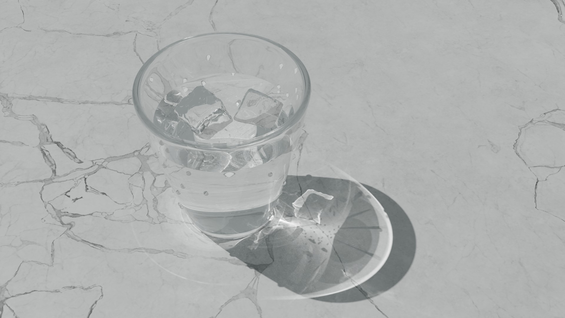

Skilled420 wrote: Wed Nov 04, 2020 4:12 pm How would I create something that looks like this:Image
I would try a mix with rough glass, maybe driven by a texture for the mix amount.

I rendered your scene with path + light tracing + caustics cache by the way, which is able to show SDS paths like the caustics mirrored in the side of the glass:
