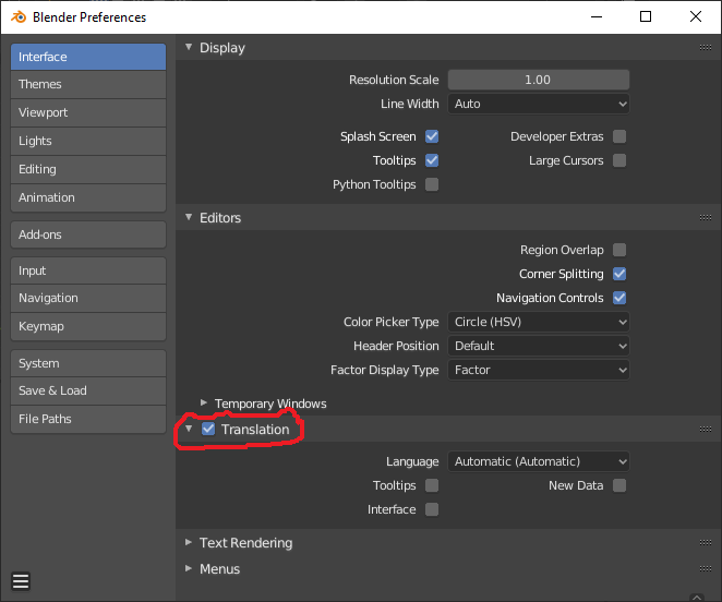

acasta69 wrote: Tue Sep 08, 2020 8:47 am The problem is also present when using Blender 2.83.5, while exporting with Blender 2.82 seems to solve it (same identical BlendLuxCore version in all Blender versions).
One more piece of info, hoping it helps finding a workaround.
The Interface-->Translation preference was slightly different in Blender 2.82: it was disabled by default (and was disabled in my previous test).
Enabling it as in the attached picture produces the same exact behaviour as the more recent Blender versions, no matter if language is set to "Automatic" or "English".
In the latest versions this setting is gone, translation is always enabled.
