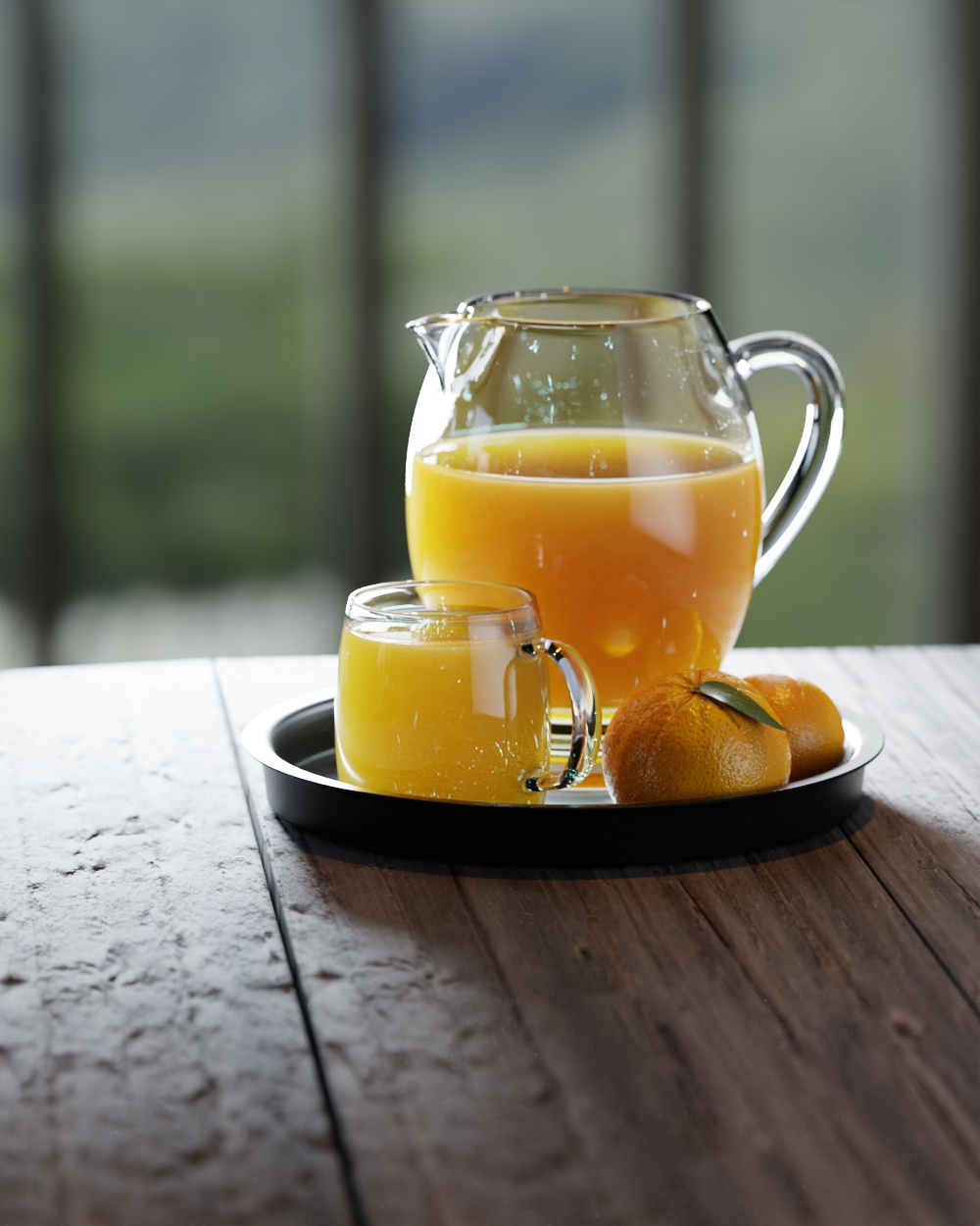

The orange juice scene is now broken (it uses white shadow color for the glass).
I think, especially since we're in beta phase, we should revert the changes to the shadow color feature, and look into the area light topic once v2.4 is released.
reference
reference
broken
broken
Re: Full invisible area light
B.Y.O.B. wrote: Sun Jul 05, 2020 11:44 am The orange juice scene is now broken (it uses white shadow color for the glass).
It looks like you haven't updated your sources, like I wrote, I fixed that problem too.
