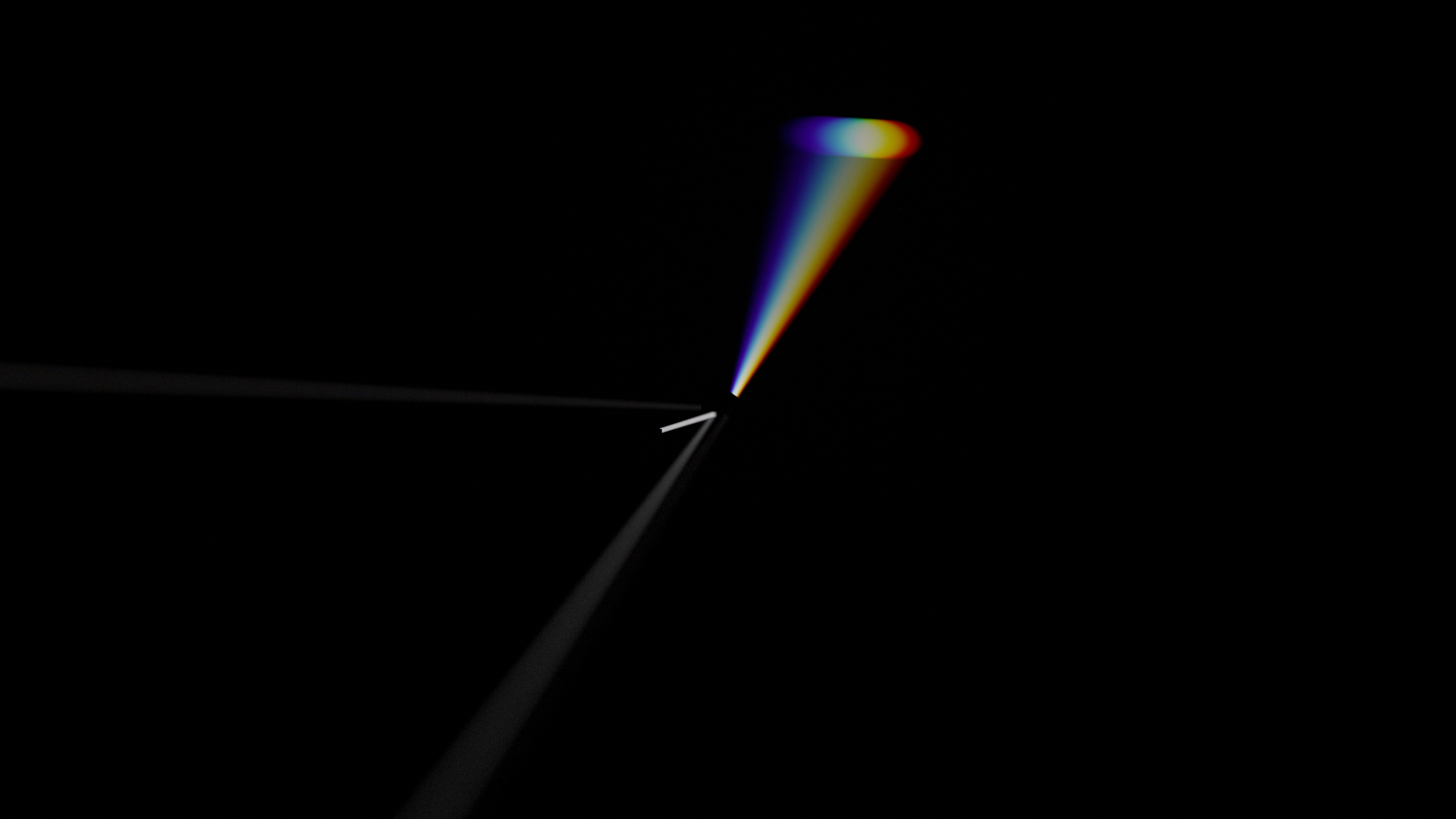

Hello all,
I made a small scene with luxcorerender and everythings seems to work fine:
BR
BR
