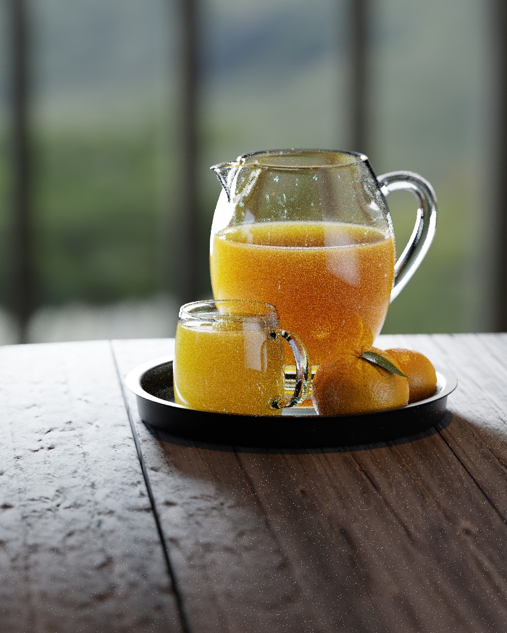

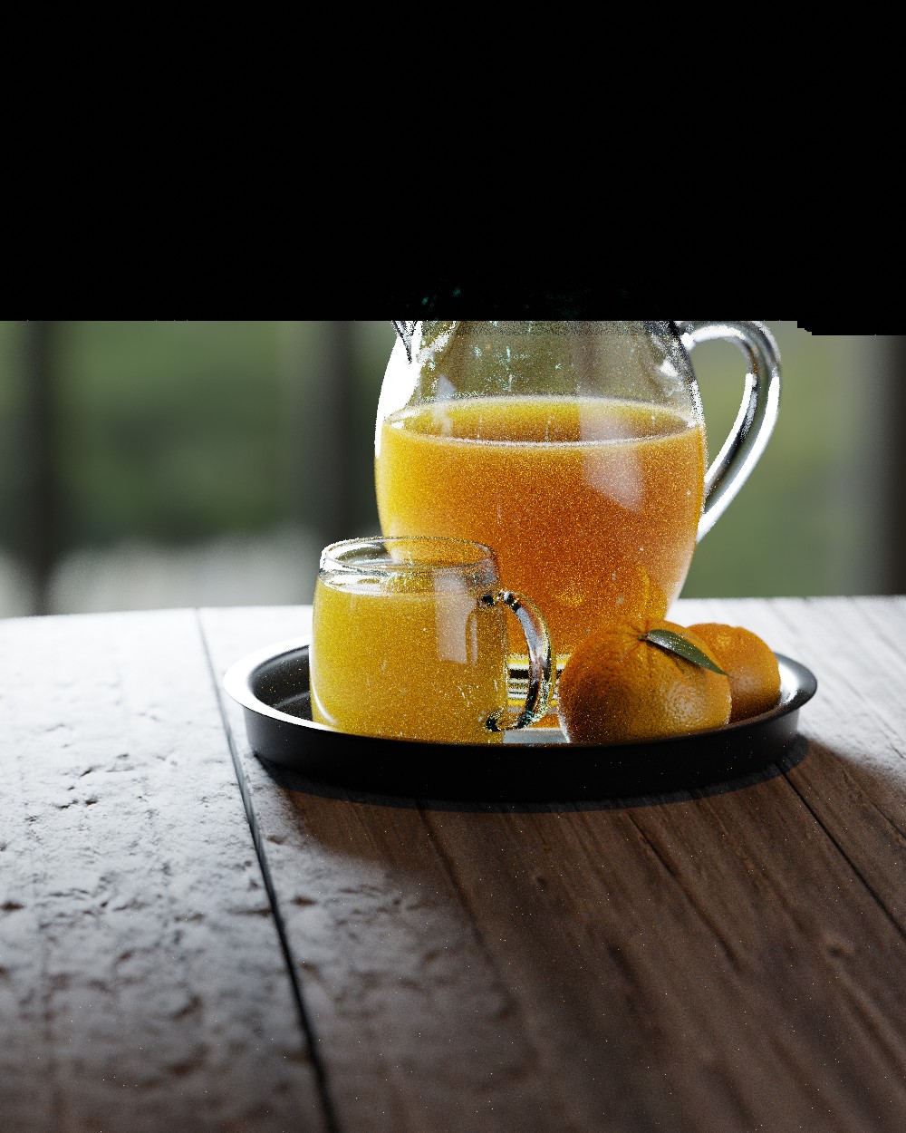

without light tracing, overlap = 32, supersampilng = 16, 512 spp halt condition
with light tracing, overlap = 32, supersampilng = 16, 512 spp halt condition
Re: New Random/Sobol sampler progressive, cache-friendly and OoC modes
Yes, it was discussed in another thread, we probably need an 2 halt conditions, one for eye and one for light samples otherwise you can have some problem when light tracing is enabled.
