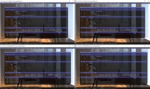

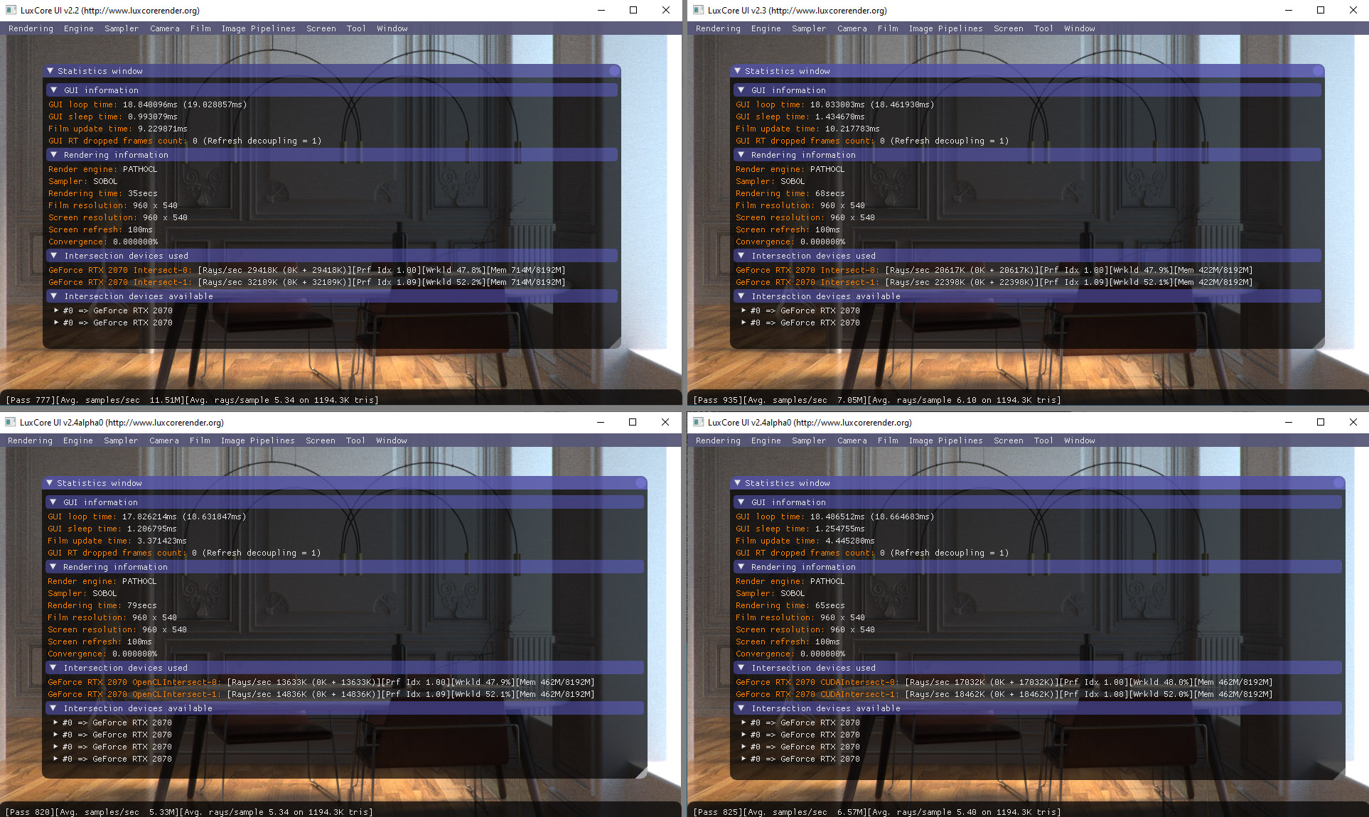

Comparison with v2.2 is even scarier:
Re: v2.3 Vs v2.4 performance
epilectrolytics wrote: Fri May 01, 2020 9:06 am Comparison with v2.2 is even scarier:
this is a lot even between 2.2 and 2.3 there is half performance lost. :?
Posts: 818
Post by epilectrolytics »
Sharlybg wrote: Fri May 01, 2020 9:30 am this is a lot even between 2.2 and 2.3 there is half performance lost. :?
Yep, I'm totally stunned.
Maybe we need Optix RTX support to regain the render speed we already had last year??
And AMD users are kind of screwed right now :(

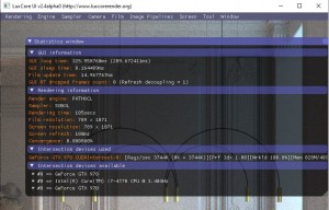

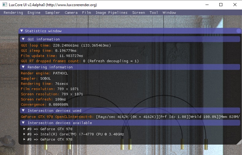

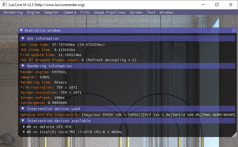

Here are results with GTX970 (2.3 vs. 2.4 build 20200430.12):
On this card CUDA underperforms OpenCL quite a bit... :?
Anyone else with this or similar GPU series can confirm?

A 970 GTX can not be 7 times slower than a 2070 RTX :!:
acasta69
Posts: 472
Post by acasta69 »
Dade wrote: Fri May 01, 2020 1:12 pm A 970 GTX can not be 7 times slower than a 2070 RTX :!:
Indeed! I dont' understand if it can be something broken on my system or not...
I tested both with Azure-built and self-built binaries, results are the same.
