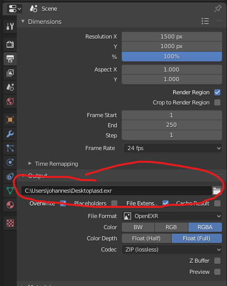

Here is another updated option, which uses the output directory in the scene tab. Lots of code to choose from now :D
Only problem I observe here is that the filename extension you write overrides the file format setting made below. You might want to get the setting consistent and check if it outputs what you expect. I.e., BYOB was right here:
B.Y.O.B. wrote: Mon Apr 06, 2020 8:27 pm ... or use the function Dade mentioned, which accepts a filepath (but you need to know the output type and/or name, I think).

CodeHD wrote: Mon Apr 06, 2020 9:49 pmSure
Woahou it work :D
just need to reupload the file ""exr"" so i get all the color management stuff applied. It just need now an automatic ""EXR"" reload and save as a specified (jpg/png) extension to be user friendly. Sorry if i'm a bit bothering you. just want to include that in the light group tutorial. It make it so usefull and perfect :mrgreen:
