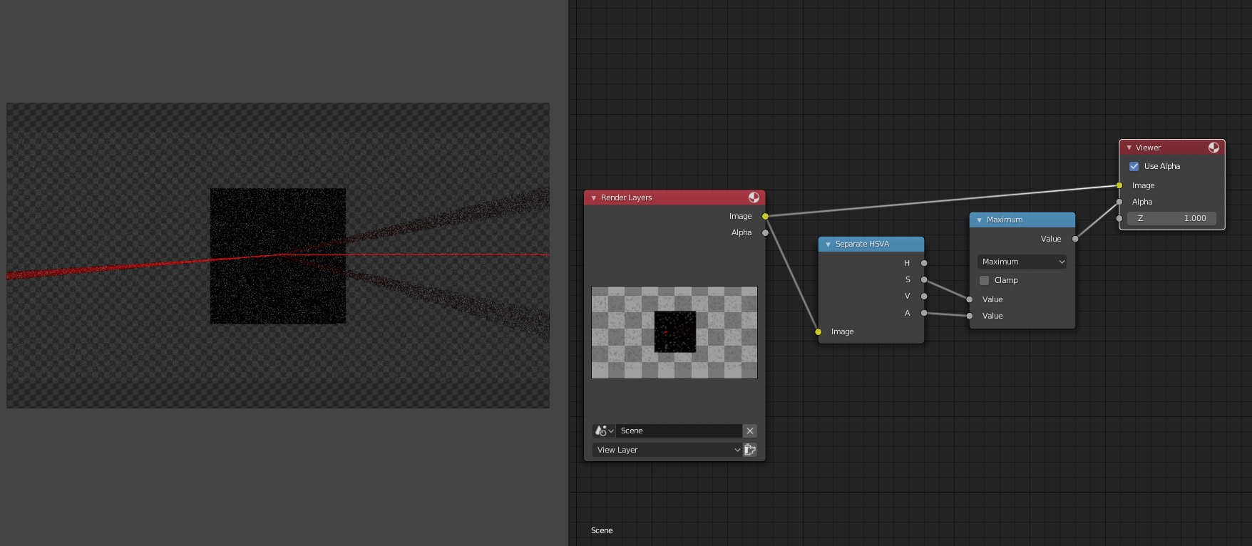

B.Y.O.B. wrote: Wed Mar 04, 2020 6:52 pm Maybe a compositing setup like this would work?
Yes, but no. The test scene I uploaded is too simple, as I also realised from my own test. (When I uploaded it I still assumed a problem somehwere else.) In the actual scene, there is some background light to provide shading for the lens barrel, and hence there is some white volumetric scattering all across the image. I couldn't yet find a good balance with the laser beam.

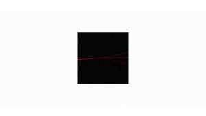

Updated test scene + render, with a distant source to illuminate the rest of the volume, showing a new observation:
In the transparent part of the volume, there are white values >100, while in front of the black object the peak is around 30, and mean much lower. As the homogeneous volume is limited, there should not be values higher than twice the black area, which is about in the middle of the volume.
A reference stripe looking outside the volume at the top and bottom is fine.

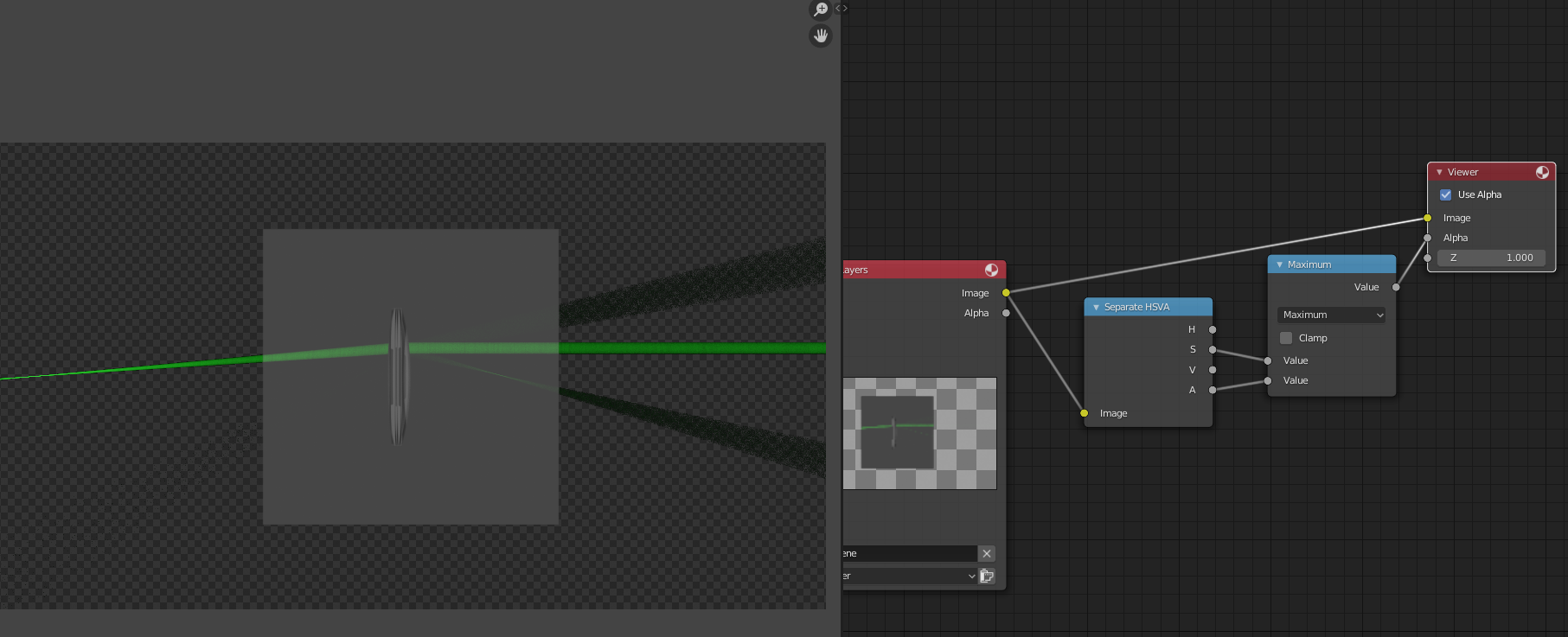

New compositing setup idea:

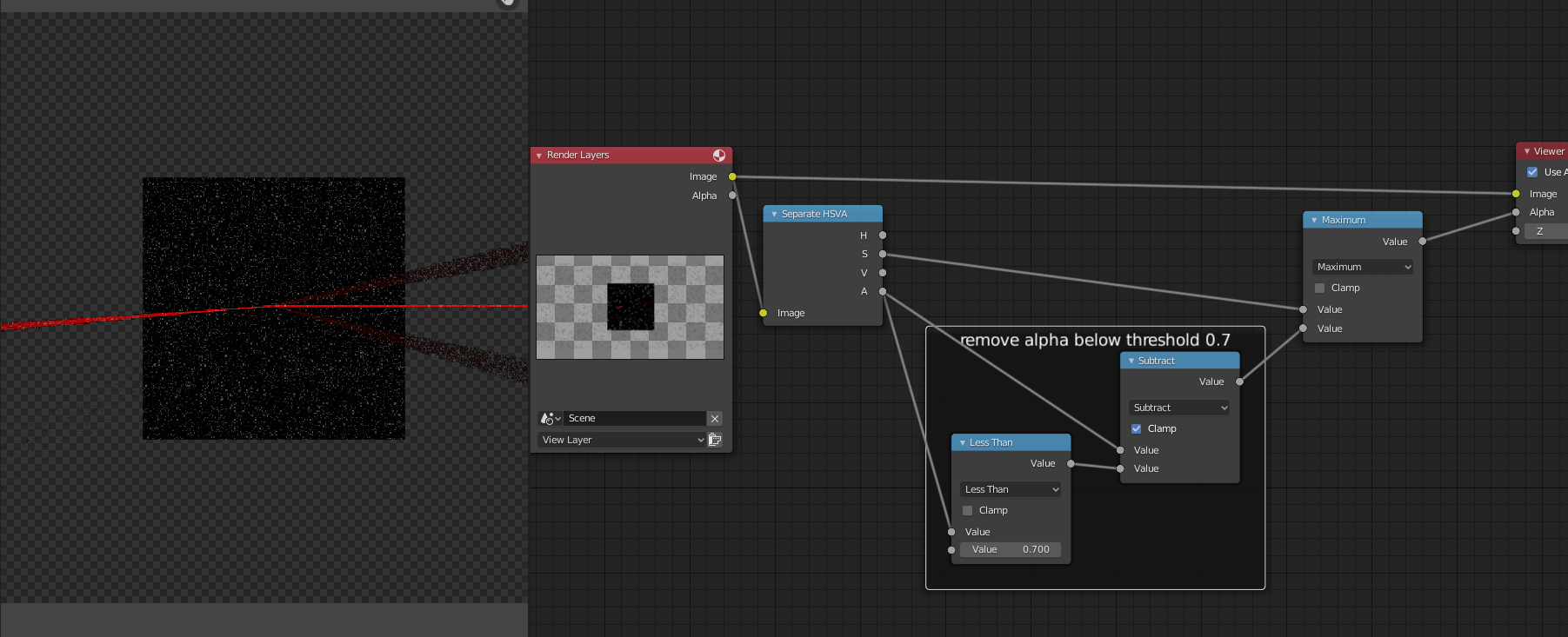

You can also clean out the alpha values below a threshold (from the volume) with a setup like this, although this will hurt anti-aliasing a bit:
