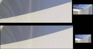

First impressions are very positive, complex areas clean up way faster.

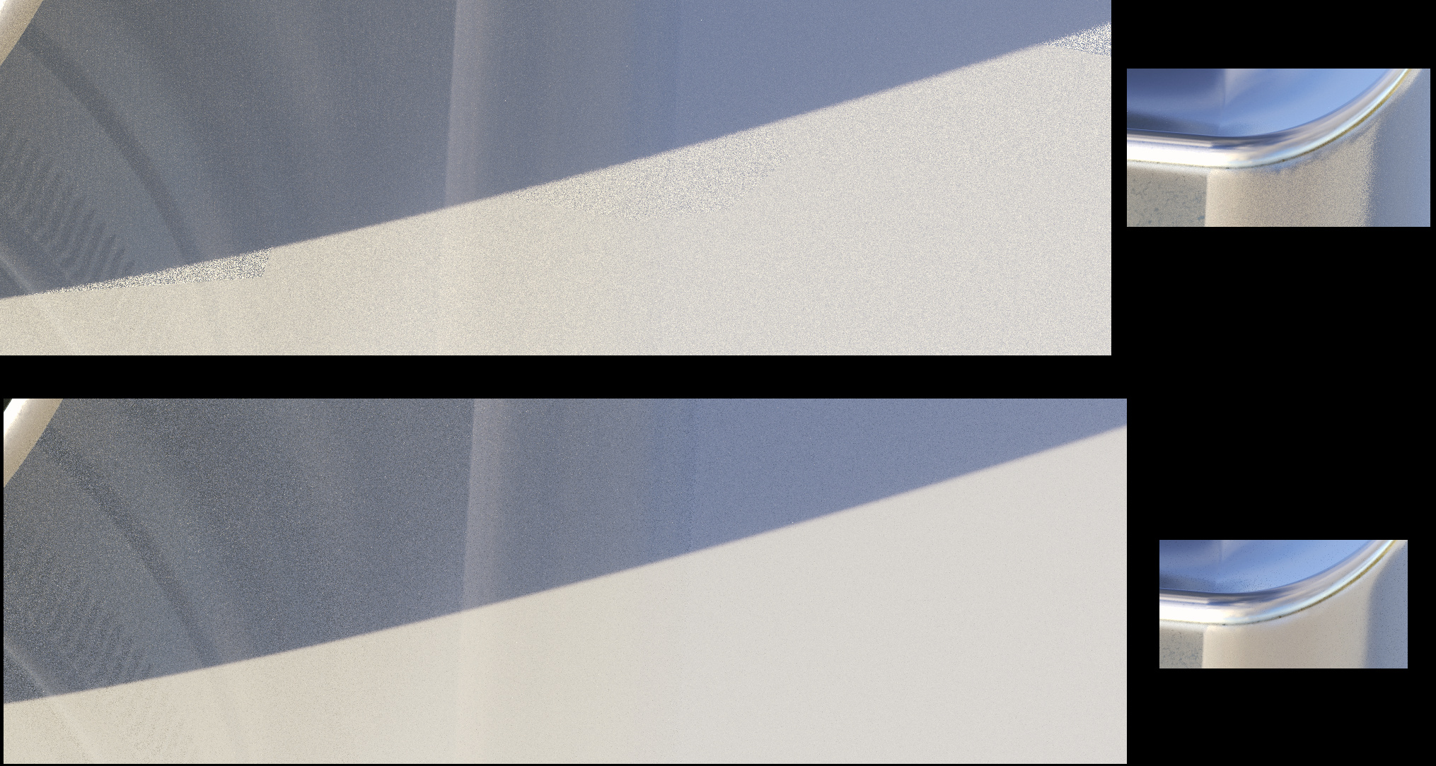

Here seems to be one issue, maybe it's bad settings, or too low samples (150 spp).
EnvLightVisibilityCache map size: 16384x8192
EnvLightVisibilityCache tile size: 64x32
EnvLightVisibilityCache tiles count: 256x256
EnvLightVisibilityCache samples per tile: 16
EnvLightVisibilityCache best cache radius: 0.0154375
SceneVisibility hit rate: 99.4593%
SceneVisibility total entries: 4205
EnvLightVisibilityCache building tile maps: 65536 (256 x 256)
Re: 2-Levels Env. Light Visibility Cache
It is a really large HDR (16384x8192). Try to to double the tile size and the and to 4x the sample count (so it will require the same pre-processing time).
Anyway the artifacts should go away on the long run.

Looks like the artifacts really go away after more samples.
