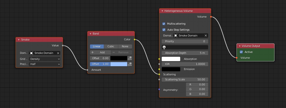

problem is band node, either use color math or leave the band sliders at default values and instead change absorption depth value.
Re: Smoke and volume
I guess the fundamental problem is that you are reaching the limits of floating point precision by using a band from 0 to 0.02.

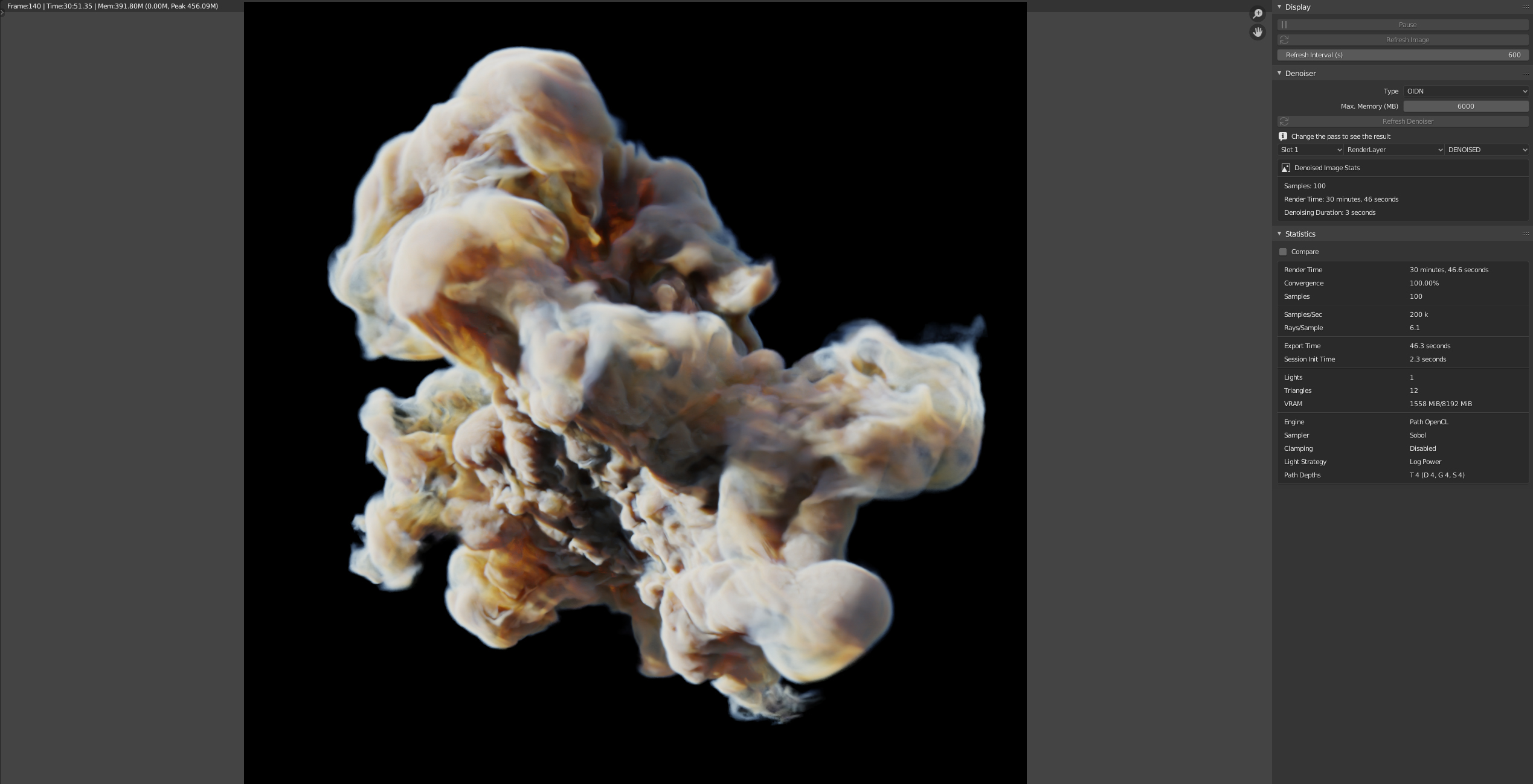

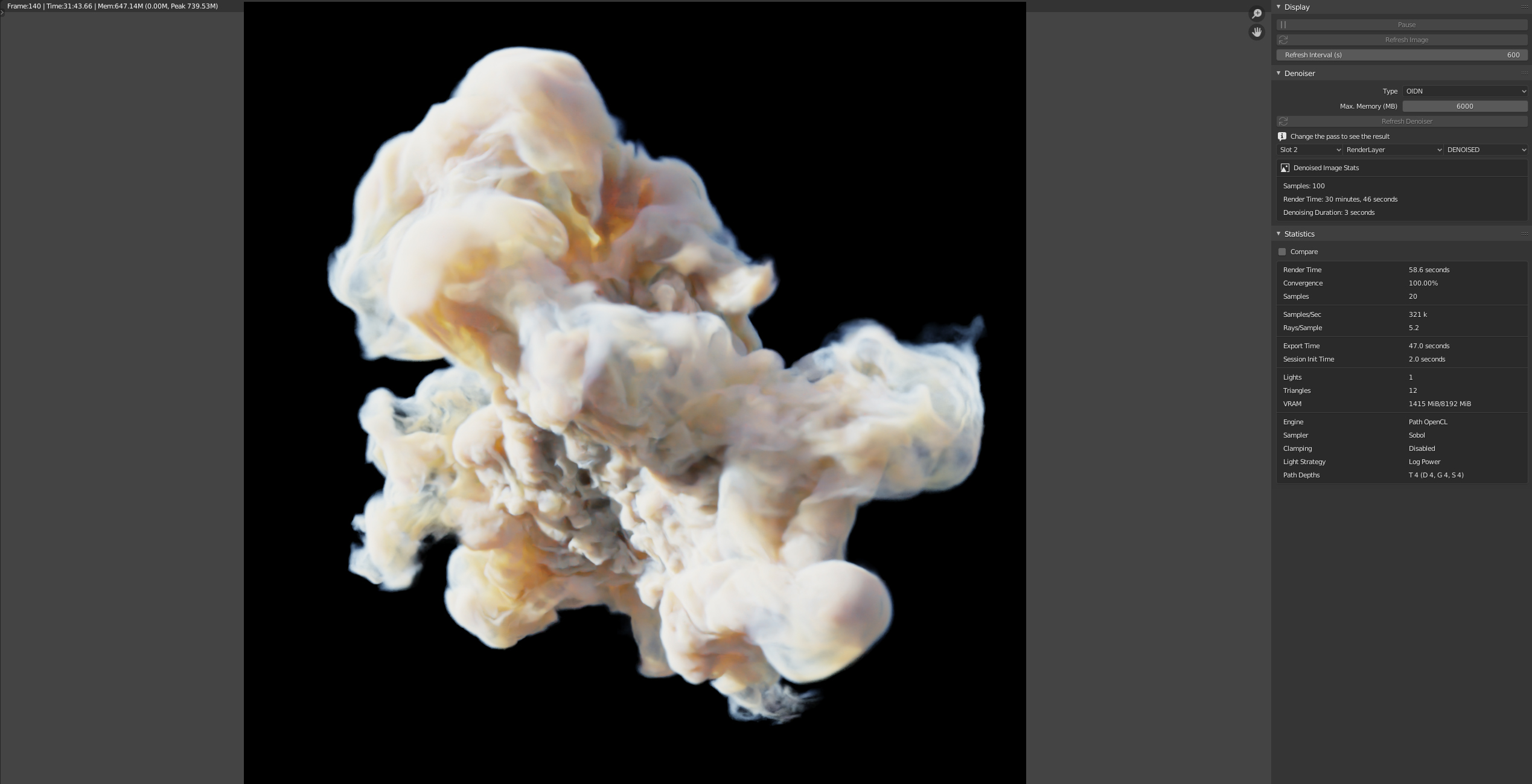

I'm quite happy of these result, I prefer the first one. Both are denoised with OIDN.
Heterogeneous Volume
Heterogeneous Volume with Multiscattering (render time is 31:46, I don't know why the statistics panel shows 0:58)
Volume setup

pixel_peeper wrote: Mon Jan 27, 2020 3:54 pm Heterogeneous Volume with Multiscattering (render time is 31:46, I don't know why the statistics panel shows 0:58)
Multi-scattering is a beauty.
You can "play" with the step size to improve rendering times (i.e. disable auto step size): if you double the step size, you (may) cut in half the rendering time for the same amount of samples (more or less, if the bottleneck is the heterogeneous volume rendering). However it should increase the amount of noise too.
