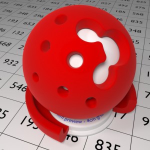

I implemented the idea. This is with a sheen value of 1.0 (the max allowed before):
scene.materials.shell.type = disney
scene.materials.shell.basecolor = 0.5 0.0 0.0
scene.materials.shell.roughness = 1.0
scene.materials.shell.sheen = 1.0
scene.materials.shell.sheentint = 0.0

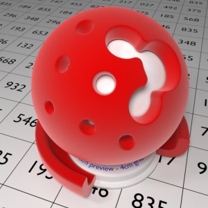

And this with 10.0:
scene.materials.shell.sheen = 10.0

That looks impressive...

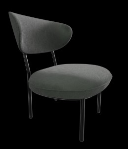

Oh man. It's working beautifuly now :shock:
aside the wonky triplanar
btw legs don't have sheen it's just reflection that makes it look like the outline is glowing :D

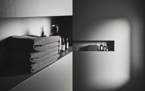

Such a small tweak, and such a great feature for fabrics....
2 pics I made for my insta (just random stuff)
