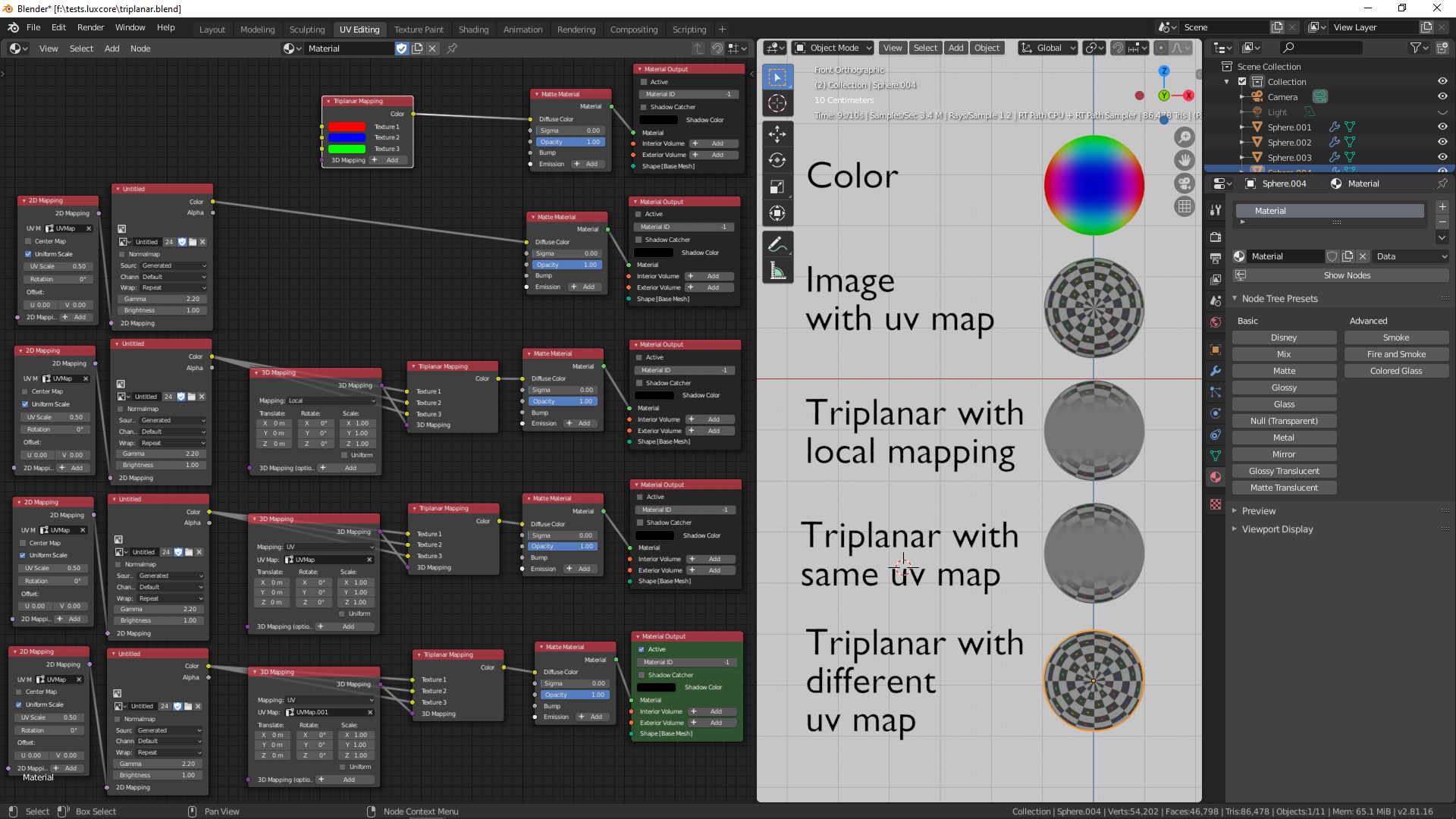

I can confirm that there is something wrong with the triplanar mapping. If I use default color input it renders correctly but if I use local mapping it doesn't. If I use same uv index it renders not correctly, too. With different uv index (but same copied uv map) it renders correctly.
When I use standard colors it renders correctly but with images it does not.

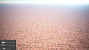

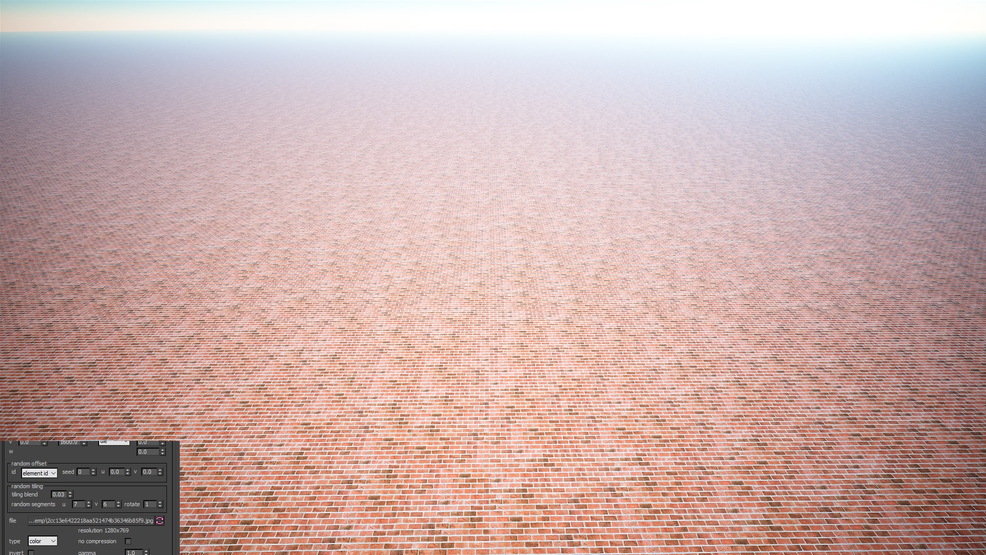

By the way, is this a good base for stochastic/random texturing like here in fstorm:
tiles:
randomized(with locked rotation so pattern is straight):
or is this unrelated feature?

lacilaci wrote: Fri Jan 03, 2020 7:47 am or is this unrelated feature?
It is not related to triplanar mapping but it can be implemented as a special type of mapping :idea:

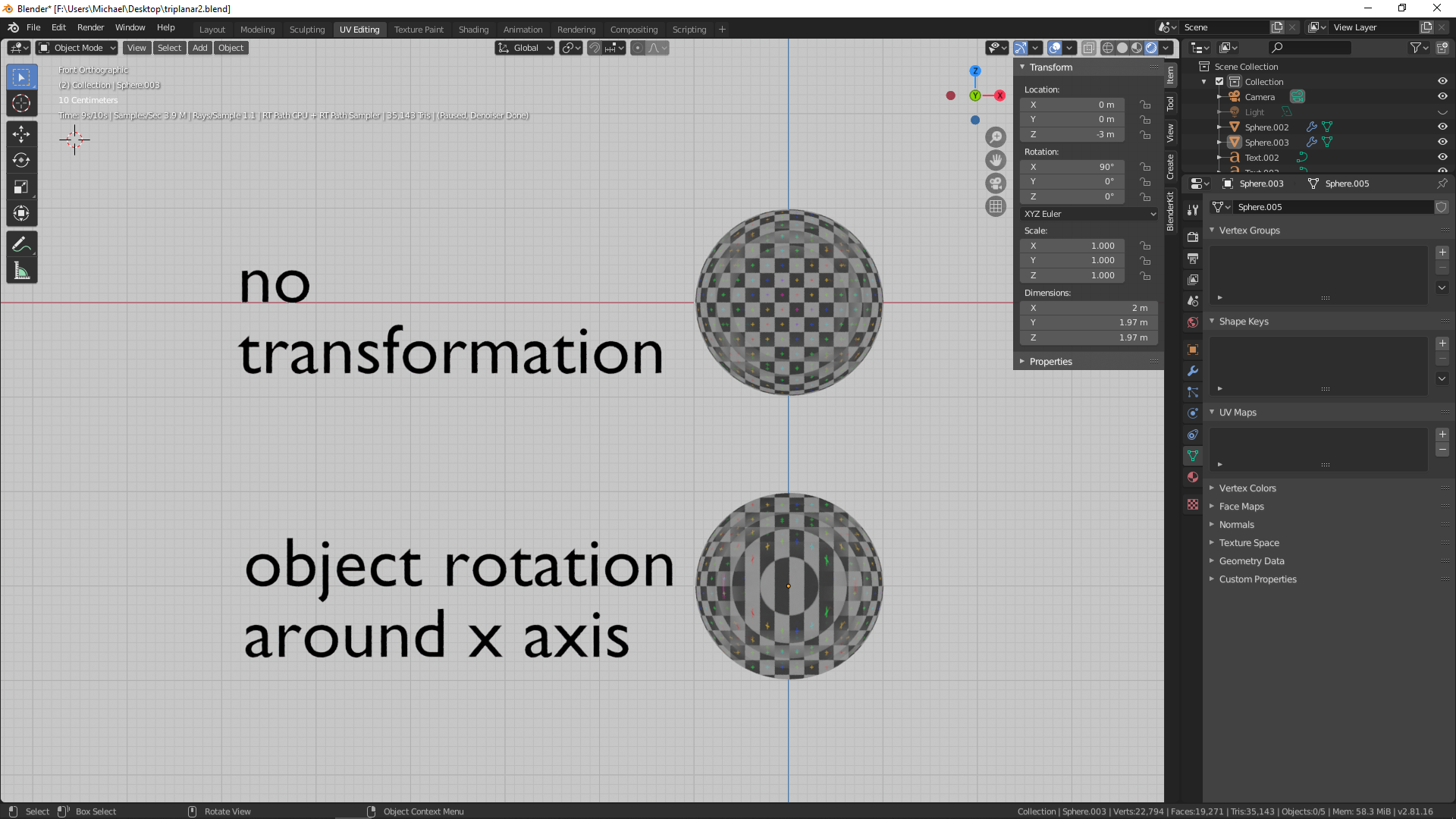

Thanks Dade for reworking. There is still something strange. With local mapping it shouldn't matter how the object is transformed but if you rotate the object then the texture gets distorted. Is the hitpoint position or normal evaluated in local or global coordinate frame?
neo2068 wrote: Sat Jan 04, 2020 4:13 pm Is the hitpoint position or normal evaluated in local or global coordinate frame?
I think it may be a problem with the normal not being transformed (only the point is), I will check.
