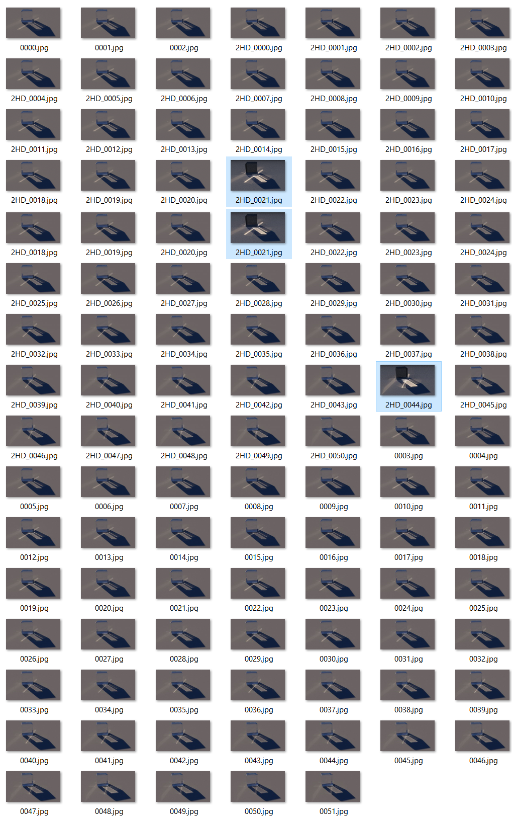

They do 3x in 50 frames for 2xHD resolution, but not for HD only.
testanim281-.blend
testanim281-.blend

Thanks @FarbigeWelt for testing and confirming!
Good to know I'm not the only one experiencing this (and it is not an nVidia issue).
Also the caustic brightness variations are visible in your table.
