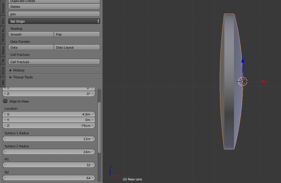

Finally had some time to continue. First addition: Material textbox as suggested by B.Y.O.B. (thanks!) together with checkboxes for smooth shading and adding an edge-split modifier.
The material must be pre-defined on some dummy object. It does not work to create a lens/mirror, add a material to it, rename the material and then enter the name in the textbox. (It only works if the material is called "Material", because Blender will automatically rename it in this case :D)

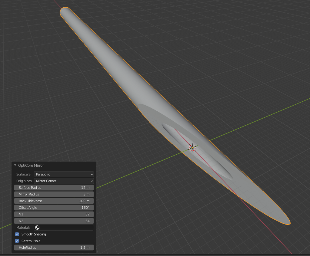

Furthermore, by request of a GitHub-issue, I already included a first version of aspheric surfaces on lenses, and mirrors can now include a central hole along the main axis.
As a funny side-effect, which I noticed while testing, you can use it to model syringe-needles :D

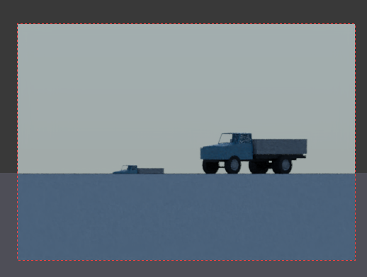

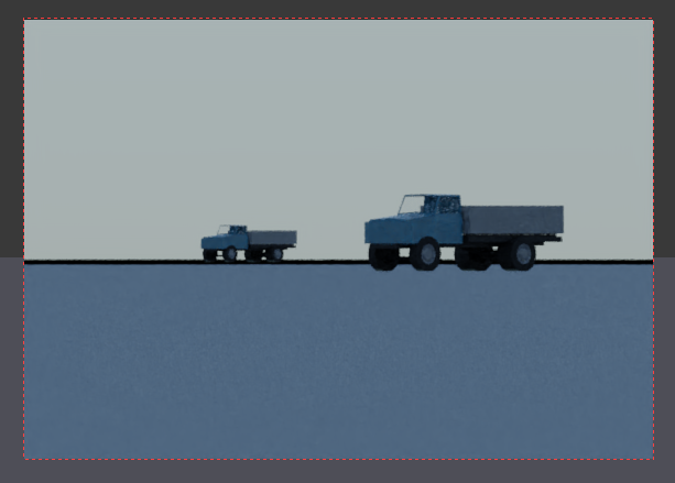

With just a few clicks I made this disk section of earth, with 20 km diameter.
Look, with camera at 0.5 meter above the ground, the truck that's 6 km from camera is half beneath horizon! Other one, which is closer isn't beneath.
    If it's flat plane, both trucks would be fully visible.

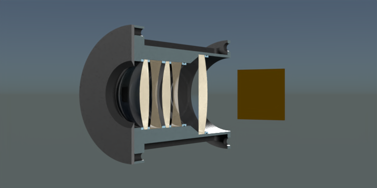

    And square-divided? Do you mean D-shaped lenses like in this cross-section model? I already have plans to implement those.

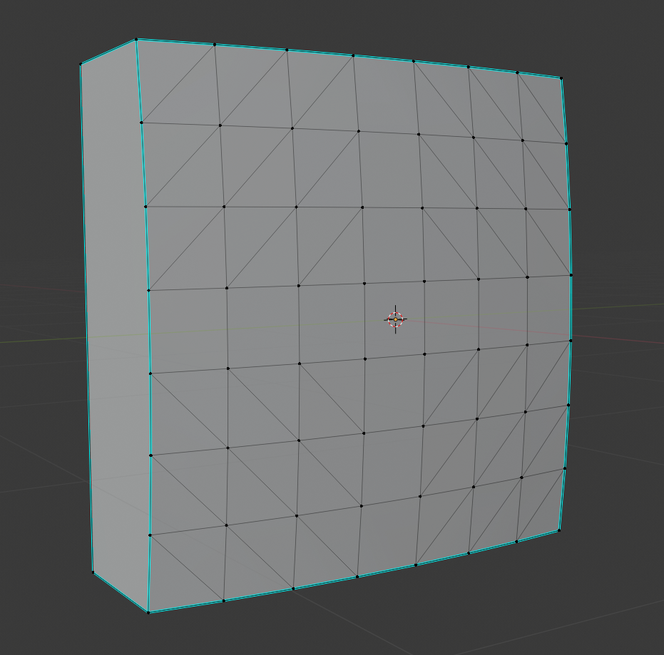

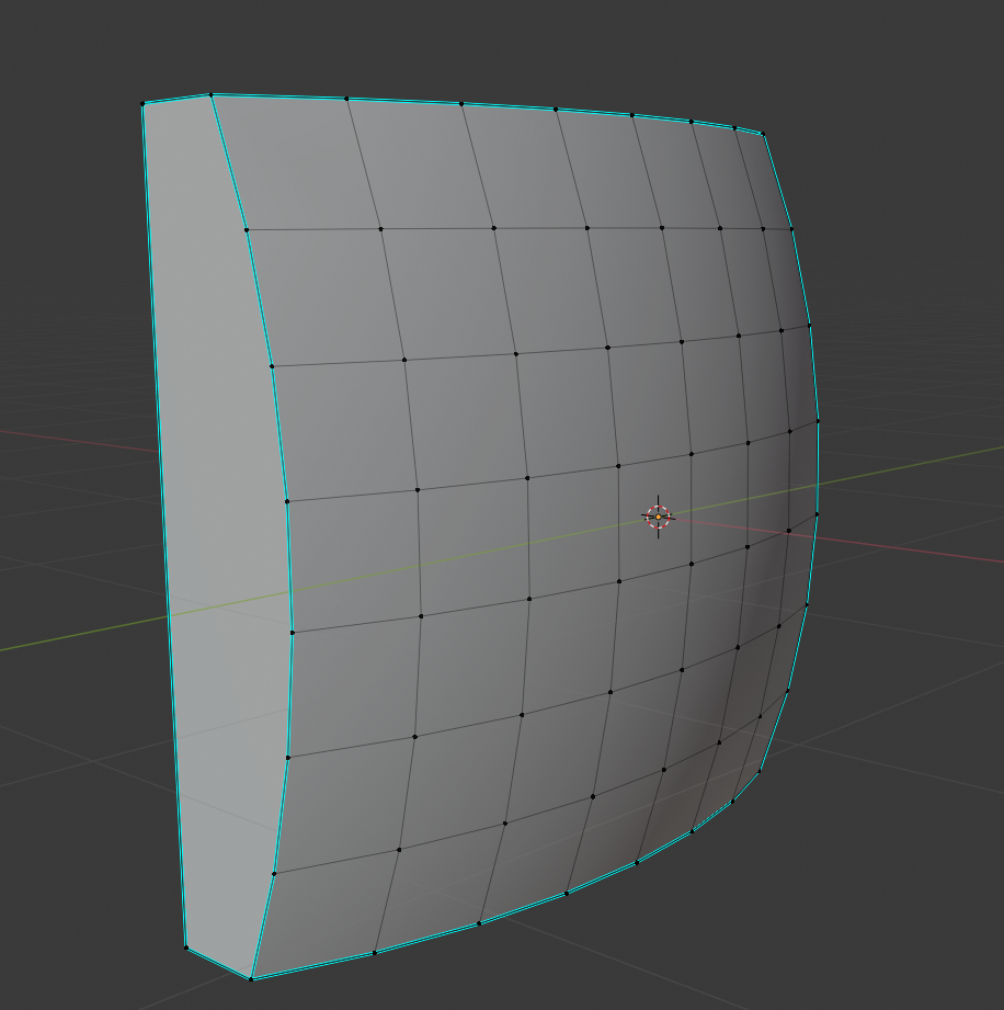

    I added a square lens. Have a look if thats what you wanted.
    It is perfectly square now, so not exactly like a u,v-sphere cutout, which would deviate a lot for strongly curved surfaces.
    However, the square surfaces at the moment are not perfectly defined, because I used quadrilaterals, and in this case not all vertices lie in the same plane. I will see what is the most elegant way to define surfaces elements... Shouldn't be much of a problem for most use cases though.

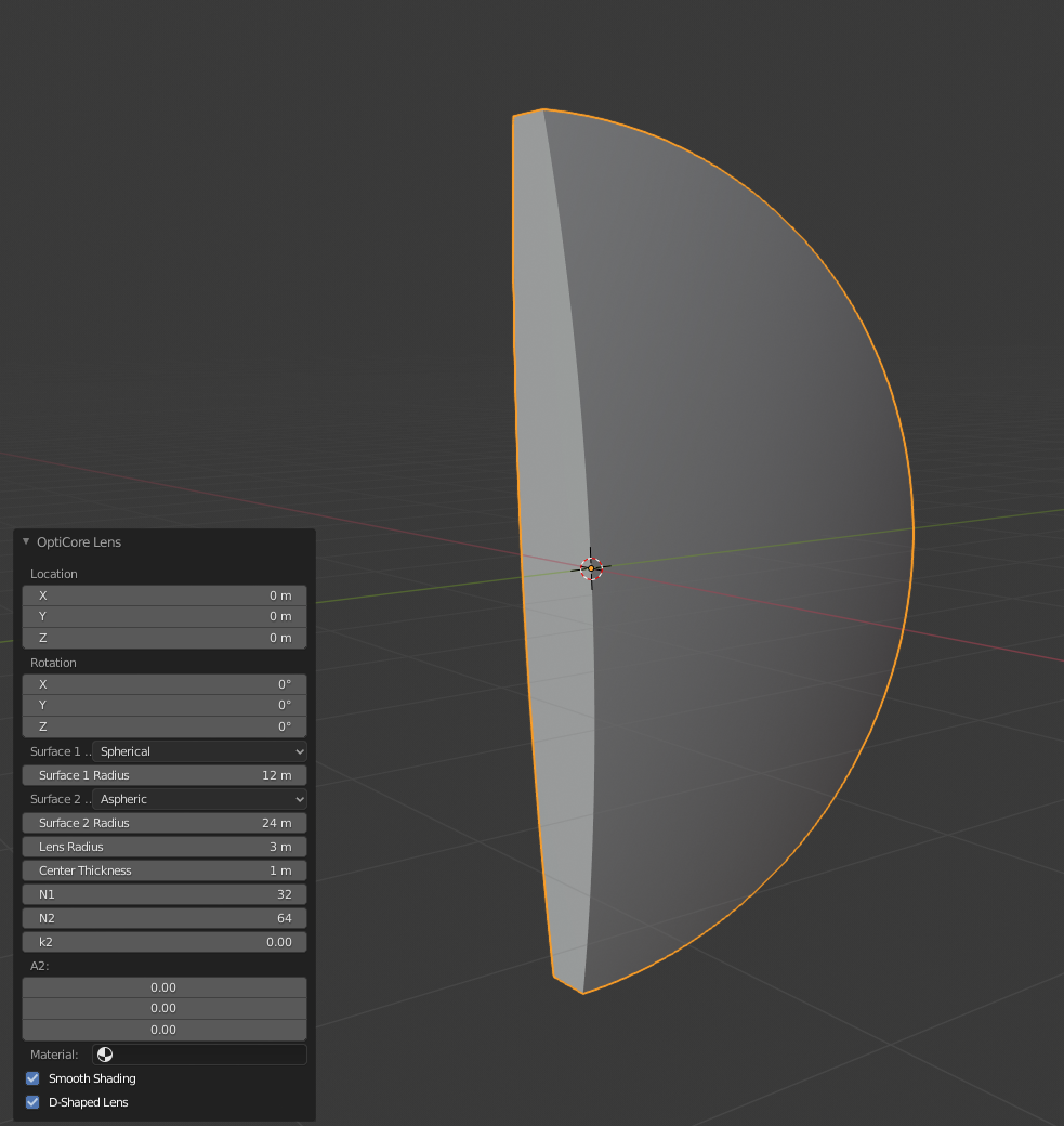

    I now optimized the mesh geometry of the square lens, and added a cross-section view option (D-shape) to the regular lens.
