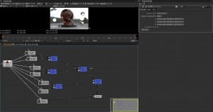

Sorry for the bump but for future reference for google:
Path Render:
(Indirect Diffuse + Direct Diffuse) + (Direct Gloss + Indirect Gloss) + Indirect Specular + Emission = Beauty

cgvirus wrote: Tue May 05, 2020 3:59 pm Sorry for the bump but for future reference for google:
Path Render:
https://imgur.com/a/L88gTy7
next time will be nice that you embeded your image directly on the forum so we can see it easily ;)
just click on attachements button down when writting your post.
