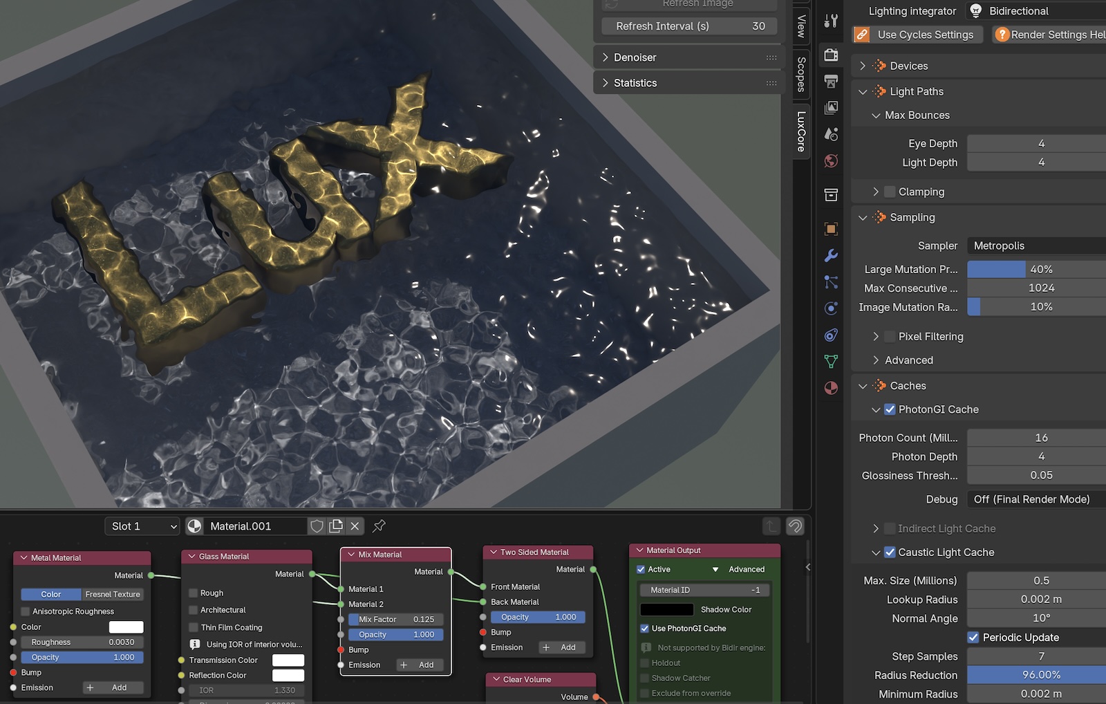

This is strange, when I open your file with Blender 4.5 and LuxCore 2.10 on my MacBook and hit render I get caustics immediately :?
What hard- and software do you use?
Still I made another file with some changes:
- switch to BiDir with 4/4 Bounces only because Hybrid engine does not work with skylight caustics efficiently
- use Metropolis sampler and uniform light strategy
- adjust caustic cache settings
- 1 min sample time is too short, use 256 samples + denoiser instead
- attach sky to sun light in light settings
- use scaled down ocean instead of displace modifier, add subdivision after displacement (and smooth shading)
- pimp up the glass material with blue volume and a metal surface component to catch the sun reflections
Cau3.blend.zip
(118.19 KiB) Downloaded 1688 times

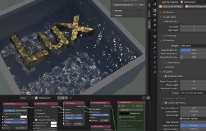

Hello,
I confirm what epilectrolytics said !
Your file with a render time of 600 [s] :
I would add one point : you need to check your 3D objects (normals, triangles, and disjoint faces; e.g., the letters used "raw") to avoid the kind of defect that appears as indicated by the pink arrows.
File similar to epilectrolytics's "Cau3.blend" but with the letters corrected :
@epilectrolytics, thanks for sharing your experiences !
