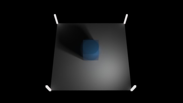

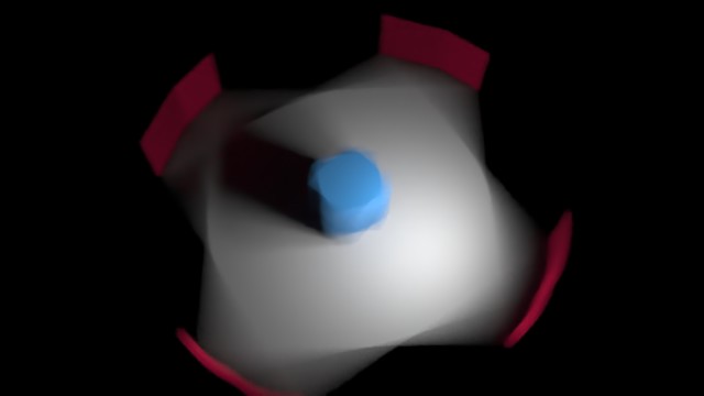

Posts: 822
Re: Camera Motion Blur
Indeed, camera blur isn't working.
Sadly, I don't know how to add/fix this functionality in BlendLuxCore.
So, for anyone able & willing to tackle this, here's a test scene and compared result to Cycles.
Also, found that emission color of Cycles Principled BSDF doesn't work.
Cycles (4.5.3)
BlendLuxCore (2.10.1)
Scene File:
CamBlur.blend
(158.62 KiB) Downloaded 6737 times
