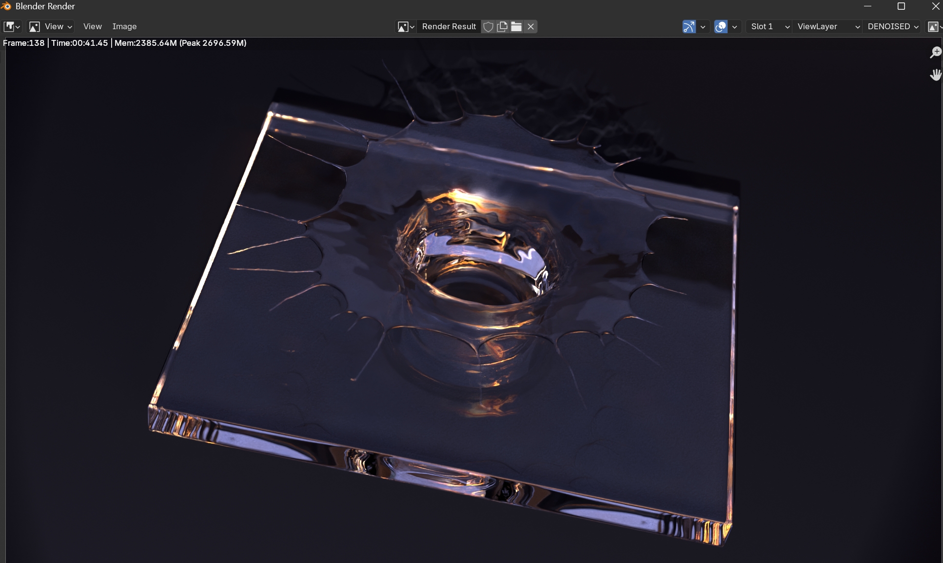

We are actually testing our FLIP Fluids Addon with different Render-Engines. LuxCore performed very well in some tests! Thank you @all developers for your hard, and good work! LuxCore is amazing. A great render of a liquid drop is attached!

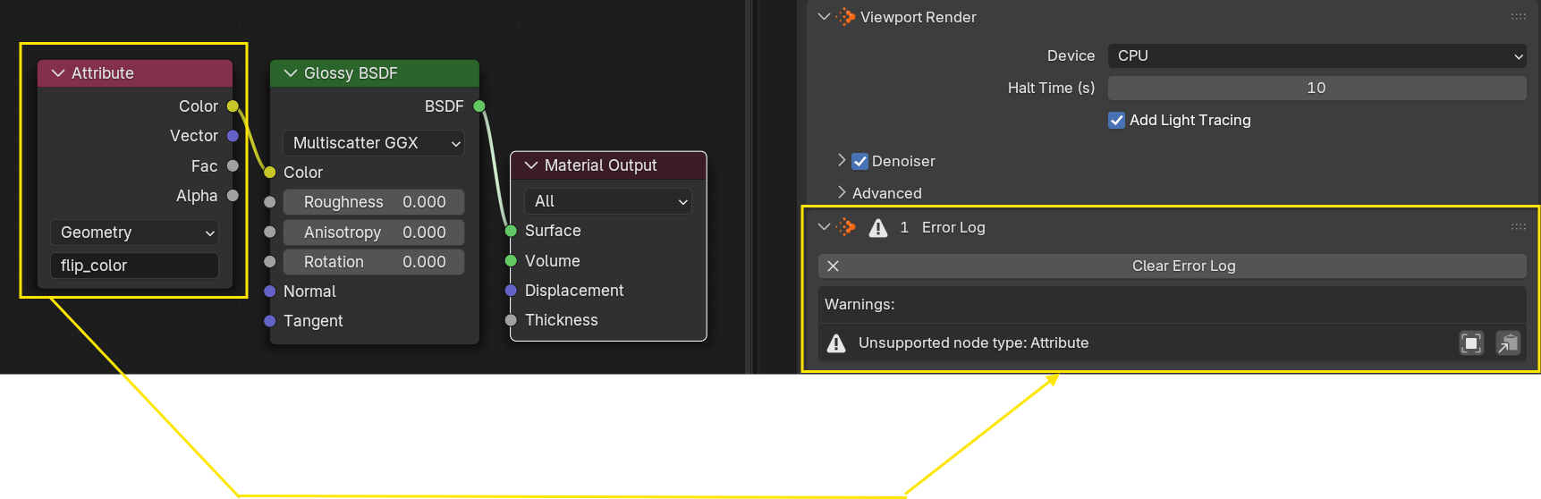

While testing i found out, that there is no attribute-input in the lux-shader-editor.
That one would make it possible to work with our flip-attributes (like colormixing as example).
As workaround i have tryed to use a cycles-shader, but that results in an error.
Maybe you have an idea about how to solve this?
If someone would like to check it, a .blend file is attached.

Hi Dennis,
thanks for the good opinions!
I'm not familiar with this Cycles feature, but at first glance looks like it should not be much of a problem, requiring only addon changes and not the core library. Though I need to understand what your Flip-attributes actually contain.
Could you post that request directly as an Issue on GitHub in thsi repo: https://github.com/LuxCoreRender/BlendLuxCore
Always best if it is documented directly from the source.
