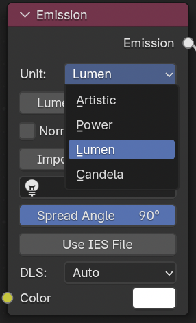

The kind of light also is important, if you want comparable brightness define lights as physics not as artistics. I prefer to define brightness of lamps in lumen.

FarbigeWelt wrote: Tue Jul 01, 2025 10:46 am The kind of light also is important, if you want comparable brightness define lights as physics not as artistics. I prefer to define brightness of lamps in lumen.
EDIT (facts you probably know well)
Another big influence on the brightness of light is its area.
A further influence is the maximal angle a light emits its rays.
Yes, we use only lifelike values for emitters and even for the sky. We did a series empiric measurements of sky and sun intensites at different hours and conditions and used that data to set-up our scenes. All matched with film sensitivity lenses luminosity and all that stuff. Regarding the brightness of the light related to the area of the amitting surface, this should be only in case if you use Lux variables insted of Lumen values, or not?

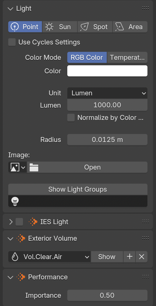

But there isn't any such choice in BlendLuxCore ..
Point Lamp
Point Lamp

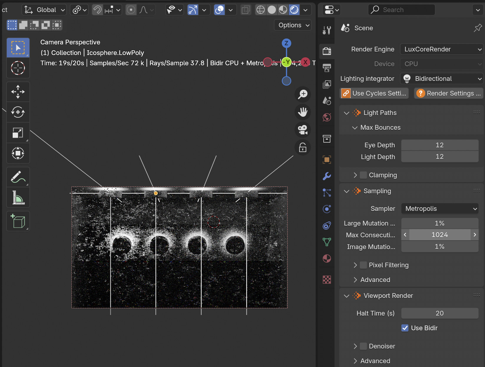

4 Different Lights:
Point Lamp: SubDiv 0, "Tris" 2, Importance 0.5
Ico Sphere: SubDiv 1, Tris 20, Importance 1.0
Ico Sphere: SubDiv 2, Tris 80, Importance 1.0
Ico Sphere: SubDiv 3, Tris 320, Importance 1.0
Matte.White.Emit.Importance.1

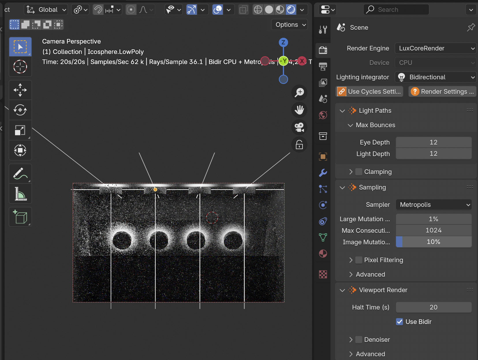

Noise patterns of indirect lightening depending on Metropolis' Settings.
(part one)
Metropolis: 1%, 8, 1%
Metropolis: 1%, 8, 10%
Metropolis: 1%, 8, 100%
Metropolis: 1%, 1024, 1%

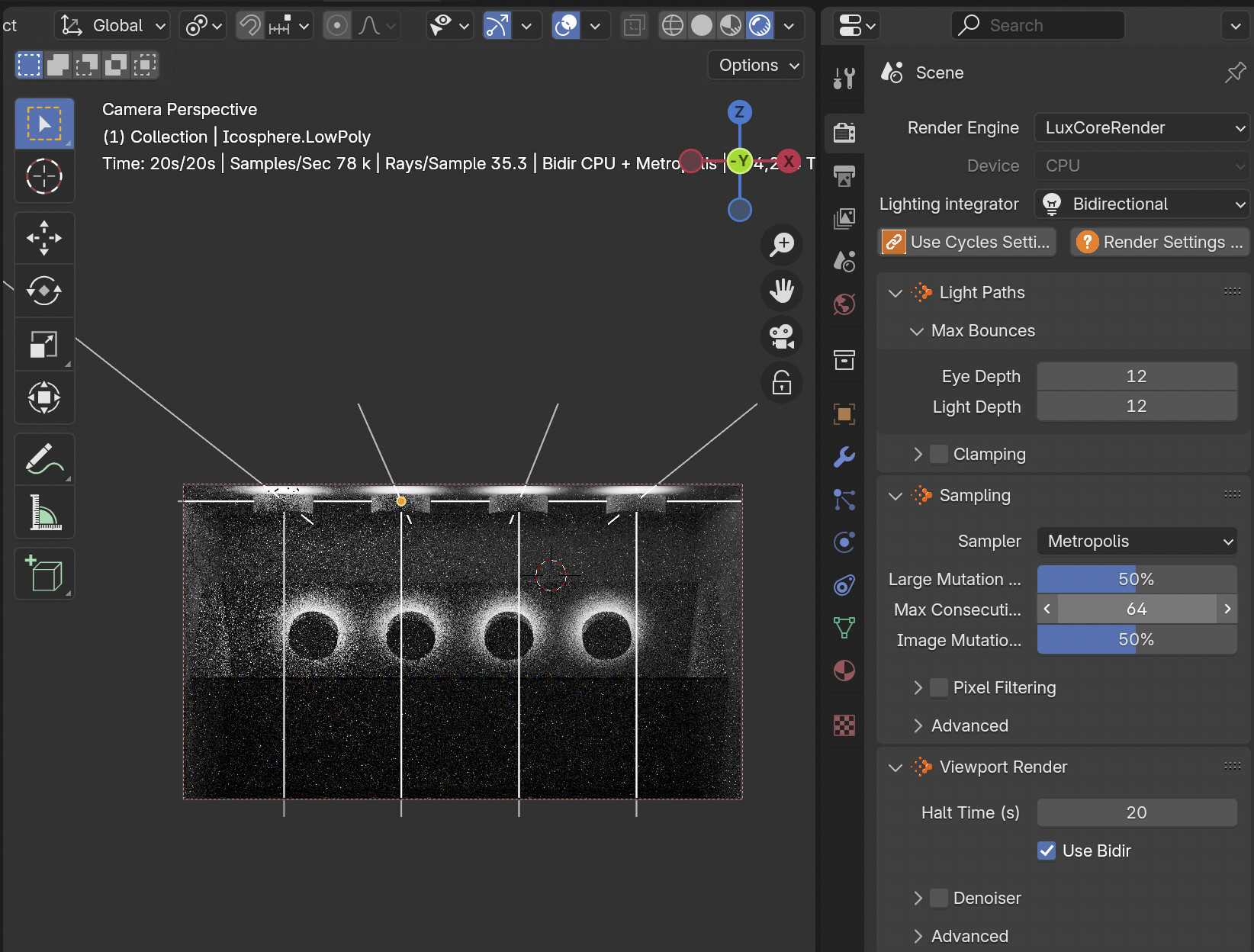

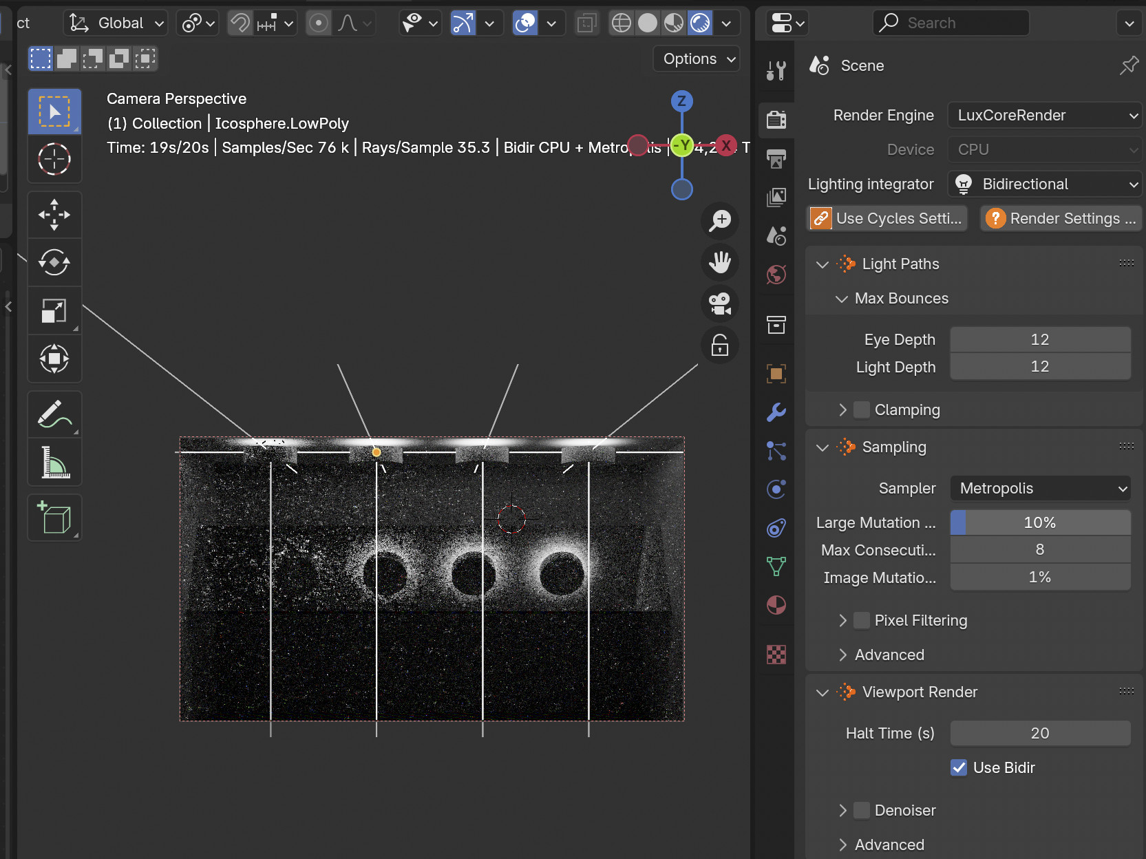

(part two)
Metropolis: 10%, 8, 1%
Metropolis: 50%, 8, 50%
Metropolis: 50%, 64, 50%
Metropolis: 50%, 1024, 10%
Metropolis: 50%, 1024, 50%
Metropolis: 100%, 8, 1%
