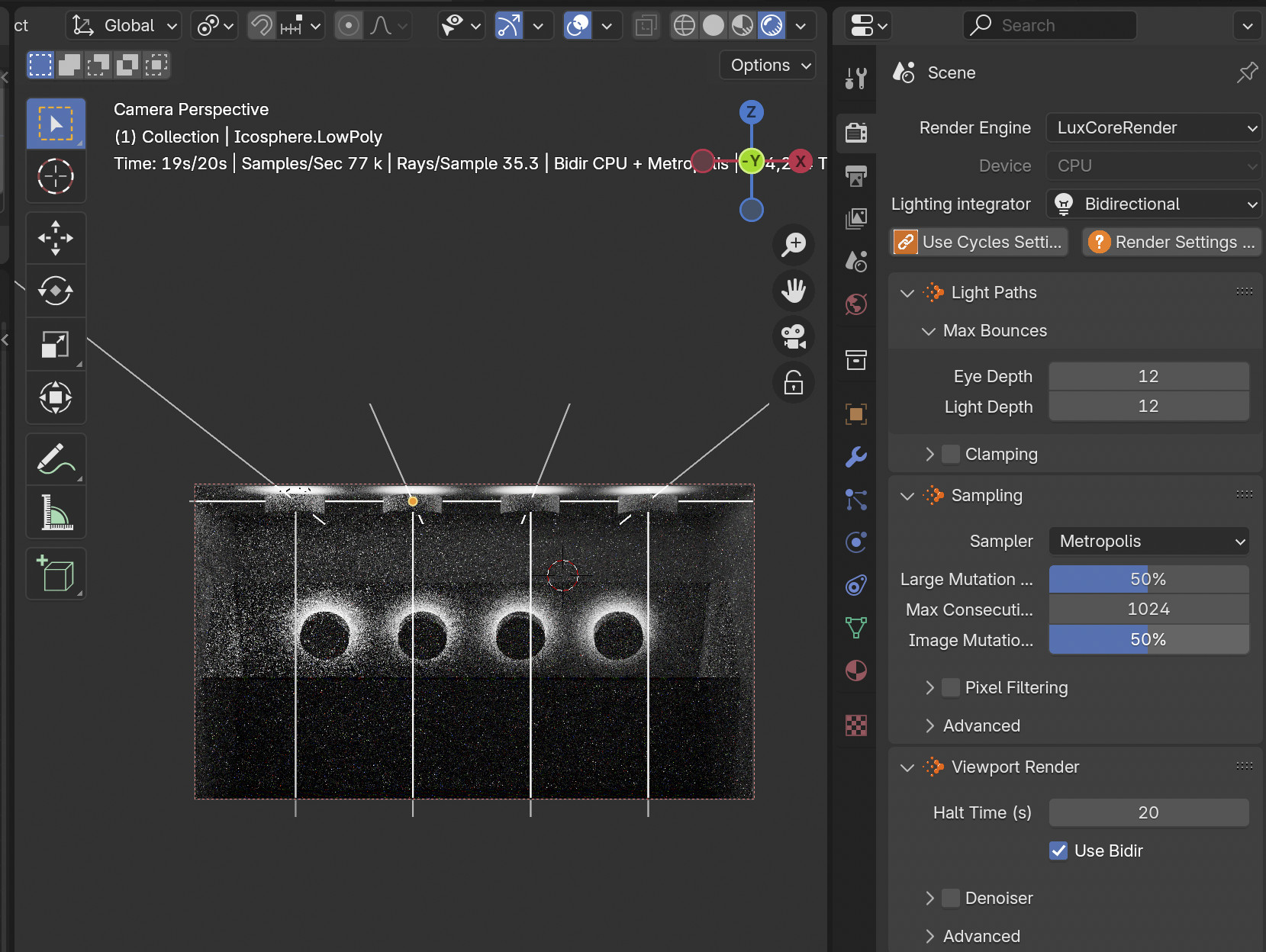

Point Lamp: SubDiv 0, "Tris" 2, Importance 0.5
Ico Sphere: SubDiv 1, Tris 20, Importance 1.0
Ico Sphere: SubDiv 2, Tris 80, Importance 1.0
Ico Sphere: SubDiv 3, Tris 320, Importance 1.0
Matte.White.Emit.Importance.1
Noise patterns of indirect lightening depending on Metropolis' Settings.
(part one)

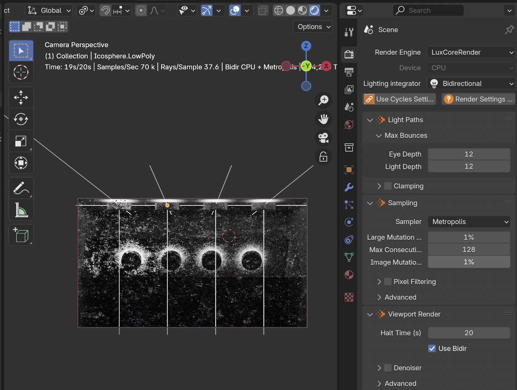

Re: animation settings
(part two)
(part two)
