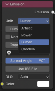

But there isn't any such choice in BlendLuxCore ..
Point Lamp
Point Lamp
Material
Material

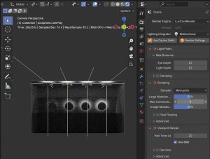

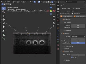

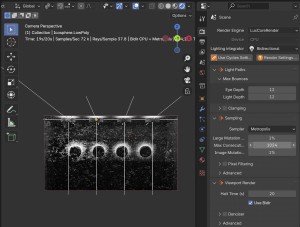

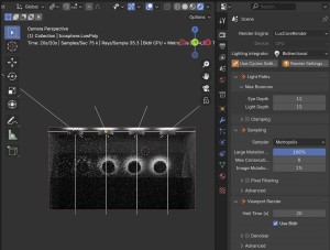

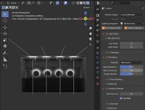

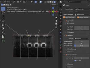

4 Different Lights:
Point Lamp: SubDiv 0, "Tris" 2, Importance 0.5
Ico Sphere: SubDiv 1, Tris 20, Importance 1.0
Ico Sphere: SubDiv 2, Tris 80, Importance 1.0
Ico Sphere: SubDiv 3, Tris 320, Importance 1.0
Matte.White.Emit.Importance.1
Noise patterns of indirect lightening depending on Metropolis' Settings.
(part one)
Metropolis: 1%, 8, 1%
Metropolis: 1%, 8, 10%
Metropolis: 1%, 8, 100%
Metropolis: 1%, 1024, 1%
Metropolis: 1%, 128, 1%
Metropolis: 1%, 1024, 50%

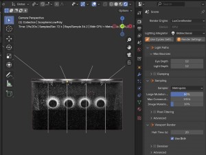

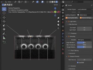

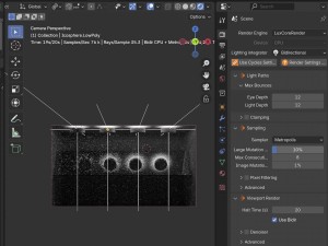

Posts: 1083
Re: animation settings
Post by FarbigeWelt »
(part two)
Metropolis: 10%, 8, 1%
Metropolis: 50%, 8, 50%
Metropolis: 50%, 64, 50%
Metropolis: 50%, 1024, 10%
Metropolis: 50%, 1024, 50%
Metropolis: 100%, 8, 1%
