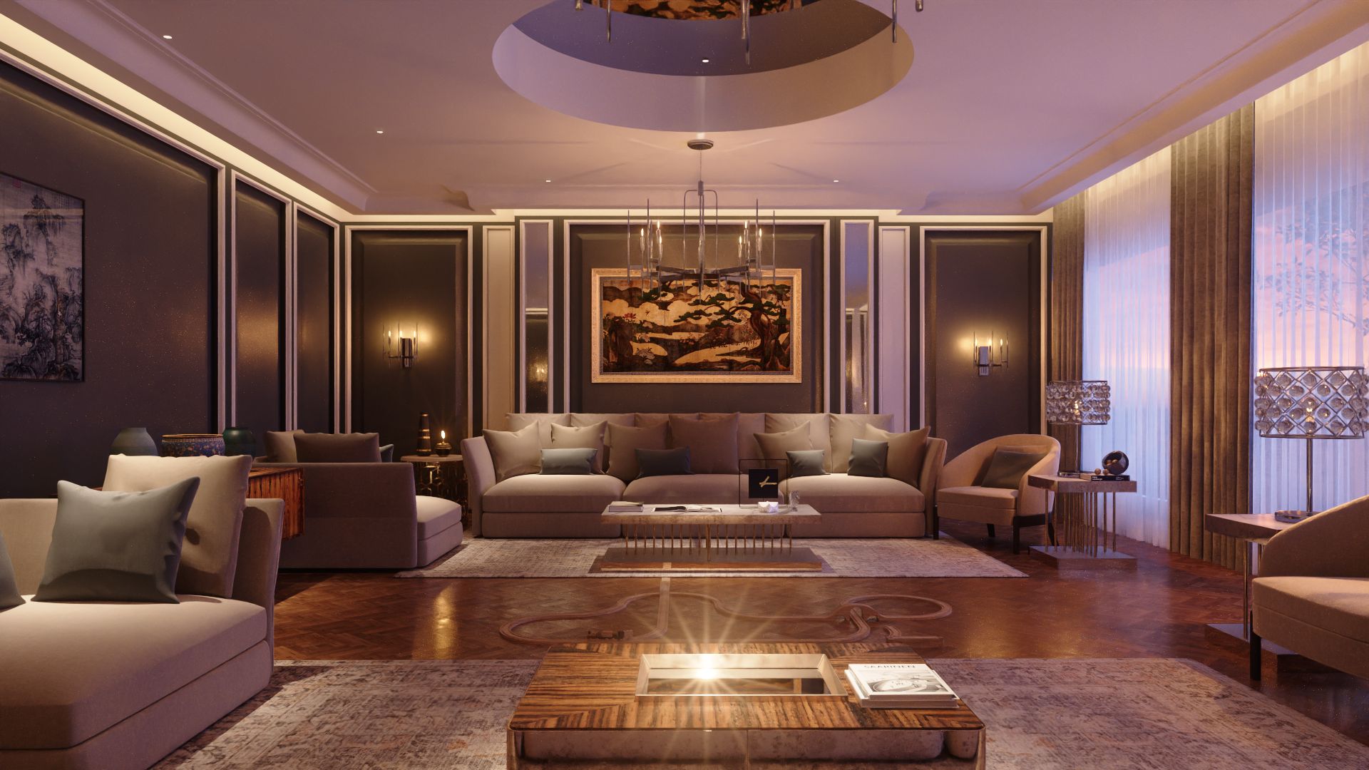

Hi, at the end we opted for a different solution to produce animations. Our requirement is to a achieve zero-set-up solution.
Precaluclated GI caching and so on need to much scene dependant tweaking while metropolis is too slow, GI baking is impossible on complex scenes.
So the we opted for an metropolis+AI solution for animations. We render one each 10 frames using bidir and interpolate the sequence using Dain Ncnn or IrfNet. In most scenes it gives us the highest quality and perfectly smooth and and flicker free animations while keeping 2k frames aroud 1 minute. I show you some results today or tomorrow.
But some scenes behave in wired way even under metropolis. In the following scene some frames show up much brighter as others! I was not expecting this from Metropolis...
Any idea what it could be?
Mp4
https://drive.google.com/file/d/1iZutWe ... drive_link
Sequence
https://drive.google.com/file/d/13-Zj6q ... drive_link

Posts: 1074
Re: animation settings
Post by FarbigeWelt »
daros wrote: Sat Jun 28, 2025 12:40 pm So the we opted for an metropolis+AI solution for animations. We render one each 10 frames using bidir and interpolate the sequence using Dain Ncnn or IrfNet. In most scenes it gives us the highest quality and perfectly smooth and and flicker free animations while keeping 2k frames aroud 1 minute..
this are our metropolis settings:
light.maxdepth 64
path.maxdepth 128
sampler.metropolis.maxconsecutivereject 512
lightstrategy.type "POWER"
film.filter.width 1.5
path.clamping.variance.maxvalue 2000000000000000000
What is your reason for different max depths?
Actually values around the default value 10 is enough.
For scenes with lots of glasses and mirrors or materials with specular or diffuse value about 80% or higher, large max depths make sense. You most probably know well.
Why do you use film filter? No filter may show better results with AI frame interpolation ..
Did you try different light strategy besides power too?
Lower path clamping should lead to lower noise.
You may find some good tips regarding resolving Metropolis temporal issues in this paper here:
https://www.mathematik.uni-marburg.de/~ ... opolis.pdf
MacBook Air with M1
Posts: 307

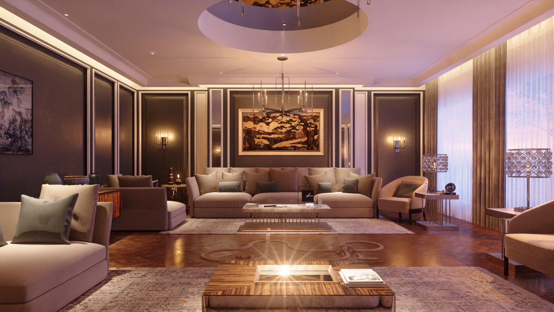

Hi Farbige welt, yes we use high ray depth values in order get even the most complex scenes right. Our users are not aware of render related issues so we want to give them a zero settings solution. For static rederings Bidir as we have it, works well.
LOG_POWER changes completely the lighting:
https://drive.google.com/file/d/1xIVhFV ... drive_link
Bidir with caustics photon GI enabled is almost identical to BIDIR only:
https://drive.google.com/file/d/1MJ0IVQ ... drive_link
Photon GI for diffuse and caustics is decent but i have to git rid of those persistent fireflies
https://drive.google.com/file/d/1x8antY ... drive_link
There are two types of fireflies here i belive: one i think has to do with the photon GI settings while the other with the clamping.
If i try to reduce them by reducing clamping the lighting is afftected too much:
Clamping 200000
Clamping 20000
It is probably better to eliminate those fireflies in a postproduction pass. No idea how to get rid off the caustics sploches since caustic GI already has 10.000.000 photons.
Still the most interesting solution would be to get bidir right but do not understand why two adiacent frames can have such a huge difference in luminance like in my animations. Bidir should be precise.

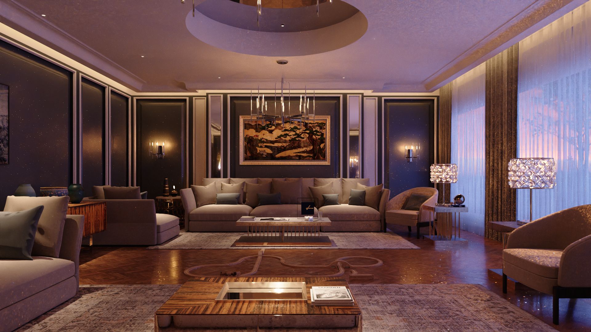

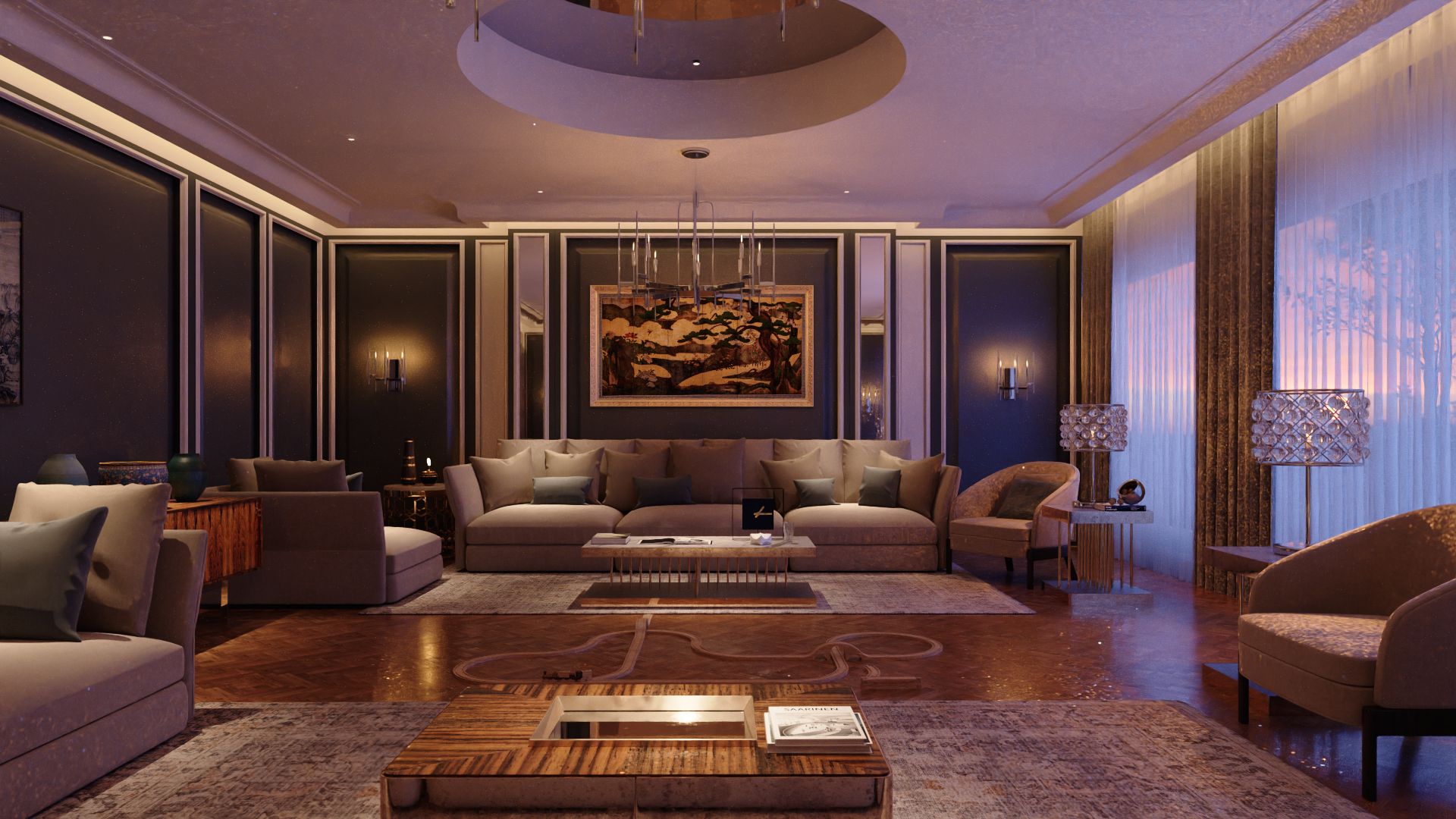

Posts: 307
the following frames have only a few mm camera translation but still the brightness variance is enourmous. BIDIR renderer
Posts: 307
It seems the fault of the brightness variations is to address to the metropolis sampler. Metropolis delivers frames with much less fireflies but with larger lighting discrepancies between frame and frame. If i use the random sampler this problem vanishes but the image starts to be full of fireflies.
