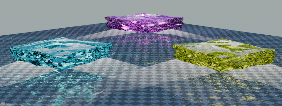

How the three parameters of the Metropolis Sampler influence rendering.
Max Consecutive Rejects (MCR)
Halt Condition: 64 Samples
Materials: Clear Glass, Rough Glass, Homogenous Glass
Lights: Area, 0.01^2
Disadvantage: render time increases with higher MCR.
Advantage: Reflections and Caustics get more dynamic aka brighter.
