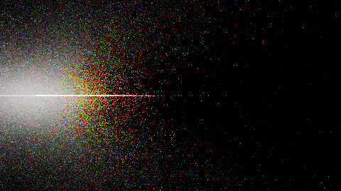

Re: Dispersion Inefficiency
I did not understand your attached scene ..CodeHD wrote: Mon May 26, 2025 8:38 amA glass that has almost no effect, just enabling/disabling the dispersion mode. File attachedFarbigeWelt wrote: Sun May 25, 2025 11:55 am Strange Discussion because here a typical Prism render looks well:
viewtopic.php?t=6105
I setup a scene with 15 thin glasses, world, camera, light volume clear with priority 0. A body with material null and volume homogenous with priority 10 multi scattering. A white Laser and a light grey floor. I also setup different materials for the glass to easy switch its properties.
Indeed with some Dispersion Laser intensity drops faster passing several glass bodies than without dispersion. However if glass bodies have 100% reflection even more light gets spread.
EDIT
If Material Output, Advanced, Shadow is set to Value 1.0 Laser does not transmit what I did not expect.
I don't see anything in the scene you attached that is a significant difference to my scene. Anyways, you noticed the general point I was making, so I guess we are on the same page.FarbigeWelt wrote: Mon May 26, 2025 1:36 pm I setup a scene with 15 thin glasses, world, camera, light volume clear with priority 0. A body with material null and volume homogenous with priority 10 multi scattering. A white Laser and a light grey floor. I also setup different materials for the glass to easy switch its properties.
About the impact of reflection, I don't see anything wrong there. With reflection, less light passes each glass sheet so the intensity drop off is faster. Beyond that, I don't think it is safe to judge at these noise levels.
When I sugested to use an IOR just above 1 (IOR = 1.00...01), that effectively does the same thing: Ensure (almost) no reflection. Additionally it would cause refractions at an angle
For this scene with a laser at 90 degrees to the glass sheets, effectively it is the saem as what you did with the refelction color set to black, so no real difference between your and my setup.
Agreed, at first glance I would not expect this either.FarbigeWelt wrote: Mon May 26, 2025 1:36 pm EDIT
Test_Glasses_noDispersion_noReflection_noShadow_noFloor, Metropolis, 64 Samples.png
Another note: This kind of setup doesn't require BiDir Engine to work. The result should be mostly the same when using light tracing - at least as far as the directly visiable beam is concerned.
However, it is not equivalent, Light tracing seems to make up some energy after several glass sheets when using dispersion.

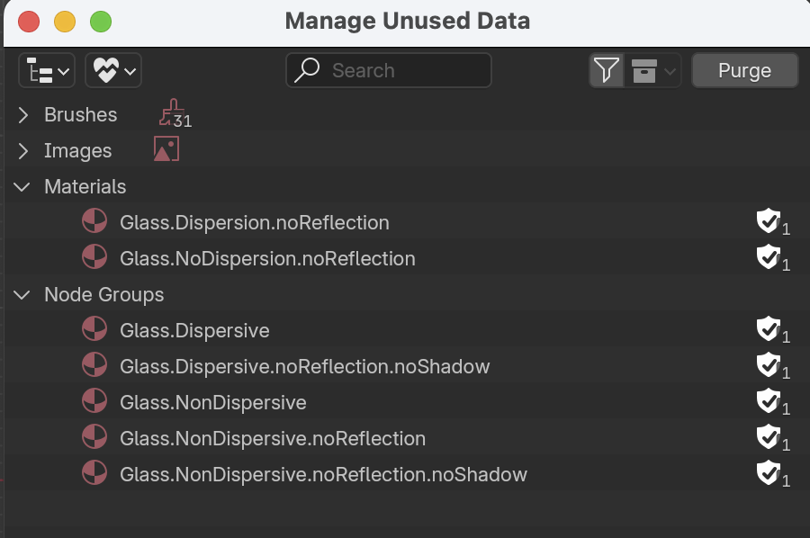

Another note:
Unused Material seems to get lost by saving but not their corresponding Nodes. To avoid this lost a fake user (shield) has to be defined for all materials not connected to an object. I may open an issue for that in Github if it is not a standard Blender behavior.
