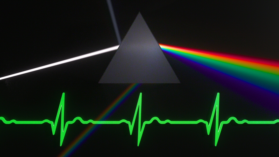

I only dabble in rendering and was away from it for a few years. Finally getting back
into it. But I only just now noticed the loss of this feature when I decided to
re-create my Pink Floyd prism logo from 12 years ago so I can render it bigger, only
to be stymied why the rainbow was all wonky.
After some quick research I found the discussions on this so just wanted to chime in
and add my voice to those desiring this feature.
I never noticed before on anything else I did, but now that I know, I will always feel
that my images aren't 'perfect', as my interest is in photorealism, and accurate
dispersion is an important element to that.

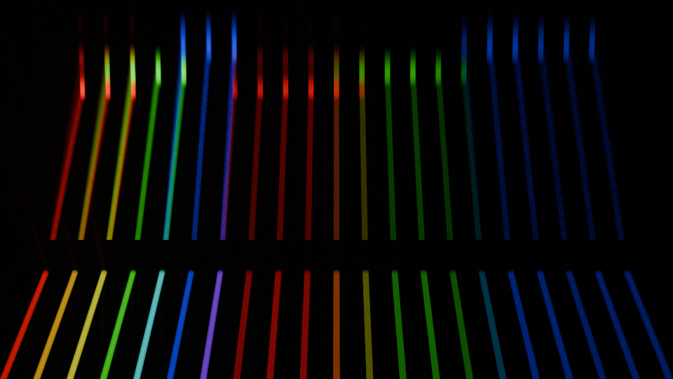

And as requested, a sample scene and file.
LaserPrism2.blend
(1.58 MiB) Downloaded 8107 times
Sample of 'laser' lights going a through a prism and the dispersion hitting a screen. Volume scattering is used to visualize light beams.
The first 7 are lights colored using RGB values in the usual ROYGBIV rainbow. I can forgive the violet/purple one splitting into red and blue as, since it was defined using RGB, how is the render engine to know violet from purple?
The next 14 are emissive light panels. Each is using irregular data to define the spectral output. Each is 10 nanometers wide centered on wavelengths 650nm through 390nm at 20nm intervals.
Note the lack of smooth change in dispersal pattern from left to right. Only that each dispersion is composed of varying intensities of red, green, and blue. Yellow and cyan are absent in the dispersed light, being composed instead of combinations of red/green and green/blue. On the far right where violet is, the dispersion is only blue and dispersion never changes regardless of wavelength. Also note that there is always some red present just past green whenever there is any red involved (notably in orange).
It is quite apparent that the light source spectral data is converted to approximate RGB values, then those RGB values are used to calculate the dispersion disregarding the actual spectral content. The resulting rays are themselves RGB values with no spectral content. Else why would a pure yellow spectral light source disperse into two bands of red and green with no yellow content?
BTW, Blender 4.0.2, LuxCoreBlend 2.8.

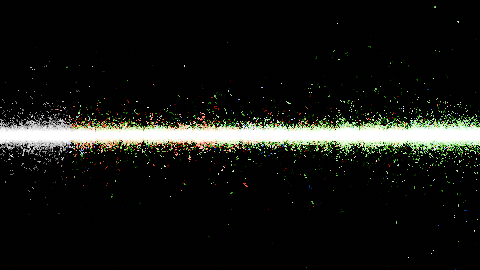

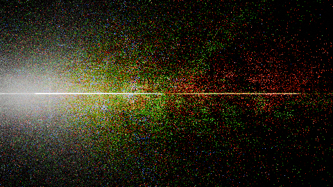

A glass that has almost no effect, just enabling/disabling the dispersion mode. File attached
I did not understand your attached scene ..

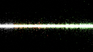

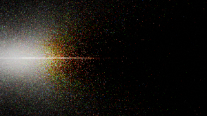

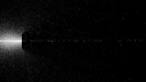

I setup a scene with 15 thin glasses, world, camera, light volume clear with priority 0. A body with material null and volume homogenous with priority 10 multi scattering. A white Laser and a light grey floor. I also setup different materials for the glass to easy switch its properties.
Indeed with some Dispersion Laser intensity drops faster passing several glass bodies than without dispersion. However if glass bodies have 100% reflection even more light gets spread.
No Dispersion, No Reflection, No Floor

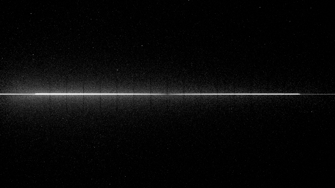

No Dispersion, No Reflection, Floor

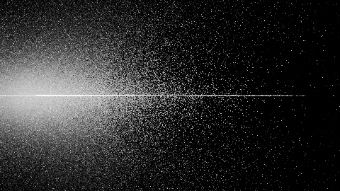

No Dispersion, Reflection, Floor

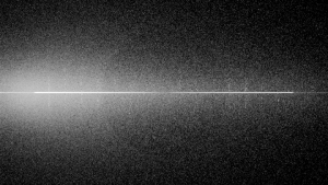

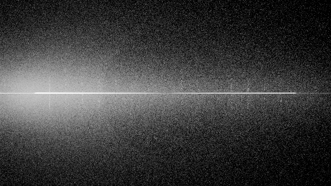

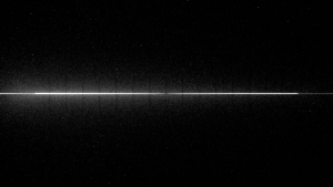

EDIT
If Material Output, Advanced, Shadow is set to Value 1.0 Laser does not transmit what I did not expect.
No Dispersion, No Reflection, Shadow Value 1.0, No Floor

FarbigeWelt wrote: Mon May 26, 2025 1:36 pm I setup a scene with 15 thin glasses, world, camera, light volume clear with priority 0. A body with material null and volume homogenous with priority 10 multi scattering. A white Laser and a light grey floor. I also setup different materials for the glass to easy switch its properties.
I don't see anything in the scene you attached that is a significant difference to my scene. Anyways, you noticed the general point I was making, so I guess we are on the same page.
About the impact of reflection, I don't see anything wrong there. With reflection, less light passes each glass sheet so the intensity drop off is faster. Beyond that, I don't think it is safe to judge at these noise levels.
When I sugested to use an IOR just above 1 (IOR = 1.00...01), that effectively does the same thing: Ensure (almost) no reflection. Additionally it would cause refractions at an angle
For this scene with a laser at 90 degrees to the glass sheets, effectively it is the saem as what you did with the refelction color set to black, so no real difference between your and my setup.
FarbigeWelt wrote: Mon May 26, 2025 1:36 pm EDIT
Test_Glasses_noDispersion_noReflection_noShadow_noFloor, Metropolis, 64 Samples.png
Agreed, at first glance I would not expect this either.

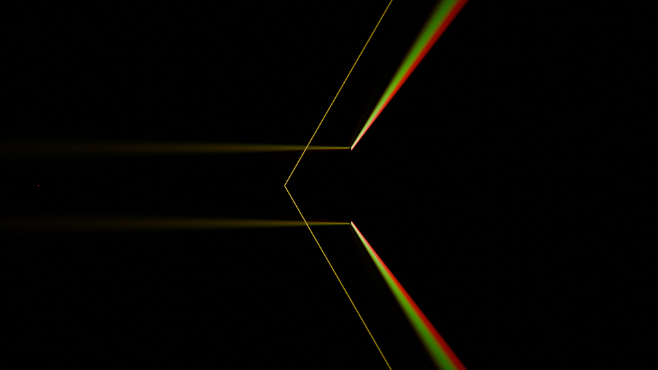

Another note: This kind of setup doesn't require BiDir Engine to work.
The result should be mostly the same when using light tracing - at least as far as the directly visiable beam is concerned.
Well, for some setups it makes quite a difference whetter one uses BiDir or Path with Light Tracing.:geek:

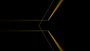

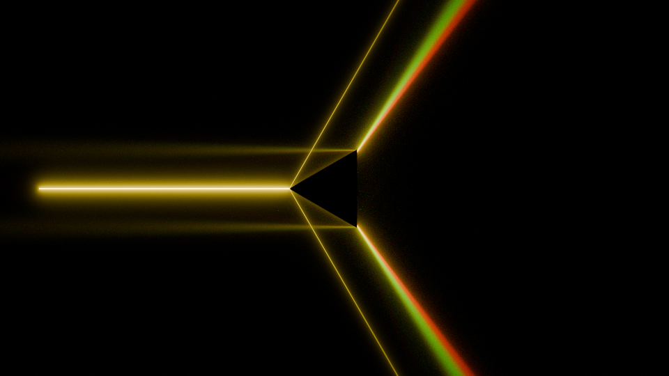

Back to topic. The light source in this scene is a plane with an emissive matte material. It uses an irregular data set for yellow.
Indeed yellow is simulated as a mixture of green and red. A full spectral renderer wouldn't do that.
BiDir
BiDir
Path and Light Tracing

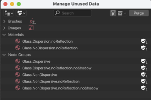

Another note:
Unused Material seems to get lost by saving but not their corresponding Nodes. To avoid this lost a fake user (shield) has to be defined for all materials not connected to an object. I may open an issue for that in Github if it is not a standard Blender behavior. :roll:
Loosing Materials but not their Nodes
