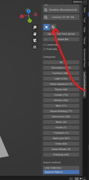

Hi , here are some quick bugs hunt result I found in recent
Blendluxcore for Blender V4.

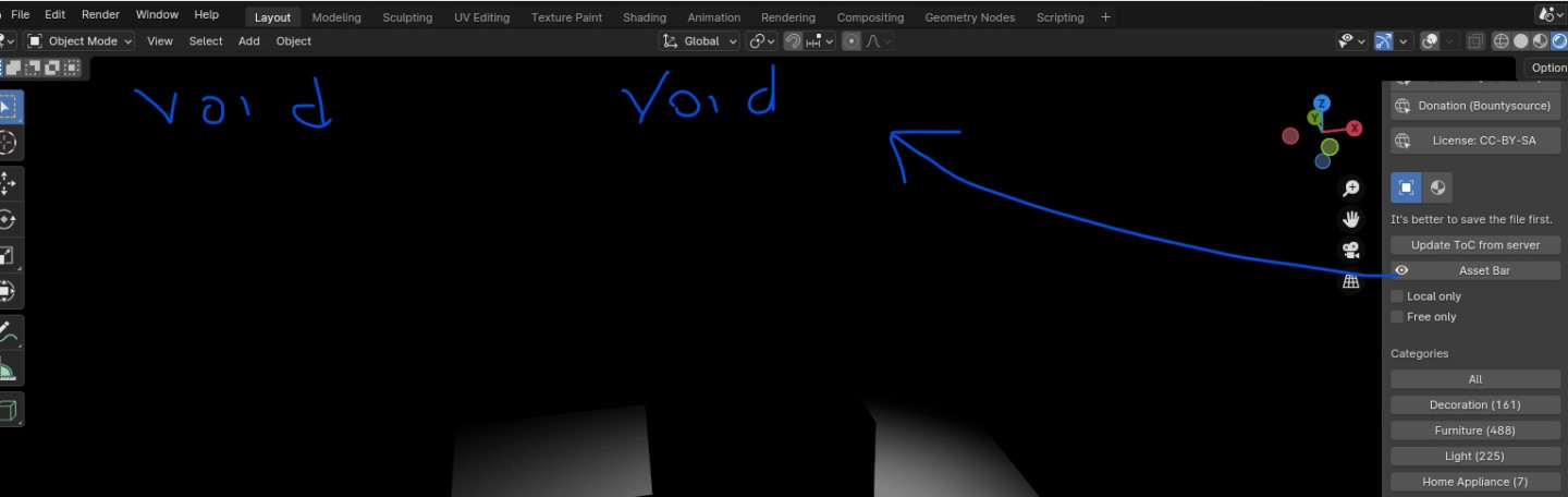

1__ Luxcorerender Online Library thumbnails bar is no longer visible (look like it is there and clicking in
the void select object but thumbnails are invisible.)
2__ Luxcorerender Online Library selecting materials display mode crash blender instantly

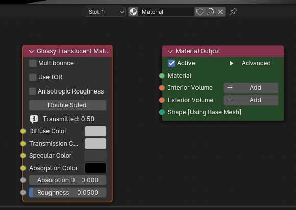

3__ glossy Transluscent and volume pointer dn't have output
