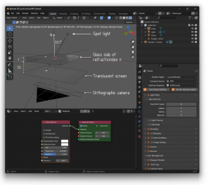

I have created a scene based on the image below. A spotlight illuminates a glass slab with a refractive index of n and strikes a translucent screen. Below the screen, an orthographic camera is positioned to capture images for different values of the refractive index. One would expect the position of the beam to hit the translucent screen at different positions, according to Snell's law, when n is varied; however, this is not the case, as can be seen in the captured images.
Am I approaching this the wrong way? Can anyone shed some light on this anomaly?
I'm using Blender 3.6.5. LTS and LuxCoreRender 2.7
The layout of the experiment.
Captured images for different refractive indices.
