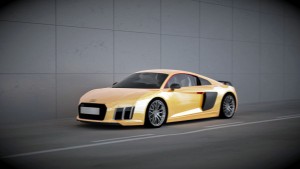

here is a snap where I just added some motion blur:

here is your scene with a jeep. I think it looks ok

Very nice rendering modhob, maybe for the glass to let more light in you could increase the specular and the total path to 12 in the Light path settings and also in the glass material output make the shadow color completely white.

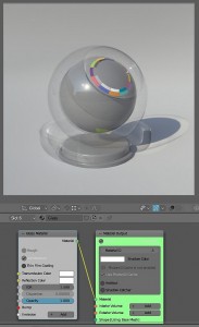

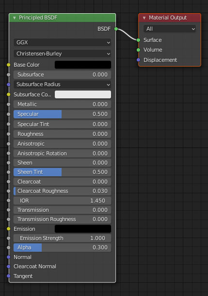

thx, i'll give that a try, but how to make shadow color white for glass? here is my node:

here is the new render with your suggestions about the light settings, altho for the windows I wasn't sure what you meant. It was a cycles material, so I changed it to lux. Just used the glass meterial and used default settings. The image has more noise on the windows and they are darker. Don't think I see any other difference in the images. What were expecting to see different?
Posts: 814
Re: car
check "Architectural" on Glass and under "Advanced" (Material Output) set "Shadow Color"

I was expecting to see more light pass through in the interior of the car, probably the windows in your car have no thickness and that's why it looks weird. When the geometry has no thickness it is better enabling Architectural glass option just like kintuX said and making the material shadow color to white will result in not casting shadows.
Also try putting another light in your scene to make the car appear more clearly and stand out.
