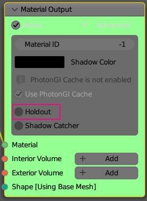

Check "Holdout" on Suzanne's material output, that way you'll only get its shadow.modhob wrote: Thu Aug 31, 2023 9:48 pm ...I simply want the monkey shadow on it's own layer so I can change it's opacity or do whatever else with it.

The only place I see holdout is in the outliner, where you can hide from render etc. There is a holdout there, but I can't seem to select it for anything but a collection. So if I put suzanne in her own collection, I can toggle holdout on that collection. But it doesn't do anything to the render.
Are you talking about the same spot, or a node? Because I can't find holdout in the material output node. Just shadow catcher option.
Re: shadow catcher
Ah, yeah, it's newer than what you've got, a 2.5 addition...
