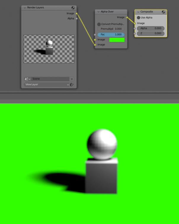

Using "Alpha Over" node works perfectly fine.

Below "Compositor" ('editor') w/ enabled "Nodes" or w/ "Compositing" (Layout), I have "Image editor" open.
You can also simply enable a "backdrop" within "Compositor".
