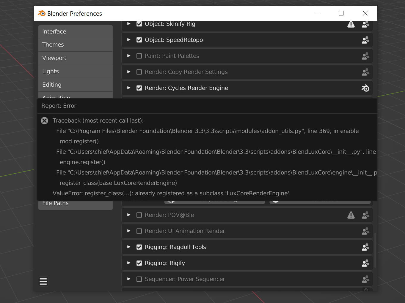

Cant run addon on blender 3.3.1

Re: Cant run addon on blender 3.3.1
Try this steps:S0rda wrote: ↑Fri Dec 02, 2022 3:29 pmThat's what I installed.Odilkhan Yakubov wrote: ↑Sun Nov 27, 2022 11:54 pmHere a link for latest version:
http://forums.luxcorerender.org/viewtopic.php?t=5083
1. Delete "BlendLuxCore" addon from your "C:\Users\<your_PC>\AppData\Roaming\Blender Foundation\Blender\3.3\scripts\addons" if it has this kind of folder.
2. Unpack "BlendLuxCore" zip which is you downloaded from Github.
3. Move "BlendLuxCore" unpacked folder to your "Blender_version\scripts\addons" (not install from zip inside Blender. It gives more errors than copy/paste folders to addons folder).
4. I think it will works correctly.
