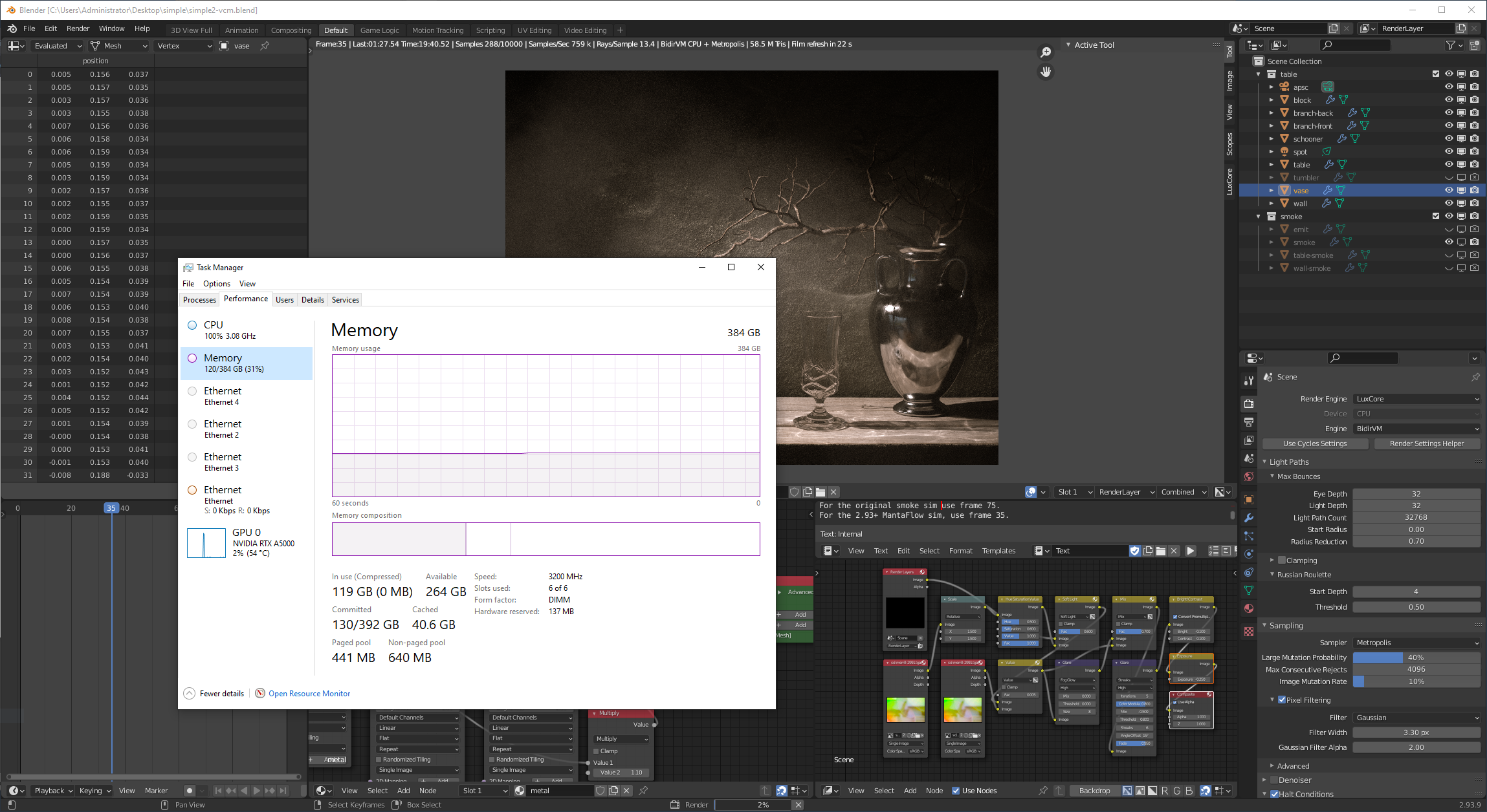

Check out that memory usage!
Each image took an average of 2.5 hours to render on 128 threads at 1920x1536 to 10,000 samples per pixel. Best of luck to all the LuxCore devs in the future :)
