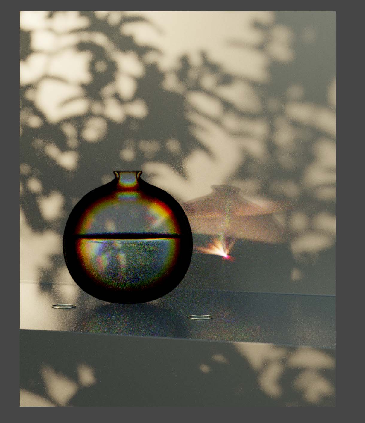

Hello all,
I'm having some problem with glass and water priorities in luxcorerender. Please see the attached image for reference.
I made an "air" volume that is set to priority 5. I set this as the camera volume as well.
The glass of the vessel is set to priority 4.
The water is set to priority 3.
As you can see, the result is not optimal. Does anybody have any idea as to why this might be?
Thank you

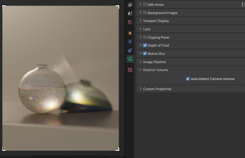

Re: Volume Priorities
You have messed up the volume in the camera.
the water geometry also have inverted normal.
This what happen when I correct both :
