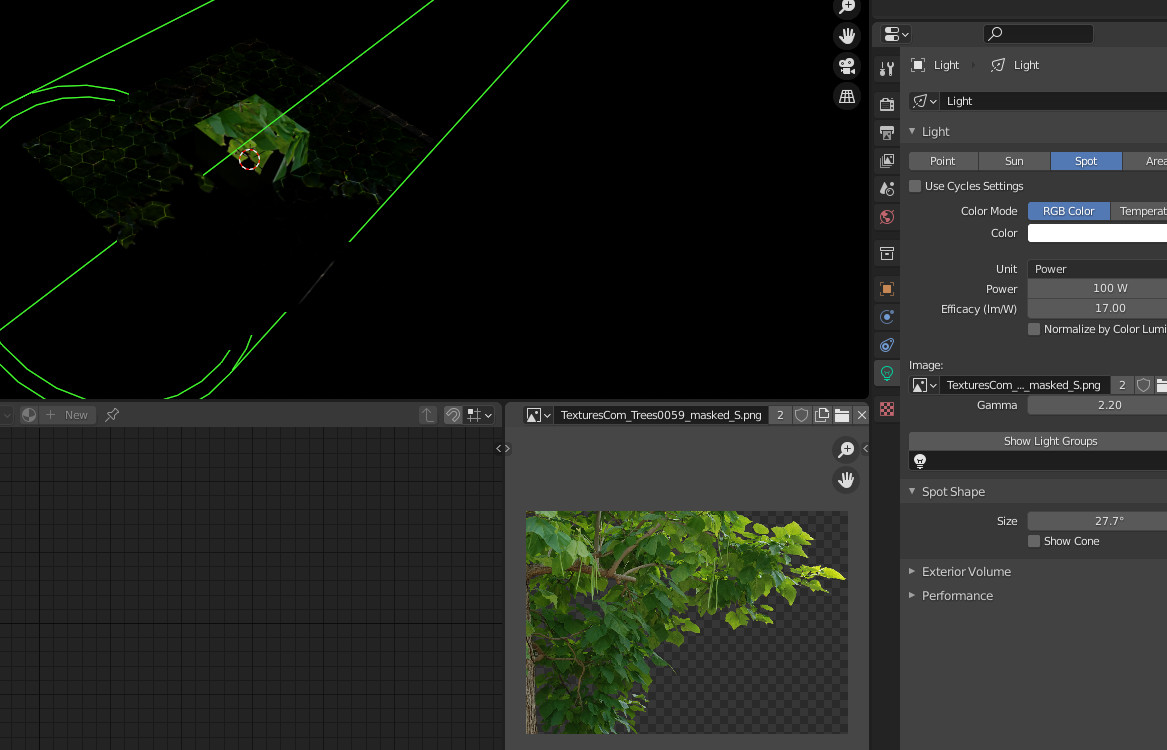

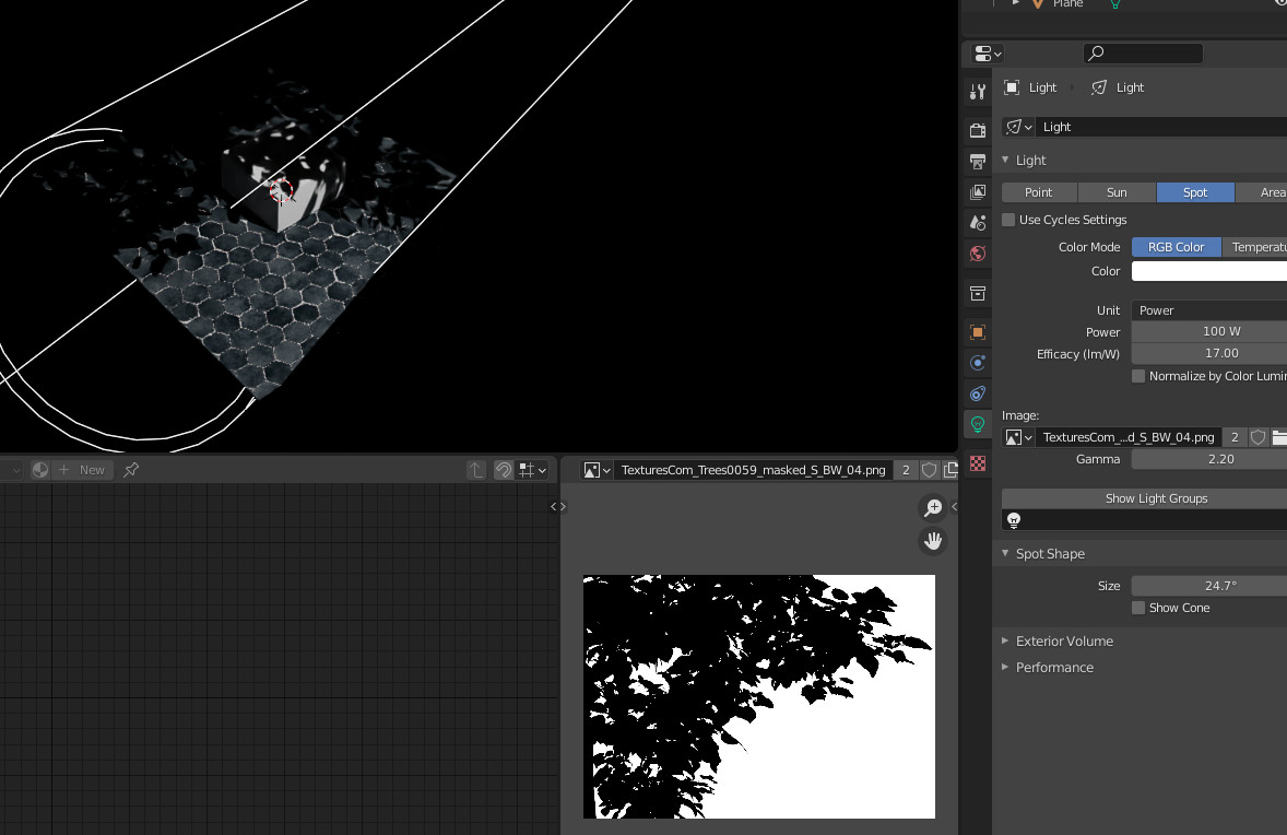

Hi, I try to project black and white image(PNG with alpha) but I get either a little light or no light at all. The RGB image works(PNG w alpha). Do I need edit the BW image somehow? I want to use it to mimic fake shadows from trees, etc.
Blender 2.93.9
Luxcore 2.6 (official)

Anyways, here's an example.
PS.
To make "Gobo" light, exclude alpha and use white background.

I thought it was clear and recreating it is simple and I was in hurry, my bad ;) . It is important to me that you wrote I need to use image with white as background.

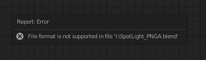

I was unable to open your blend file.

The image with alpha doesn't work neither so what I wrote in 1st post is not true. But I guess that's that in Luxcore all images works on BW if I am not wrong.

File was made w/ B3D 3.3 alpha & BLuxcore 2.6.1 daily
Simply post yours...
