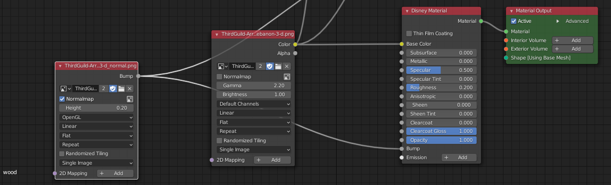

With Disney shader I got this:
disney door shader
disney door shader
I don't understand why it is different in case of glossy shader. Sometimes use of glossy shader is enough but I don't mind use Disney instead. Is there situation when is better use one than the other?

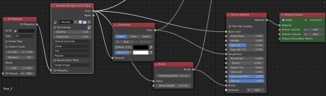

For floor material, do you think it needs some tweaking? I somehow 'feel' more bump and maybe less glossy/roughness.
disney floor shader
disney floor shader
