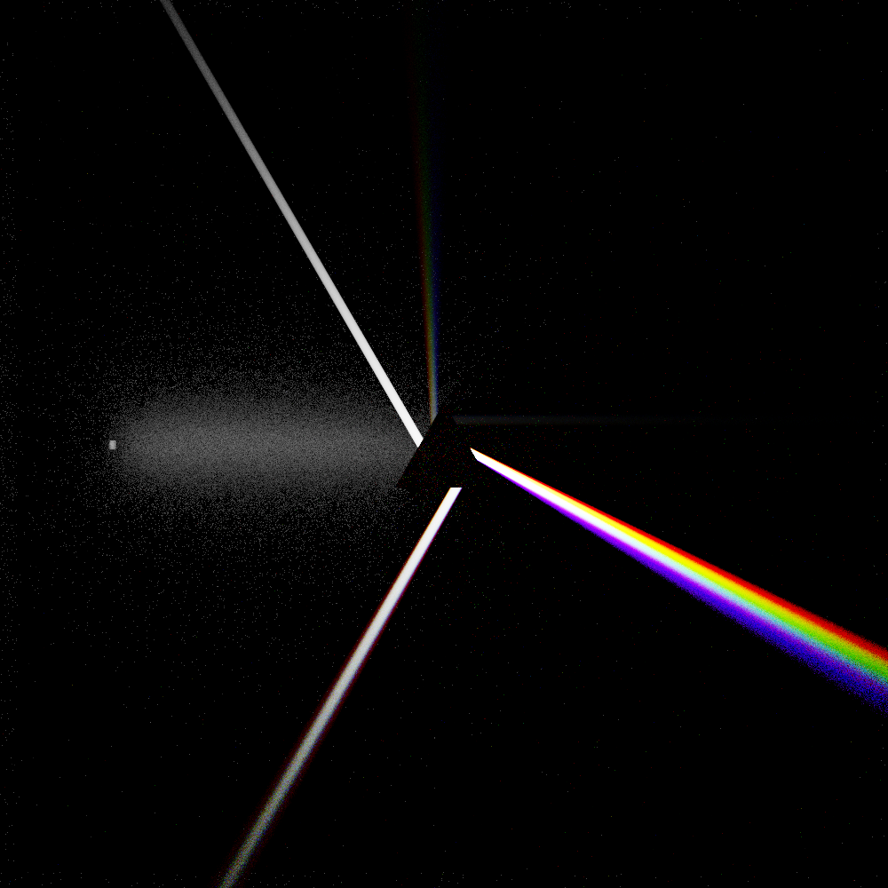

I've been trying to figure out volumes and caustics in LuxCore for the past week or so but nothing seems to work in my case.
I have a scene with a simple prism and a laser: a classic dispersion scene. I have two issues with it though:
  • The reflected light from the glass is much brighter than the light emitted from the laser (to the point where it's always pure white and overexposed). The emitted light is fuzzy and creates a lot of noise while the reflected light is pure and really looks like a laser.
  • The SDS issue where I don't see the light inside the prism. I tried using Bidir, enabling caustics cache, using volumes, not using volumes, but nothing seems to work. The only hack I could come up with is to clip the top face and literally look inside, but it's only that: a hack (not shown on the attached render).
Please help me figure out what I'm doing wrong and teach me the ways of LuxCore.
Thank you!

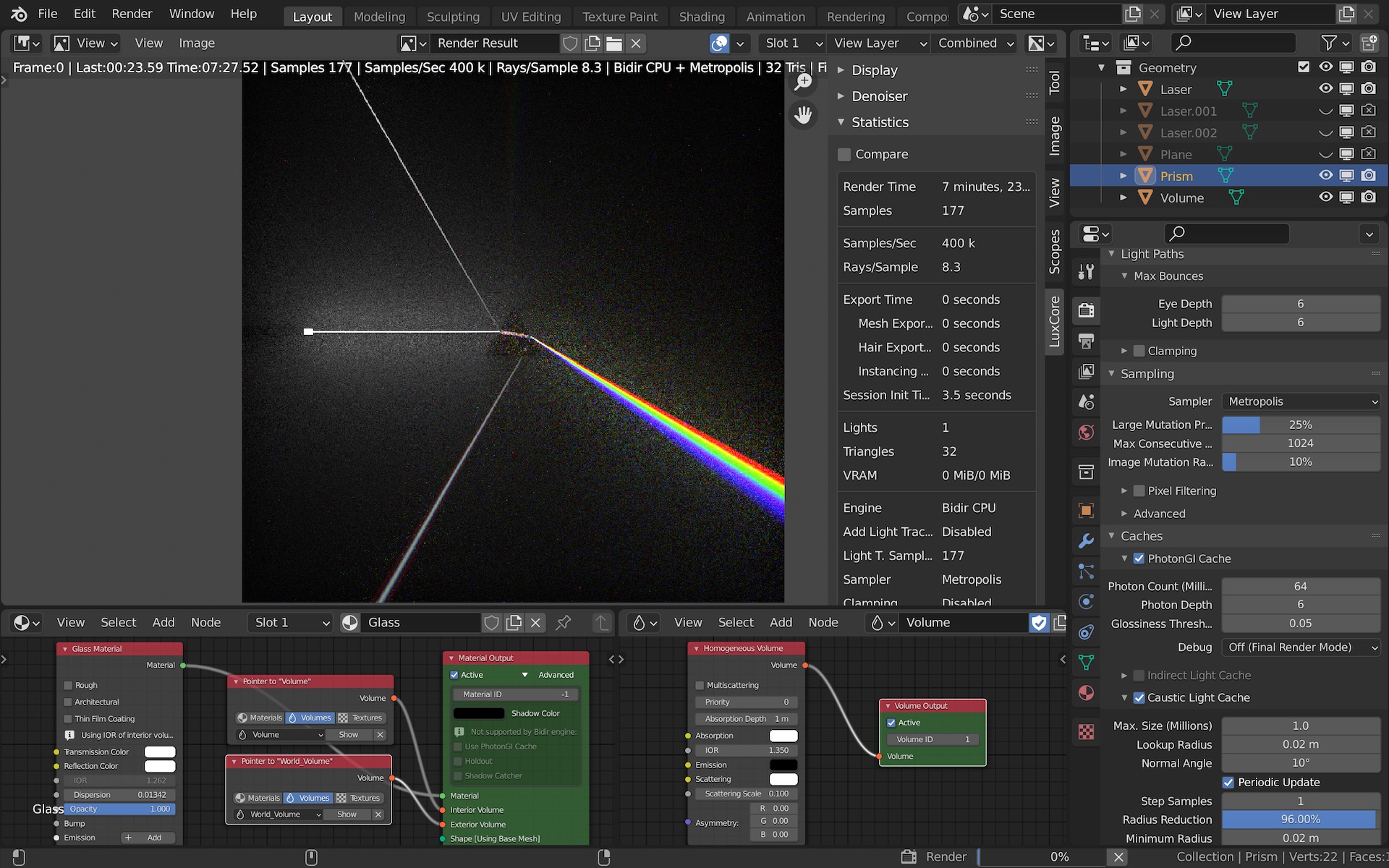

As already mentioned above, a proper volume setup is crucial.
- homogenous volume with scattering and IOR>1 assigned via pointer as interior to the prism
- homogenous volume with scattering and IOR=1 assigned via pointer as exterior to the prism, as interior to the volume cube and also checked for the laser
- choose BiDir engine with metropolis sampling, only fast way to render the primary laser beam
- choose PhotonGI caustic cache for SDS inside glass, setup is tricky because somehow the checkboxes are missing with BiDir engine:
switch to path engine and check PhotonGI cache for the glass volume, uncheck for cube volume, then switch back to BiDir
- SDS is the bottleneck and needs sample step=1 and large values for size and photon count but small values for lookup
- make cube and prism smaller for less volume to calculate, also reduce path depth for slight speedup.
still the whole thing renders slowly...
EDIT: Increasing scattering scale of glass volume to 0.25 speeds up the render, but the higher the scale, the "foggier" the glass.

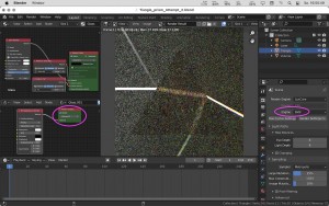

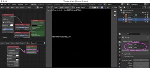

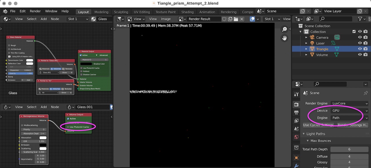

So I tried recreating the scene you attached from scratch and it still doesn't work somehow. There is something I'm missing I'm sure, but I tried everything, it seems, nothing helps.
Also, your post says "check PhotonGI cache for the glass volume, uncheck for cube volume" but it's the other way around in the scene you attached. Anyway, either way doesn't work for me.

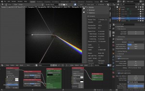

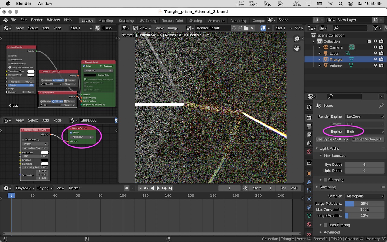

Starjukker wrote: Fri May 13, 2022 5:43 pm So I tried recreating the scene you attached from scratch and it still doesn't work somehow.
In your file the photon cache is not checked for the glass volume.
Somehow you cannot see this with BiDir engine so switch to path engine first.
Now you can see the "use PhotonGI Cache" checkbox in the volume node:

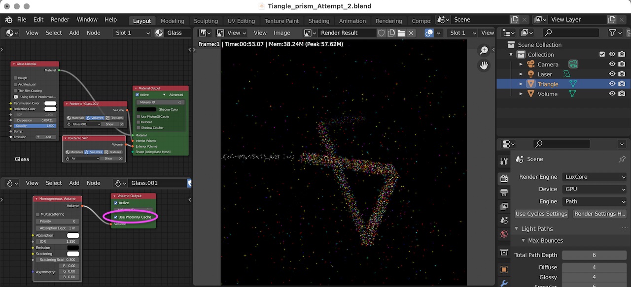

Check that box and the beam inside the glass will appear:
When you switch to BiDir again the setting will stay even without the checkbox displayed:
(scattering scale raised to 0.3 for faster rendering)

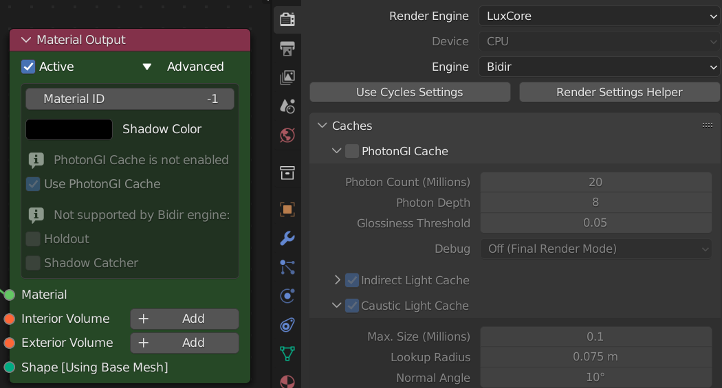

epilectrolytics wrote: Sat May 14, 2022 3:08 pm Now you can see the "use PhotonGI Cache" checkbox in the volume node:
All this time I thought you meant the checkbox in the advanced menu of the material output node, which is greyed out for Bidir. I got it to work now, thanks a lot for your help!
Posts: 818
Re: Prism Caustics
Post by epilectrolytics »
Starjukker wrote: Mon May 16, 2022 6:43 amthe checkbox in the advanced menu of the material output node
This activates cache entries on the material surface, which is independent from volume entries controlled by the checkbox in the volume node.
The invisibility or grayed-out display of those settings in BiDir is a bug IMHO.

The bug:
https://github.com/LuxCoreRender/BlendL ... issues/773
The fix:
https://github.com/LuxCoreRender/BlendLuxCore/pull/774
Now instead, you get a warning telling you to enable PhotonGI Cache if it's not enabled:
And if it is enabled, you can use it!
