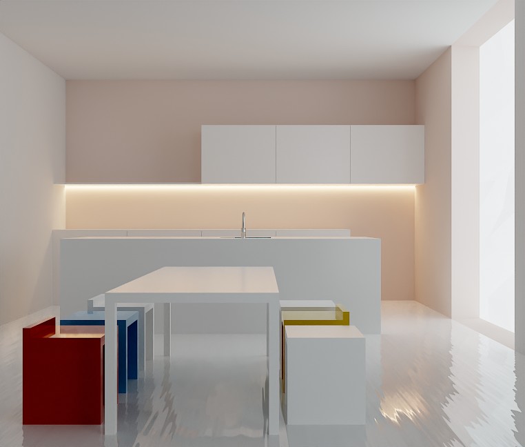

Re: Luxcore To Aces Study
As color still work I just Push a bit to see the difference in color between
Blender Filmic And ACES both on Luxcore render :
ACES Luxcore
Filmic Luxcore
ACES Luxcore
Filmic Luxcore

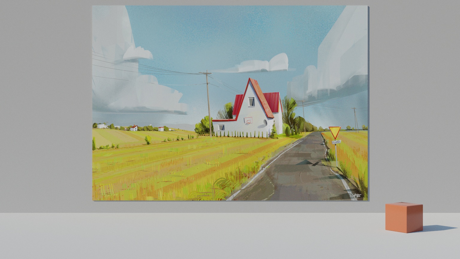

The images were rendered in blender 2.92, cycles and blendluxcore 2.5.
To match the scene results in cycles the house texture is a jpg in utility srgb texture colorspace and the hdr light set to acescg colorspace,
in blendluxcore the house texture is a converted exr with gamma set to 1 in the image node settings.
cycles aces display device, rec.709 view transform
luxcore aces display device, rec.709 view transform
luxcore filmic high contrast look
luxcore filmic medium contrast look
You can use Krita or Affinity photo to achieve the proper color space that is utility srgb texture you choose in cycles.
Aces IMHO looks more natural,and saves more detailsSharlybg wrote: Wed Apr 13, 2022 2:17 pm As color still work I just Push a bit to see the difference in color between
ACES Luxcore
Filmic Luxcore
