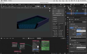

In your file the world background is set to HDRI with no image attached, the white background is blowing out the caustics from the sun.
Once I switch to Sky background the caustics appear:
The lighting system was changed in a previous version, possibly that's why sun + white background works in v2.4 but not v2.6.

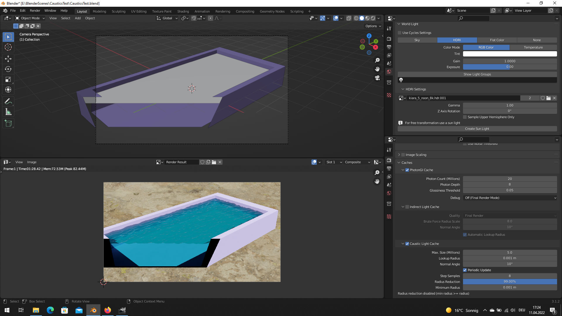

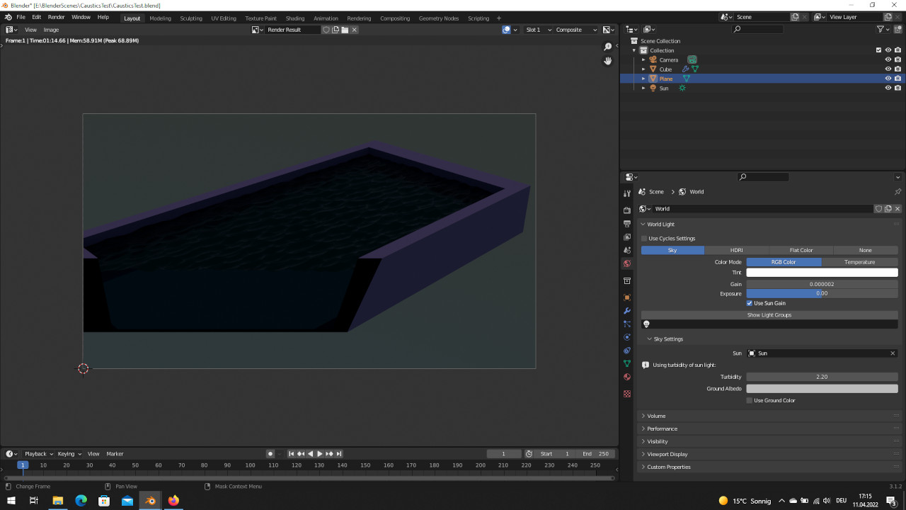

And that´s exactly what doesn´t happen here. With no HDRi image attached there is no white sky, switch back to Sky background still no caustics
(When I zipped the file, I noticed the HDRi is still too big, so removed them)

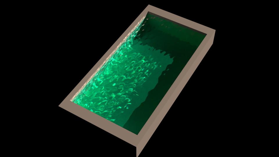

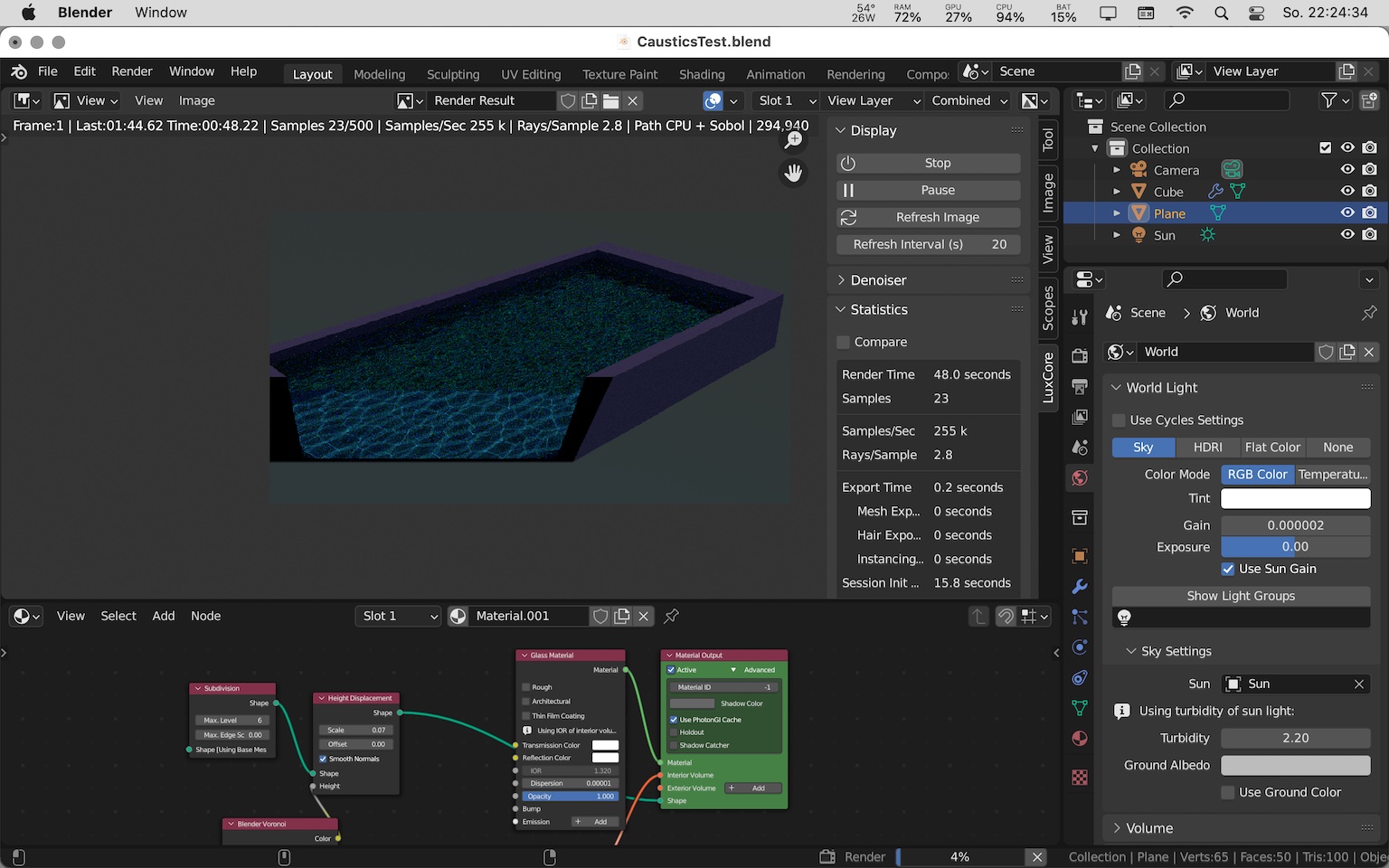

With a proper lighting it work here: https://polyhaven.com/a/veld_fire
Also optimise settings a bit : You can also turn of dispersion for even faster render.
File
CausticsTest.7z
(328.37 KiB) Downloaded 1017 times
Render:

Sharlybg wrote: Mon Apr 11, 2022 4:41 pm With a proper lighting it work here: https://polyhaven.com/a/veld_fire
File
CausticsTest.7z
Render:

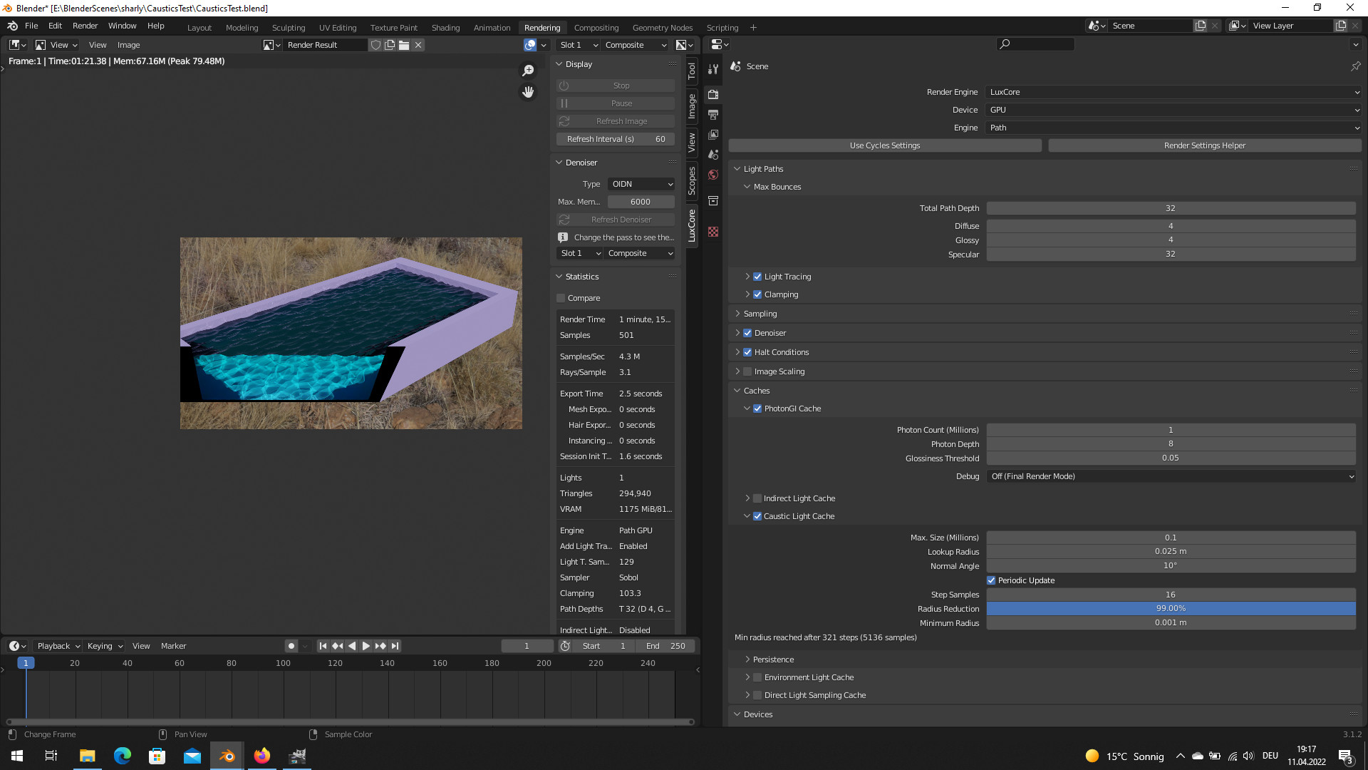

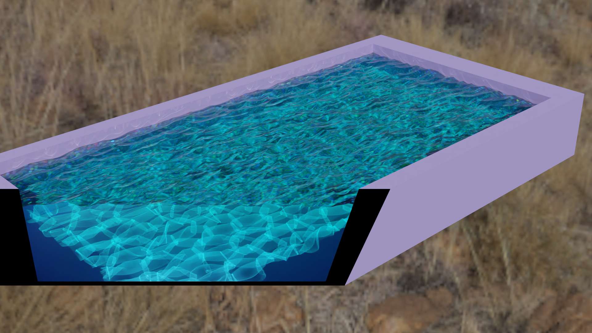

Thanks- that`s what I got with your unchanged file after hitting the render button:

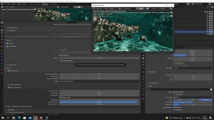

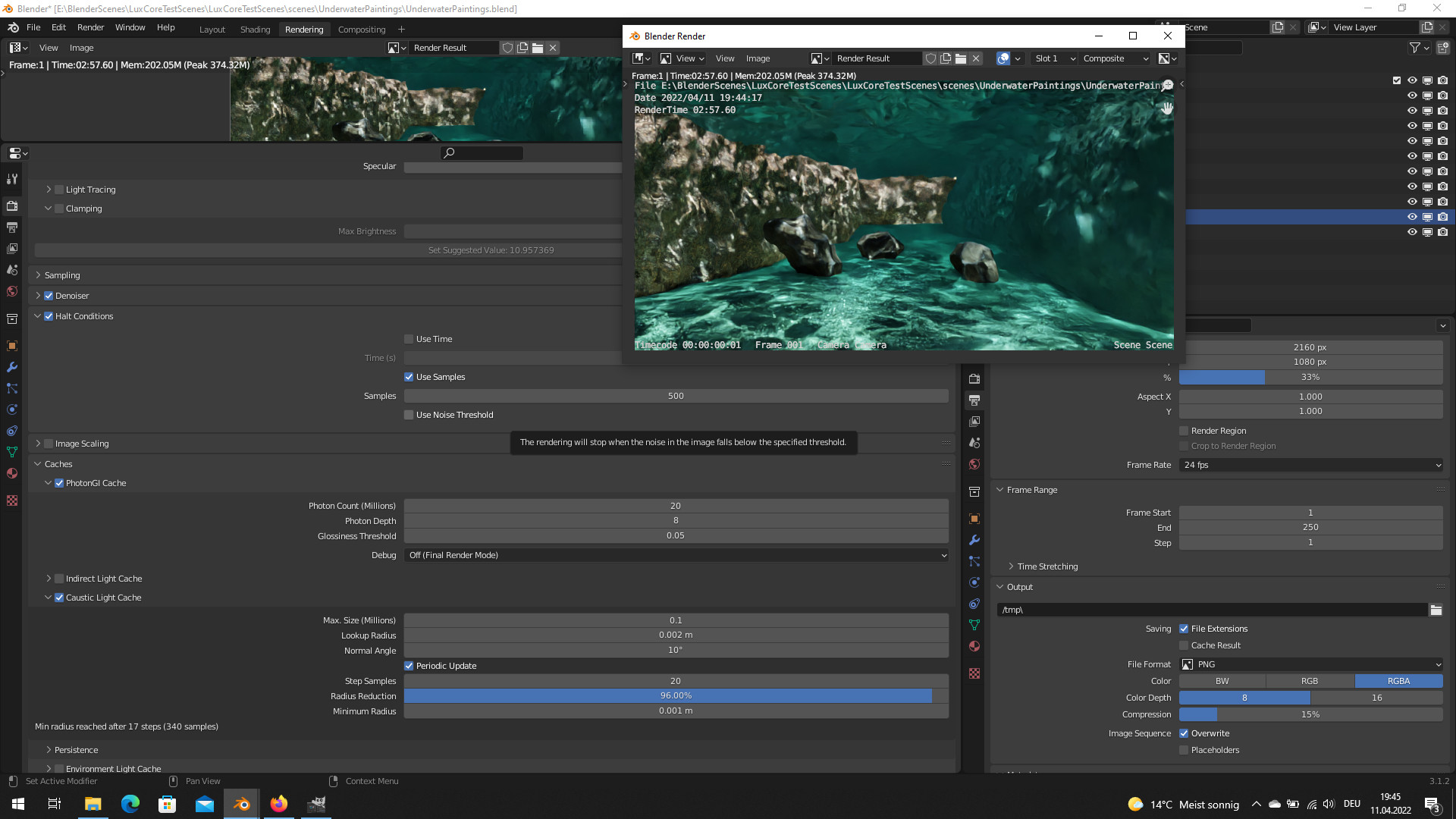

You usually don`t need Light Tracing for caustics under water- here the underwater Paintings Scene from the example files. I removed volume and dispersions for speeding things up, and I used a hdri here- still I get caustics here and visible from above the water
