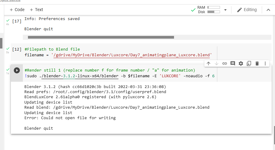

Help me fix this. This is the same case with v3.0

I fixed this I forgot to follow the automatic pack resources and output past now it is rendering, thanks alot.

But the the render result is completely black. Any idea?

Post by MCurto »
It will output whatever and wherever is setup on file, by default is tmp directory, change that to a meanfull directory or keep it relative to file (//). Also change whatever layer passes and file format output you want, save and re upload file to Google Drive.
