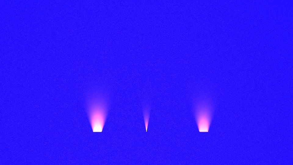

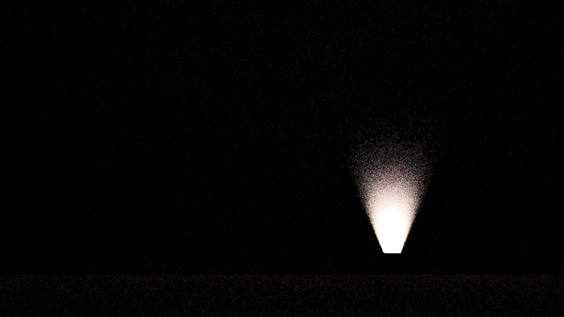

I'm working currently on an underwater scene and discovered some odd behavior of lights in volumes.
The Power of the lights is not as expected. I am not sure if it is some kind of bug or wrong settings.

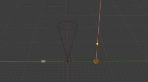

Here is an example scene:
I set world, camera and the volumes on the light sources but the area light seems off.
Both the mesh light and the area light in the example scene have the same size and power.
The scene is rendered with BiDir Engine.

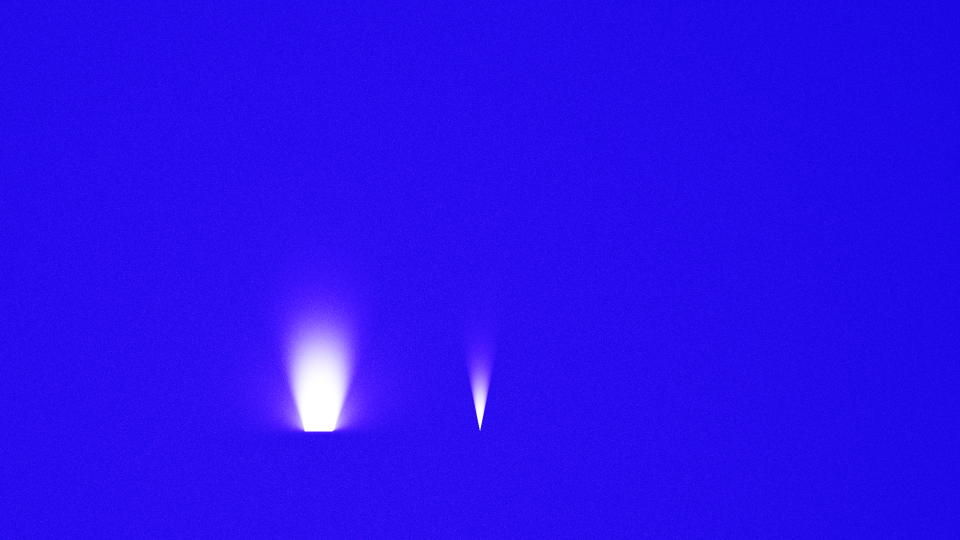

Re: Problem with volume and lights

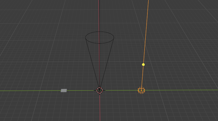

This look like a bug I have tried few things but it saty exactly the same.

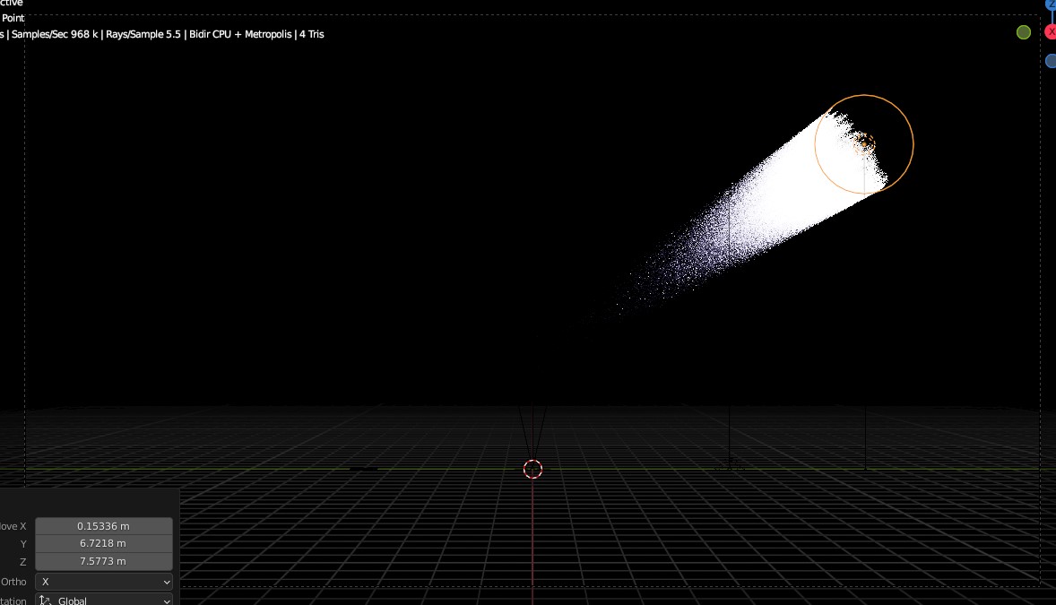

Worse I have even found another strange behaviour:
Adding a point Light source to the scene will make it like a kind of
Black hole absorbing all rays in the scene:

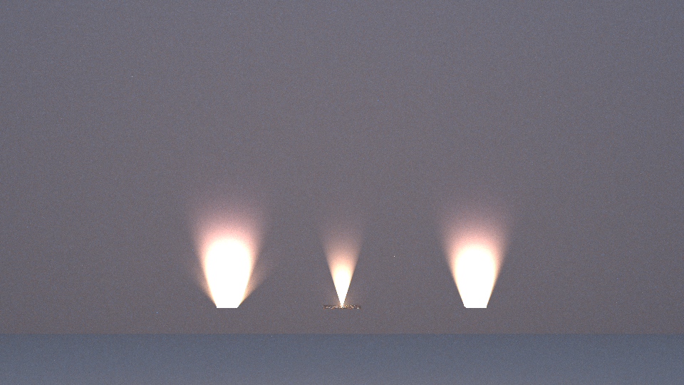

Works fine here.
It's just that your "World needs to know its Volume"
Thanks Kintux, that works great
But I don't understand, why it makes a difference.
The description of the world volume says:
"Default Volume (used on materials without attached volume)"
But i set the volume on the area light. So this should be used instead of the world volume

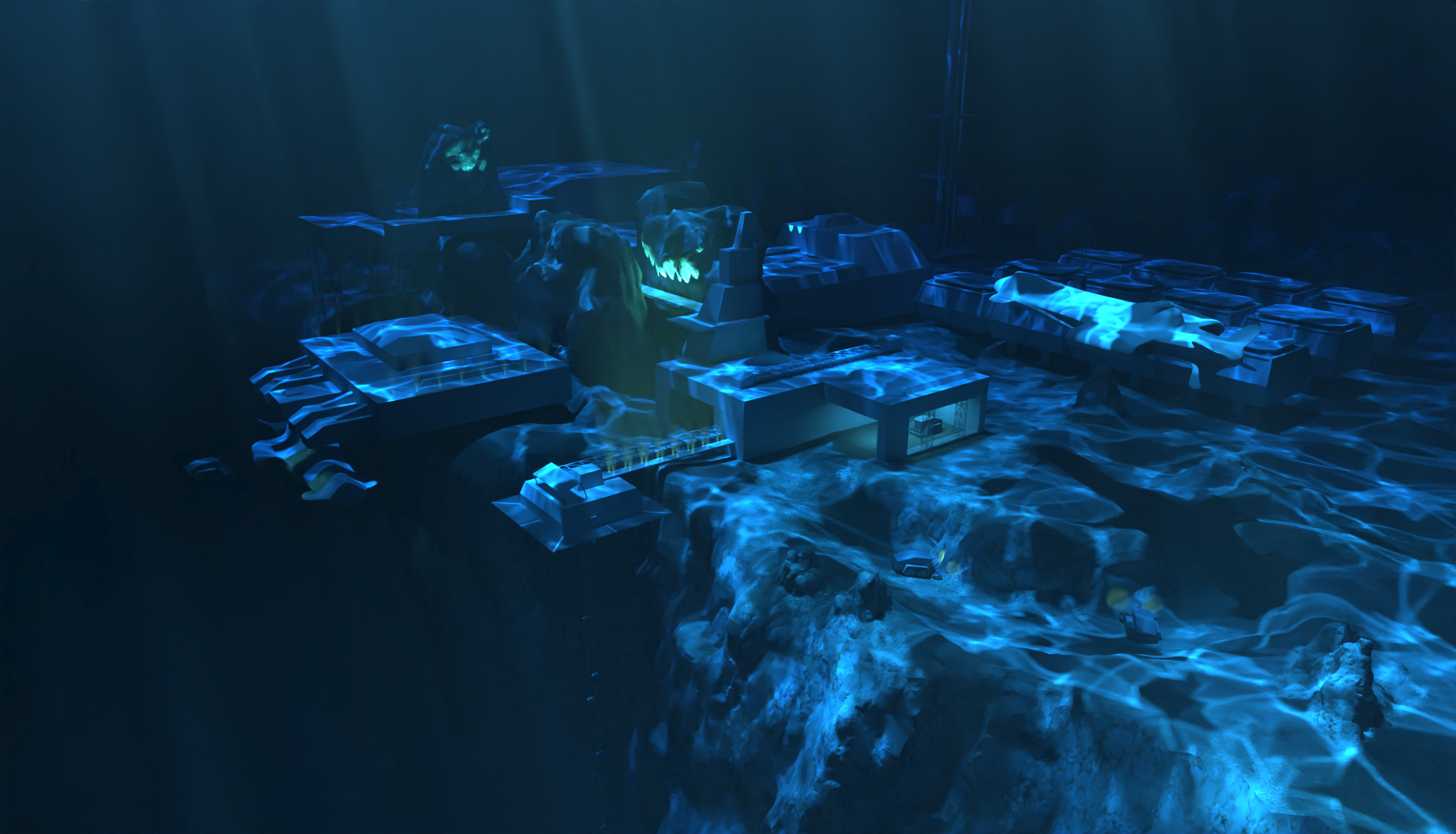

Hi kuntuX, once again thank you for your support
I did some more tests and got results I'm happy with.
It is just a rough layout of the scene with nearly no textures, but the lighting goes in the right direction.
Here is a denoised version of the rendering (low path depth). Any advises how to further improve the setup?
