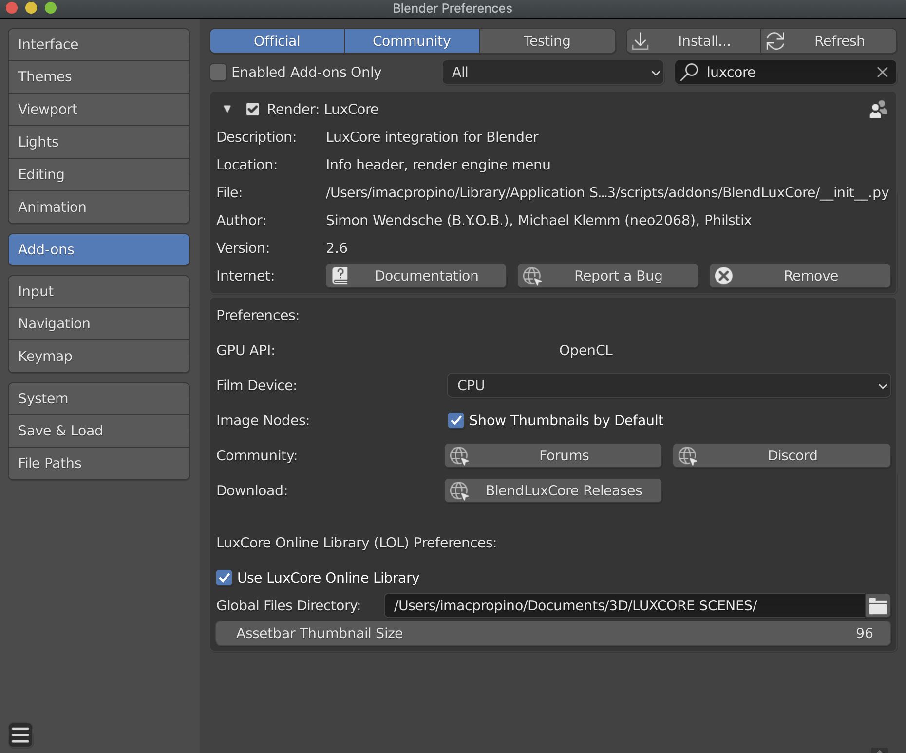

I've noticed, after the software update that the Luxcore Render Plugin preferences switch back to GPU for Film Device.
So, before working on any file after an update (at least MAC users), its good to check out your Luxcore AddOn setup before.
For me, the GPU API read an OPENCL graphic card and referenced in the line below "Film Device".
Turn the Film Device to CPU instead to remove the error message and get back the caustics in your render.
I hope my non programming language may help any Mac user somewhere else.
