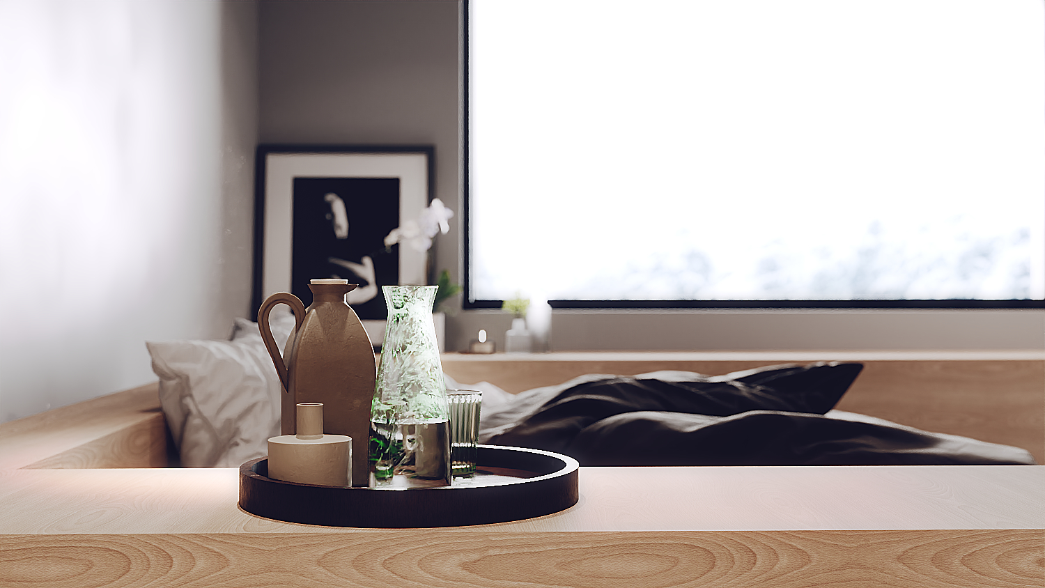

Hey guys, new Luxcore user here. I come from 3DSMax and FStorm, along with Corona Renderer as well. Came to share a cool for fun project to try out Luxcore Render. Had a lot of fun with it and found it has a lot of potential. There may be a good share of mistakes but any feedback is welcome. (There are more shots but there is a max of 10 files only and I've never posted on a forum so pardon me.)

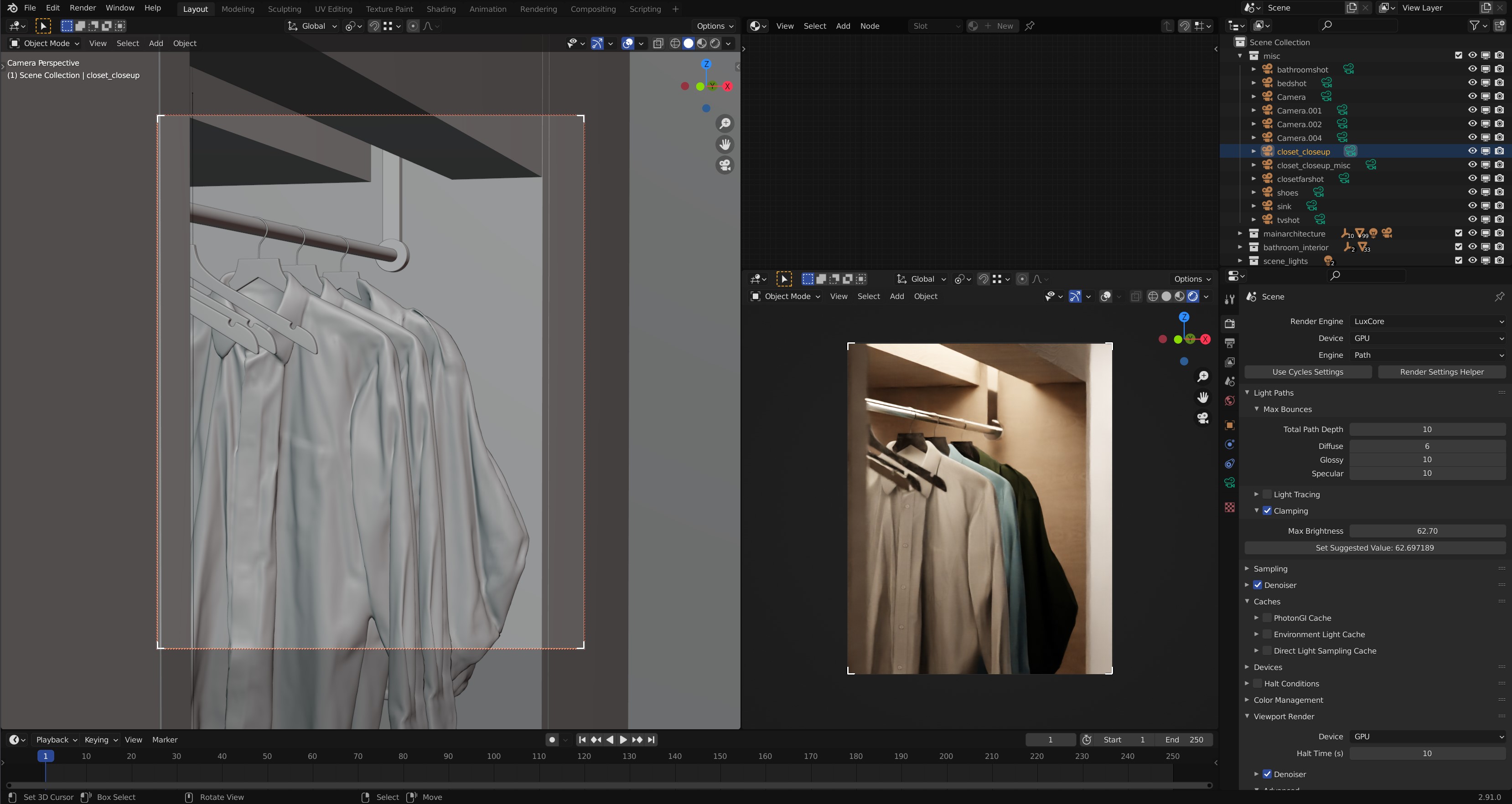

Here are the rest of the images, along with the wireframe for one of the shots.

Hey Charles, really appreciate the feedback. Yes I attached a screenshot above with the settings. Nothing really too fancy. I do believe you are correct. The only time I used any caches were for the images containing the glass objects (PhotoGI). As for the environment, I did not use it due to having an issue with compilation(?) It had stayed on Creating RenderSession (Env.) for a good 40 minutes, so I just force quit Blender and turned it off. I didn't notice too much of a difference when I used the Environment cache for a preview before, but I'm 100% sure I'm probably using it wrong :) . Maybe you guys could point me to the right direction Thanks again!

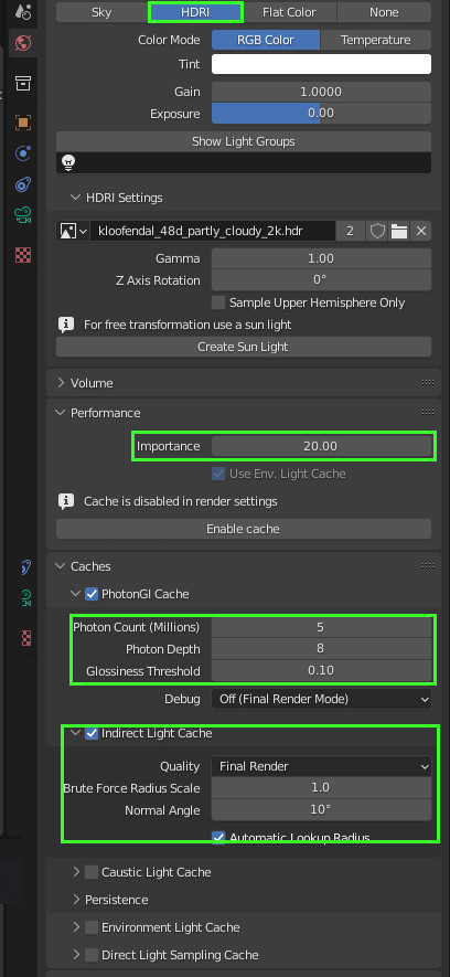

I don't know for the Envcache issue (bug or something else). You can disable Env cache.
But The performance leap you can get in this project with Photon Gi cache Will be huge.
Try to use a higher number for importance value in your Hdri as it is the main light source like in the image below.
And also the photon Gi cache settings here. Just increase the radius scale if you get light leaks. But the lower the
Brute force Radius scale faster the render.

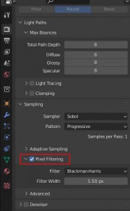

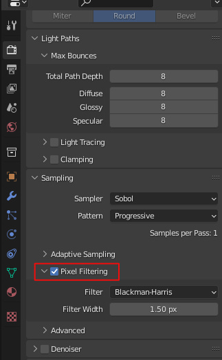

Maybe you want to try enabling pixel filtering in the sampling tab in order to avoid antialiasing issues.

Alright, so I went ahead and applied those settings and noticed a small improvement. I will probably have to dedicate a full day messing with just the settings. Thanks again.
Actually worked on the closeup with the decor. Thank you! :D
