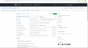

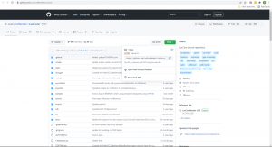

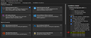

Hello Dade,
Thank you for getting back to me. I have now gone back to the Visual Studio Installer to additionally install the CMake tools as the installation from https://cmake.org/ linked from the ReadMe file was not recognised. I think this counts as progress, however, I am embarrassed to say that information displayed in the x64 Native Tools Command Prompt stating 'Please make sure you've cloned the repositories so that they have the following structure' is not clear to me. Could you kindly clarify this?
For reference, at point 4 in the ReadMe instructions, as shown in the attached images, I followed both links to find the downloads. Possibly my error was here that prompted the above problem, but I am not familiar with these interfaces and would value your guidance.

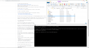

Hello Acasta,
To the best of my understanding, I have followed the guidance in step 5 of the README.txt as shown in the attached image where I have typed the following into the x64 Native Tools Command Prompt for VS 2019:
"C:\Program Files\luxcorerender\WindowsCompile\.\cmake-build-x64.bat"
I do not know what to do next and would be very glad of further assistance.

Re: x64 Native Tools Command Prompt for VS 2019 on Windows 10 Pro
This is not according to that step 5: you have collapsed two separate lines into one and forgot the beginning of the first line.Hugo Macpherson wrote: Fri Feb 11, 2022 11:31 pm "C:\Program Files\luxcorerender\WindowsCompile\.\cmake-build-x64.bat"
The first command should be
cd C:\Program Files\luxcorerender\WindowsCompile
The second
cmake-build-x64.bat

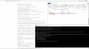

Thank you again for your guidance. I am sorry to report that I have run into another error having followed, to the best of my knowledge, the instructions you provided previously. Please see the attached image. Please also note that the folders in the browser window do not correspond with the information in the x64 Native Tools Command Prompt. I apologise for these rudimentary questions which must be trying for you, but I do hope we can resolve this and would be grateful for your support.
Ok, this is happening because either one of the used programs or our build script cannot properly handle the space in "C:\Program Files".
You can solve this by moving the whole "luxcorerender" folder out of "C:\Program Files" to a different location without spaces in the path name.

Can you please check with Visual Studio Installer that you have at least one Windows 10 SDK installed?
It does not have to be the same that I have, but there should be at least one installed by default, otherwise you are missing something necessary to build programs.
If none is selected, add the latest Windows 10 SDK version in your list.
