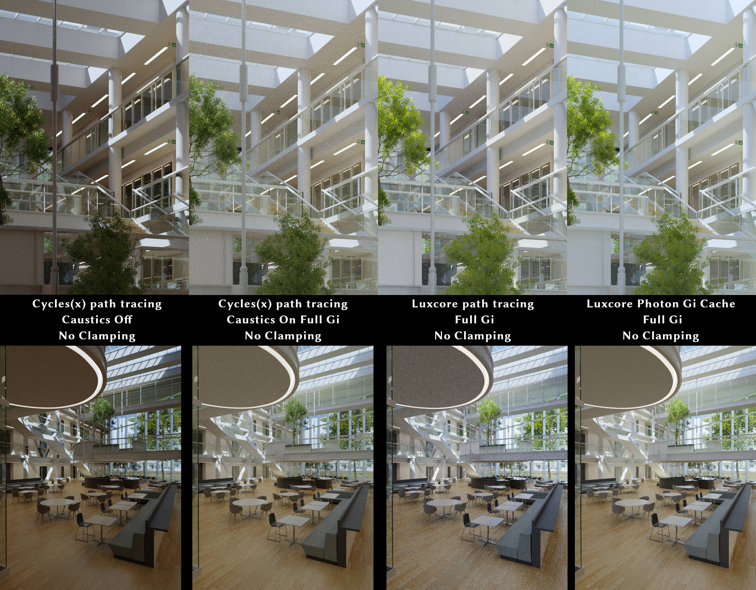

A cropped View comparison of all engines mode

Re: Luxcore vs CyclesX Benchmark
I understand that people like the tools they are using everyday but at some point we need to be serious.
1) What Scrambling distance have to do with Cycles / E-Cycles / Corona in Blenderguru bench
be so down in Gi quality while other render engine correctly compute GI ?
2) Is Scrambling Distance responssible of the Fact that Photon Gi cache wasn't used in luxcore for This Blguru Bench ?
3) It only work on GPU and can cause artefact so doesn't apply To CPU
4) And even with that scrambling enabled if you just follow the explanation it isn't the reason of cycles bad perf here :
Now I have the noise plus the artefact thanks you. And even without the furniture and trees plus displacement geometry.
And this took 26 min with the simplified scene and noisy output.
I have nothing against Cycles and actually use the engine for what it as been buid for.
You just have to accept also that opensource CGI solution can exist also outside of Blender
And it isn't a bad thing. Actually how much opensource production render engine project are still alive
Cycles aside ?
By the way Let see what happen if we manage to make Luxcore 3.0 a reality ?
I don't think anybody here is talking about the quality of LuxCore vs Cycles, the point only is to not do the same mistakes as Blender Guru did and use Cycles X with the correct settings, as other settings may needlessly slow it down. Which in this case, as far as I know, means leaving it in the default settings, in other words having "noise threshold" enabled and not touching the scramble distance at all. So if you left the settings in Cycles in default, I believe your results should be correct.
Exactly the things that people forget in comparison is that quality and speed are quite interconnected.
And why should I enable scrambling if it is giving thoses
Artefact without removing the numerous fireflies.
I think the video was explanatory enought for anyone willing to get the point. The file is also available to anyone interested.
At the end it doesn't change the story.
