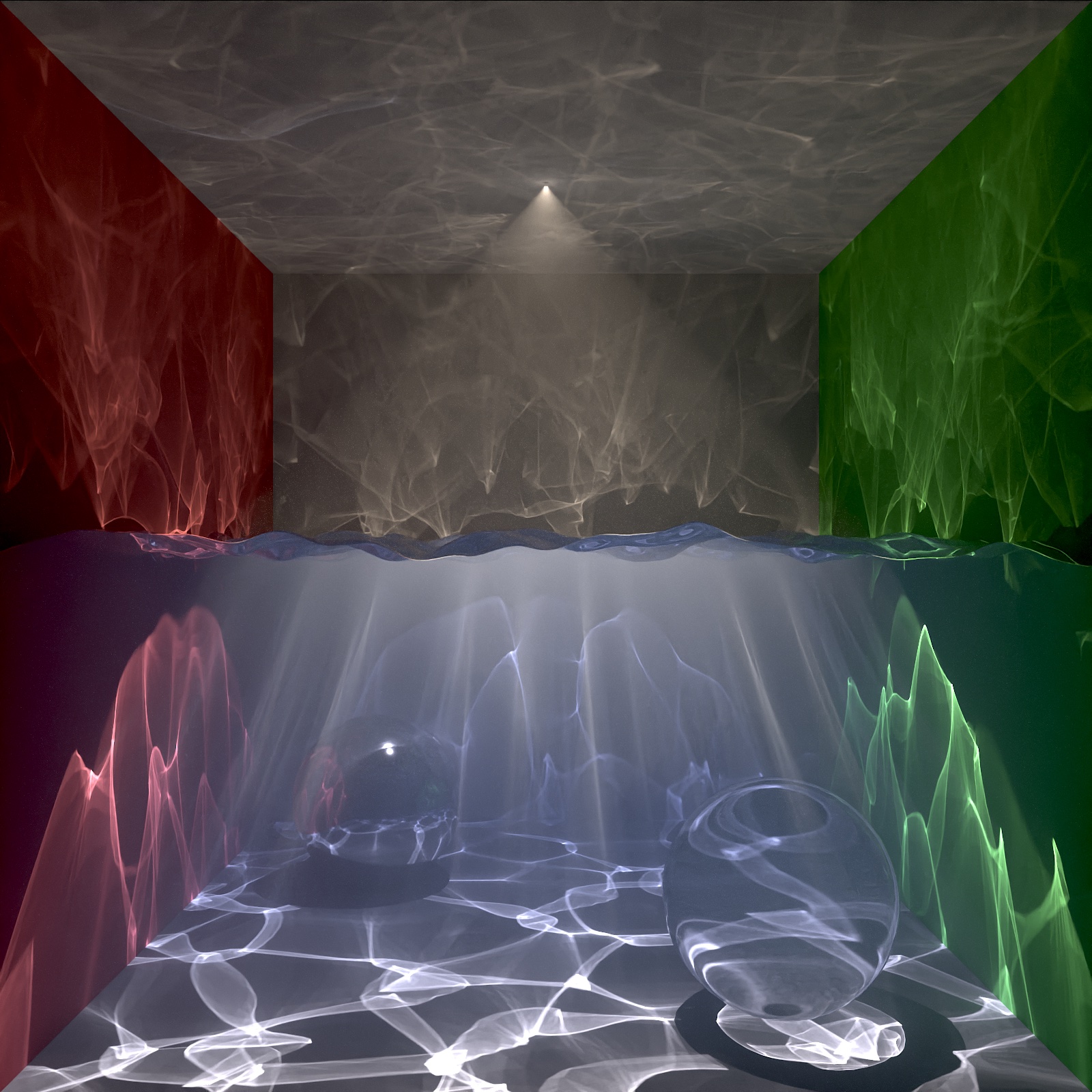

I tried adding a simple "swinging" keyframe to the light, and rendering this myself. And 43 hours later... well it still looks great, but now I have a question
It appears your video is looping and about 4 seconds at 30fps
However the blend file is set to render 240 frames (10 seconds at 24fps), and does not appear to loop.
Frame rate and duration aside - how did you get the waves to loop perfectly?

I rendered only 160 frames (25 hrs) and the blending took away 30 frames or so.
When closely inspecting the frames of the last second you can spot it.
For a perfect looping I should have used two displacement modifiers for the wave plane, animating the same texture with a time shift and fading in the first while fading out the second.
I planned to do that but then the simple transition in the video editor worked well and I didn't modify and rerender the file.
So the title is a bit misleading because the looping is not done in the file, sorry for that.
Also it is no correct render because the volumetrics are not reflected in the mirror ball, that would have required activating caustic cache for the volume, leading to insane render times and a dull appearance so I refrained from it.
It's done in post video editing by fading out the ending while fading in the beginning which shortens the clip a bit.
