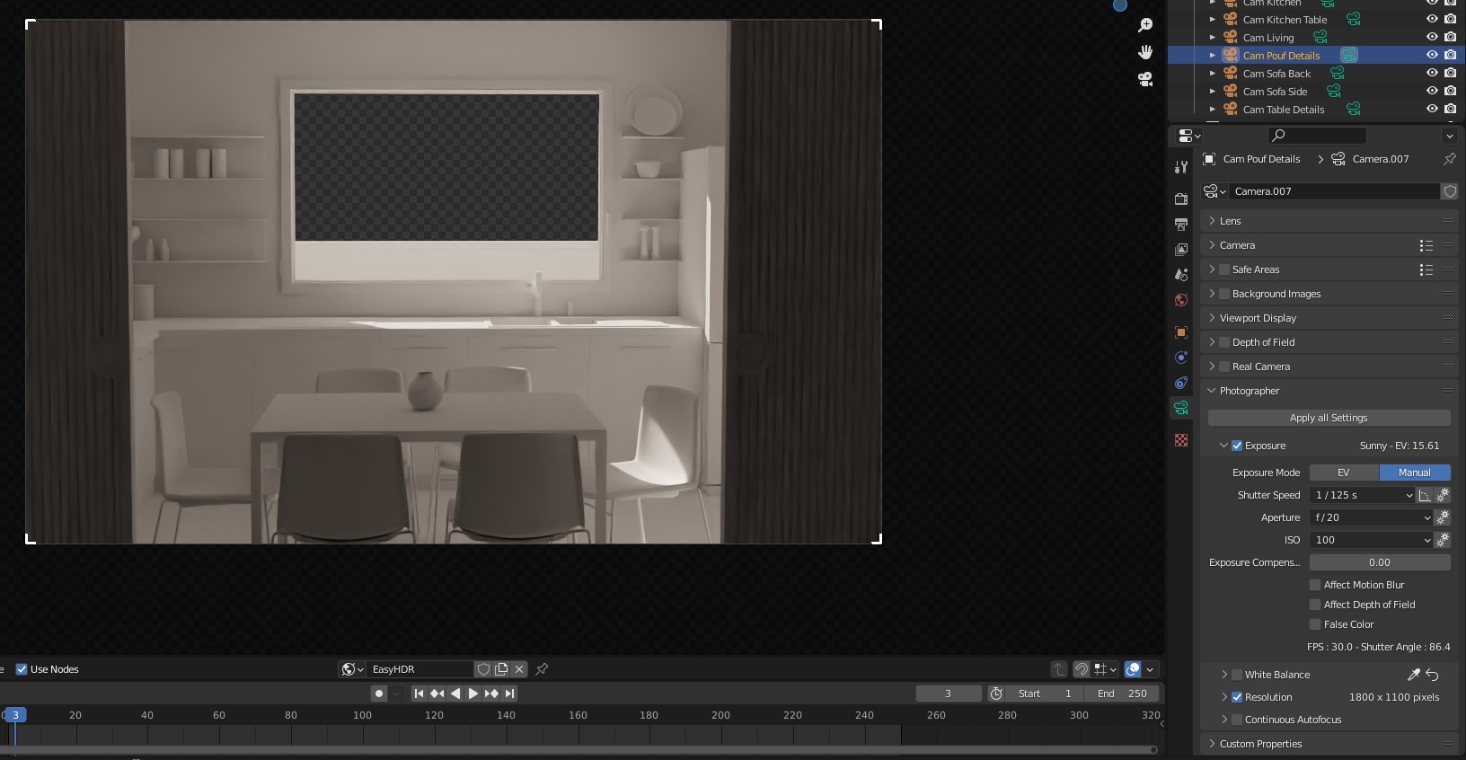

CYCLES:
In Cycles I use an addon to set the camera to a suitable exposure for a sunny day :
This addon changes the exposure in the Color Management tab:
blender exp.jpg (12.33 KiB) Viewed 11706 times

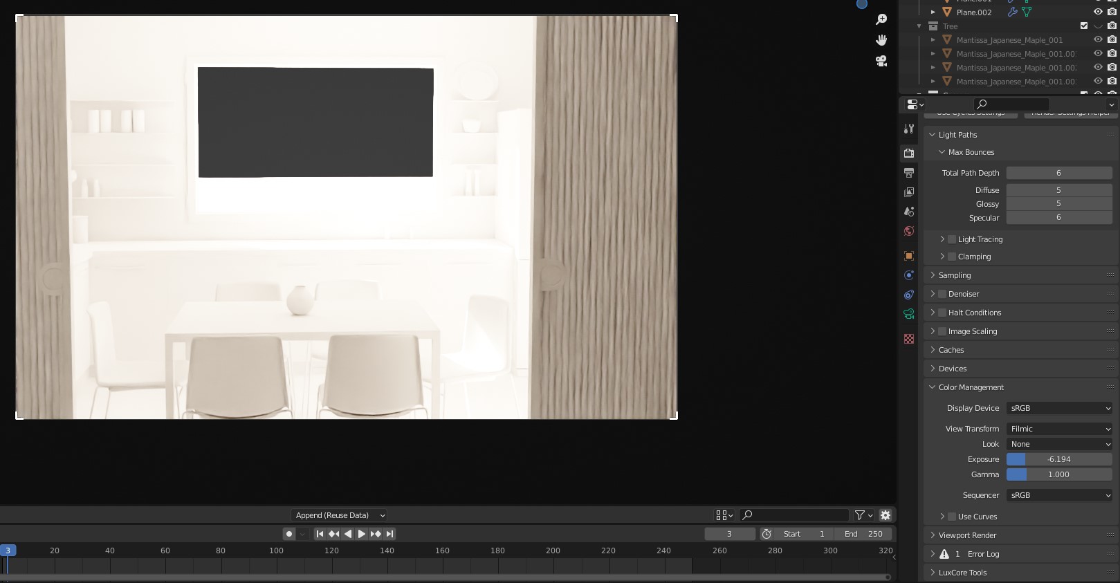

LUXCORE:
If I then try to render this scene with the same exposure setting using Luxcore I get this completely different result:
(apparently Luxcore cannot process this setting correctly, or at least not in the same way cylces does?)

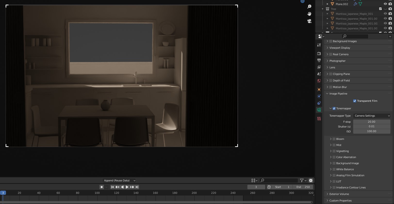

if I then set this exposure in the Color Managment tab back to zero and instead use the Luxcore Camera Tonemapper with the same camera settings for a sunny day, I get this result:
Which is still very different from the result in cycles. Why?
