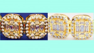

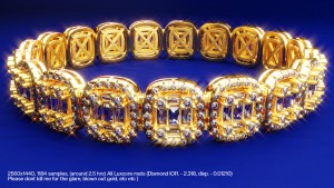

I am new to Luxcore and Blender and was trying to render a couple of ornaments with diamonds in it. I had multiple issues here and there which, after spending around 10-15 days, I was able to solve them. But one this I am not able to solve is internal reflections of diamonds. Online while checking tutorials and renders, I noticed that the diamonds weren't reflecting the ground material at all. They have their own crystal reflections but no ground/floor reflections.
In my case, if I put a blue ground mat, diamonds reflect blue, if i put a white ground mat, they reflect white. I am not able to solve this.
I have attached my scene setup, render settings and render.

I think what you are looking for is to set a world light source to a light blue when using a blue background plane and to white for the white background. Just use a low intensity and it should produce the effect you are looking for.Xplozv wrote: Sat Jan 01, 2022 6:54 pm But one this I am not able to solve is internal reflections of diamonds. Online while checking tutorials and renders, I noticed that the diamonds weren't reflecting the ground material at all. They have their own crystal reflections but no ground/floor reflections.
You may be overestimating the effect of the ground color alone (while the diamonds are reflecting all the environment around them). The ground account for "only" something like 1/6 of the environment reflected by the diamonds.
