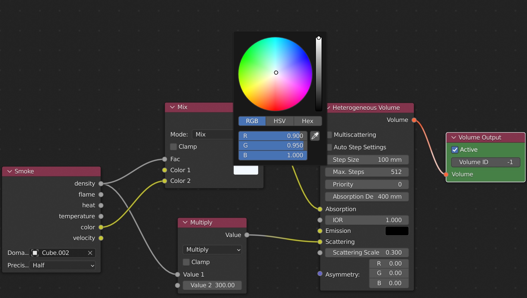

Served to learn a lot and sort a few things: volume auto-step settings (for smoke) was really slowing down the render to a ridiculous point, maybe because I had my scene done 1:1 in mm's and I believe the auto-step was probably getting confused as in Lux wiki it says the settings are suposed to be in meters but don't think there's a way to check what settings Auto is using (is there?) once I set it to manual it increased speed by around 10x.I do have to play more with it as the final render got a bit too blocky for my taste.

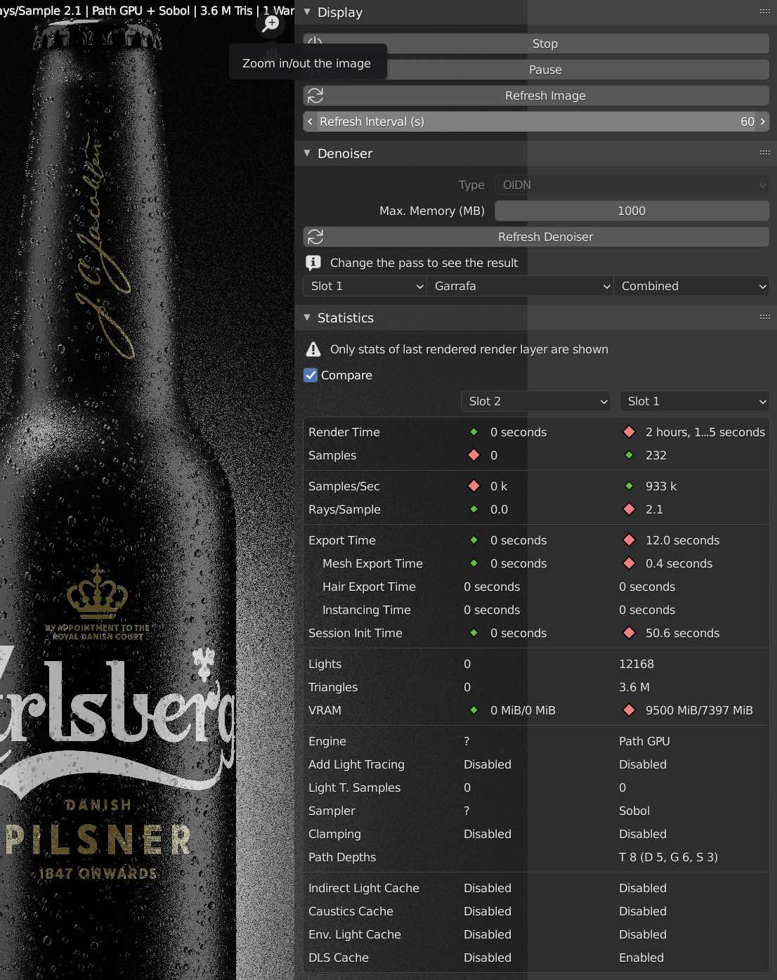

I rendered with and without smoke to mix them latter,Smoke does make a huge memory difference,Was able to render in Colab the non-smoke version:
But no avail with Smoke, couldn't even render with GPU mostly because my Linux boot started working weirdly after a CPU upgrade in my iMac (changed from i5 to i9 9900KF). In Mac and Colab it crashed, so rendered with Path CPU in Mac (a few tries in Linux saw memory usage going to around 70GBs):
Most of the problems I believe were dues to the fact I had the logos as emission to make them more visible, I later split the bottle and logos to be able to render them separately and reduce the quad count (subdivision was sending number of lights trought the roof), maybe there's a better/more elegant way of acomplish this?

Smoke got weird probably because of Step Size,I wanted to have a small cool tint but not very visible will need future tests, but easily corrected in post:
