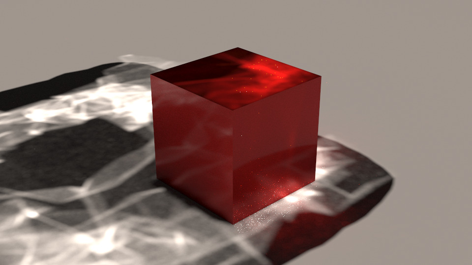

I'm not sure if you are really aware of what you are trying to render: your scene is illuminated only by caustic so it includes only SDS paths. And the light path of including carpaint is a (nearly) all specular path: all specular paths from not intersectable light sources, can not be rendered ... at all. However thanks to the "(nearly)", it can be done.
This is the original test scene:
You have to:
1) disable light tracing (because it is not particular useful here and we need to use caustic cache anyway);
2) the caustic PhotonGI cache glossiness threshold to 0.0 (so car paint is not considered a specular material).
and you get:
As you see, caustic on car paint start to be visible. In order to reduce the "blurriness", you may want also to:
1) set caustic cache photon count from 100000 to 500000
2) set caustic cache lookup radius from 0.075 to 0.05
3) set caustic cache min. radius from 0.075 to 0.02
4) set caustic cache radius reduction from 96% to 99%
and you get:
P.S. I disabled sky2 light source in the test scene so the result is more clear.

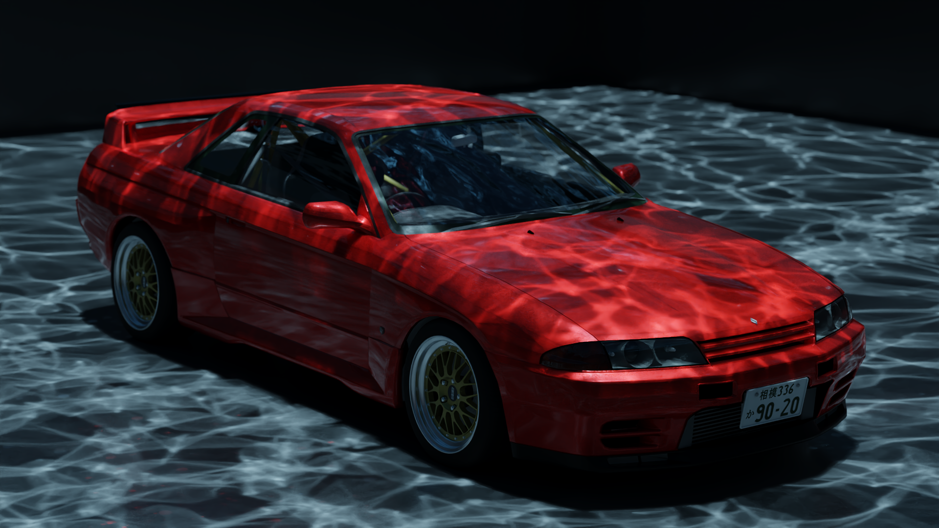

Okay so after tampering a bit with the values, I got something "satisfying", I can definitely do better but it's a great start, thanks again !
Car with caustics
Car with caustics
